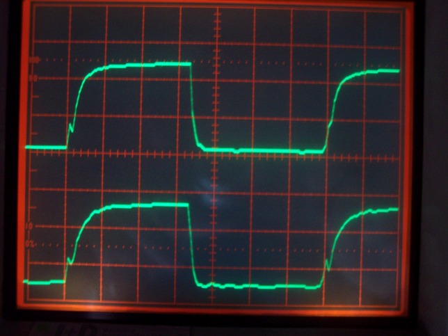

Although I have posted these photos in other thread, here they are. They are the new gate drive waveforms, using 6 ohms instead of 10 ohms.
I think the improvement is hardly noticeable.
In my opinion, the switching should be faster with this driver and the mosfets I am using (150V, 50 mohm, 3200pF máx Cin, 110nC máx gate charge).
I don't know what else can I do without using a buffer to improve rise/fall times, I will try to increase supply from 12v to 15v, and reduce freq. from 285KHz to, say, 230 KHz.
As before, waveforms are not time aligned, and lower trace is HS mosfet.

Perhaps the IR2113 supply is not properly bypassed, because, basing on some numbers, rise and fall times should be in the order of 50ns for that current (2A) and mosfet caracteristics.
Perhaps I am not looking at the proper waveform. Is rise/fall time measured by looking at the Vgs waveform? If I look at the Vds waveform, switching time is about 50ns,that's right. But there is no great current flowing, so in the moment Vgs > Vth the mosfet is fully on, but when higher currents are flowing it won't be the same.
Any help?

Yes it is the slew of the Vds you are attempting to speed up by speeding up the gate charging. In the period of that little blip you see on the gate signal just at the start of the rise, Vds switches in it's entirety. So you can bet it's switching fast! Drive beyond that point goes to ensure lowest possible RdsOn. This I believe is why speeding that up will aide further, but as stated already, it's all about finding that sweet spot, basically as fast as it can without becoming destructive due to the body diode.
Now, why wouldnt' the slew of the switching be the same with higher current?

Are these the gate voltages, right ?
The gate-voltage has in fact some indications on how a mosfet switches. But the actual output switching waveform and the gate input waveform are definitely NOT the same.
There are some good app notes on the switching behaviour of mosfets on the IR homepage.
The actual transition of the output voltage takes place where the input voltage shows this little step during its rise. This is where the driver has to "fight" against the miller effect of the gate-drain capacitance.
And yes: Proper bypassing of mosfet drivers is paramount.
And the mosfet you are using isn't an impossible load to drive, but an easy one it is neither.

Wow! Your response time is faster than my mosfets' ! ;-)
Well, in that case, judging by the glitches in the gates, the switching time is about 50-60ns. I will measure it again with a faster timescale, however.
I measured the driver supply voltage and it is quite clean, some spikes of about 0.5V at the transition moments, but nothing more.
Then I can consider the case almost closed. As a conclusion, we could put a couple of formulas to help calculating the switching and conduction losses:

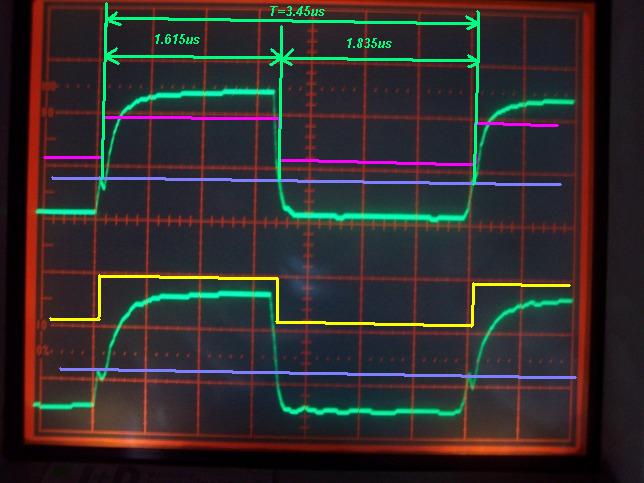

I am trying to calculate the actual dead-time basing on the gate waveforms. Let's see if I am doing this correctly:
Looking at one of the waveforms, for example HS (bottom trace):
I consider that the mosfets goes to ON just when there is a little peak in Vgs (entering in the Miller zone). This happens at about 3.5V (Vth). I consider also that the mosfet goes OFF when the falling edge crosses this level (Vth) again.
The period of the waveform is then T=3.45us (289.9KHz). The off time measures 1.835us, while T/2 should be 3.45/2=1.725uS.
So the dead-time is the excess of time that the mosfet is off, that is, 1.835us - 1.725us=110ns.
So I suppose I can go to a lower dead-time, say, 60ns safely, and this should reduce THD + N further.
BTW: I suppose that dead-time is also reducing the maximum modulation index: in this case, it is 6% of the period, so I can go up to 93% modulation. This explains why I only get 75Vpp while using +/-40V rails (measured at that load)! It was strange to me as Rds(on) should produce about 0.5V drop only.
In the figure I have drawn the timing I am considering.
Am I doing something bad?
Thanks!
hm, I suppose you did this with a grounded input and expected a perfect 50% duty cycle right?
What about the other factors that come into play though? Component delays, offset voltages etc. Assuming there should be a perfect 50% duty is a big leap to get your dead time from.
I think the only real way to get a working estimate of dead time is to measure the gate signals with respect to one another, and even that is hardly exact.
I also don't think it's possible to get such a tight dead time, it wouldn't take into account things like temperature variations, Vth is temp dependant.
The best you could do is use some sort of adaptive delay, and even that isn't ideal.

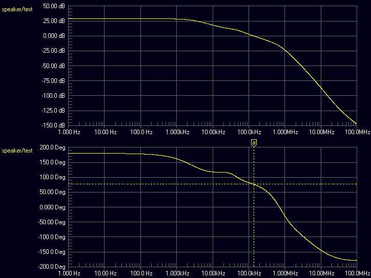

Yesterday I discovered a nasty problem with my feedback.
All had been going (surprisingly) perfect with my test loads. BUT as soon as I connected a speaker (yes, I couldn't help doing that ;-), the amp started to oscillate heavily.
The oscillation measures 71KHz, about 60Vpp and happens only with my speaker (a cheap 3-way bass reflex). If I connect a resistive load in parallel (say, 5 ohms), everything starts ok.
If I use only a 10 ohm power resistor, everything is ok too.
Then I believe the amp is oscillating due to the non-resistive impedance of the speaker. So I put hands into simulation again, modelled the speaker as 8 ohm in series with 1milliH, and was happy to found that with the same component values I can reproduce that oscillation quite accurately (although I change the speaker's inductance the freq. is the same).
I tested the phase margin and found that, in fact, it was going negative so everything matches. I had changed the resistor in series with the integrator capacitor to 1k, and that was a mistake: if I put 10K, the simulations go perfect and the phase margin, with that load, becomes about 33 deg.
The feedback components are:
- 10k series NFB resistor
- 68k || 68 pF comp. network
- 330pF + 1k (now 10k) integrator, in parallel with 150kohm
- 2k input resistor
Although I am almost sure that the change will improve things in reality too, I am now worried about when can I be sure that the amp will be stable for any speaker out there, what conditions should I meet and what a proper model should I use for my simulations of the speaker.

I have managed to put it to work with a speaker.
My simulation model has helped me a lot, as I have been able to measure phase margin and it was 0 or negative with the 1K resistor in series with the integrator cap as soon as the load became not purely resistive. As soon as I have increased it to 10K it is fine now.
The sound is fantastic and it starts reliably.
BUT (there is always a but :-( ), I have noticed that, with my 5 ohm test power resistor, there appear some oscillation (about 4vpp) superimposed to the signal when it is about to reach clipping.
The square wave response is fantastic, fast but no overshoot.
This phenomena has been more or less present during all my tests, and I don't know what it is due to.
I cannot reproduce that in the simulations, indeed the phase margin shown in it with this load is about 76 degs. Can you figure out what it is the cause?
This is the open loop response:
