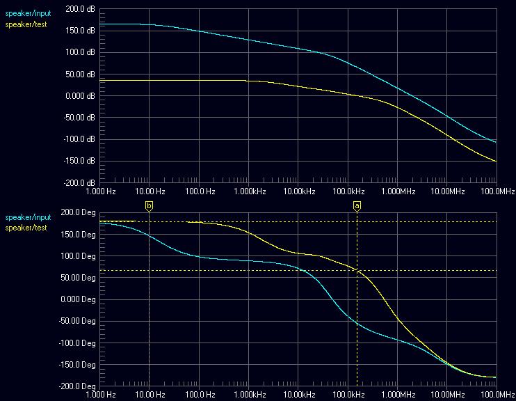

The set-up as it is in the drawing is open-loop. Note that I use a pulse generator (that behaves like a AC source for freq. domain analysis) as the input to the FB network, while attaching the input to GND. This way I can see both the freq. response (AC analysis) and the transient (ringing, etc) with a single source.

Well: that's the open loop simulation with the following values:
Series fb resistor: 4.7k
Comp. network: 68k || 56pF
Integrator: 220k || (10k+330pF)
With this setup, the feedback -3dB bandwidth is 2K, and phase margin is about 60 degs. However, I can get a wider feedback bandwidth (althogh less open loop gain) by reducing 220k to, say, 100k and 330pF to, say, 100pF.
Closing the loop, seems right, at least as before.
Charles, do you agree with Kenshin in that the series resistor can help reducing EMI in the integrator and that this can be the cause? Seems sensible, isn't it? (you don't seem to be pleased with the idea...)

A bit more info: The difference in open loop response with 10k series resistor vs. without it is:
0dB point: 140KHz (10k resistor) vs. 176KHz (no resistor).
Phase margin: 58.6º vs. 77º
Response at 275KHz: -8dB vs. -3.6dB
So the only benefit is a <5dB attenuation more at the sw. frequency, will that be really noticeable?

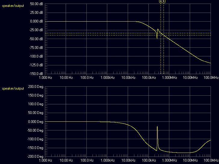

Well, simulation done!
I see a big problem in that configuration: the filter shows a notch at the calculated frequency, BUT followed by a peak in its response in a very short frequency displacement, so you can move from a very good situation to a very bad one if the clock frequency moves a little bit, or if the tolerances of the clock or notch components vary sligthly.
Do you think that only the resistor in series with the zero is enough to make it work well?
This is what I get for the filter (only the filter) response with the notch filter proposed by Pabo (approx. values)
