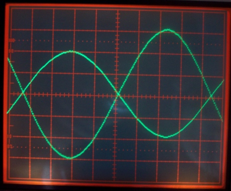

Regarding your pictures I see two things (or do at least think so):
1.) there seems to be a small load-dependancy of the effect as the last output waveform is a little cleaner than the one with 2.65 Ohms load.
2.) even the input signal doesn't look totally clean.
To 1: This might be due to a ground-loop problem, i.e.differential feedback would help in this case. How does your ground look BTW, is it a ground-plane ? Or it could also be due to the changeing properties due to the different output filter damping. Maybe it would be beneficial to increase the phase-marging, I will do some brainstorming on this.
To 2: What is your signal source ? How does the sinusoidal look like if the amp isn't running and nothing else than the scope is connected to the source ?

My source isn't definitively too good. It is a function generator I built at least 8 years ago, based on a ICL8038, so you can imagine! I will post some photos of the waveform with the generator and oscilloscope alone for you to see it, but I am sure that its THD is no better than 0.1%.
Now that things are better I will try to use my work's generator, a much better HP, or at least a PC with a good soundcard.
Yes, there is a little dependency on the load, but have in mind that we are comparing 170W versus 1.36W!
I will try also your suggestion about increasing the resistor from 47k to 150k.

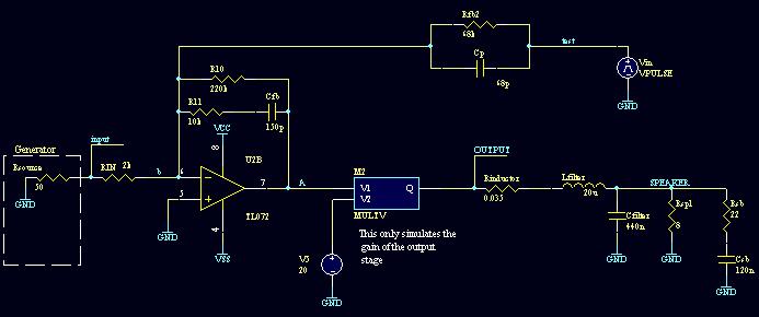

When I simulate the circuit open loop (disconnect the feedback takeoff from the output, input to gnd, and test signal at the feedback takeoff), we spoke about measuring the phase marging by measuring the phase when the gain of that is 0dB, right?
And what about the -3dB bandwidth? Shouldn't it be the whole 20KHz audio band?
With the values Charles suggested me, the open loop transfer function has a DC gain of about 22dB, and a -3dB point at about 8KHz. Is that enough?
If I increased the integrator parallel resistor from 47k and lower the integrator cap, I can get 36dB of gain with -3dB at about 5.5KHz.
For example, the image shows what I get with 10k+150p || 220k in the integrator, and 68k || 68p as feedback network. (22uH+440nF LC filter). Is this any better (theoretically)?
This is a question of taste. Some people prefer more NFB and a lower -3dB point of the open-loop gain. You can achieve this by incresing the parallel resistor of the integrator and leaving everything else untouched.
But now you have a unity-gain frequency of more than 1 MHz ! => Edit: I misinterpreted your diagram, forget about this statement !

BTW: All my simulations results are from a linear model of the amp, with no switching at all. I think I have said so before, but just in case we are leading to some confusion or the model is not suitable by principle. Kershin, is that what you propose?
I understand what Charles says about having constant NFB gain or higher at low frequencies. It is a matter of testing which of them gives better results.
See my sim. model in the attached figure.
