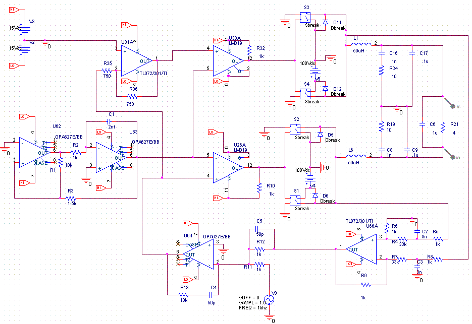

It's probably better to take the feedback before the output fiter in a carrier type. In my simulations the phase shift of the output filter puts some nasty artifacts on the output waveform and also allows any switching risidule into the error amp so it spends it time correcting that aswell as the audio.
I got better results with a RC filter taken before the filter. I managed to obtain a 0.02% THD at 1kHz @ 1v in the simulation using this (I was using balanced modulators aswell... atleast I think thats what its called). This was done using the TL072 as my difference amp and error amp.
If you want to see the schematic just ask.
Good luck
Matt

This artifacts are a general problem in carrier-based class-d amps. They can indeed be exagerated by after-filter feedback-takeoff. Thats why I asked Pierre if everything else was working nicely in the first place.
Yes please !
Did you also build it ? Keep in mind that you can have differences between simulations and real-life. In a simulation people usally use linear inductors, what they definitely aren't in real life.
I had better sonic results when playing around with post-filter feedback.
An alternative would be a mixed solution with pre- and post- filter NFB.

Keep in mind the 0.02% THD was using a 10u cap accross the output and using ideal components. Having 10u accross the output attenuates signals above about 5k I think, lowering it to 1u gave it a wider response at the cost of THD. Right now it measures at 0.047% at 1v and 0.1% at full swing (1.9v input). swithcing frequency is about 190kHz.
I recently changed the error amp to an OPA627, I had it spare so it saves buying a TL071.
I havn't built it yet :(
National rejected my sample request for its half bridge driver so I'll have to get a different one from farnell *shudder*
I hope it helps
Matt
