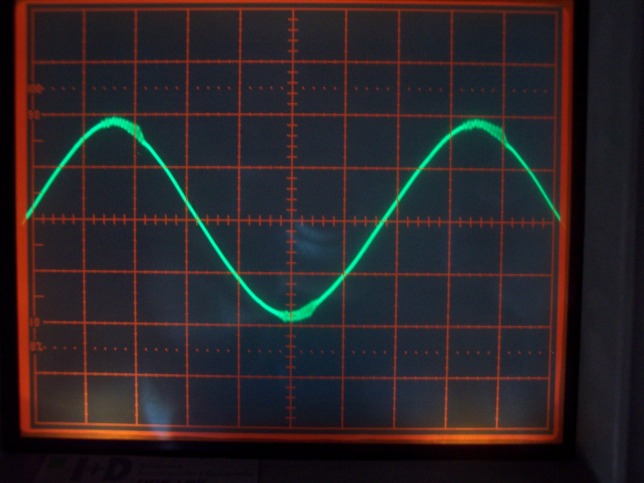

I have 20uH and 440nf, then a 22ohm+120n Zobel network.
I suspect that, if the problem was a too small phase margin, it wouldn't work with my speaker, perhaps. And what's more, it only appears when the output is near clipping. Another thing that is strange to me is that the transient (square wave) response is perfect with the same load that I get that ringing. Mmmmm

Sw. freq is about 285KHz.
I have reduced the 150k to 47k back again and I have noticed that the amplitude at which the oscillation starts to appear is higher. Before was about 28Vp, now is about 36Vp.
The ringing freq. is very difficult to measure, although one of the times I have catched it, the freq. was about 140KHz (casuality?)
This is a photo (20V/div) of what occurs.
BTW: I have tried the no-load situations, and it doesn't start (goes to the negative rail). Loaded with 2.2k it goes to about -10Vdc and starts good as soon as I inject some signal.
With 1uF as the load, it doesn't start either. If I put 5 ohms in parallel with 1uH, it is fine.

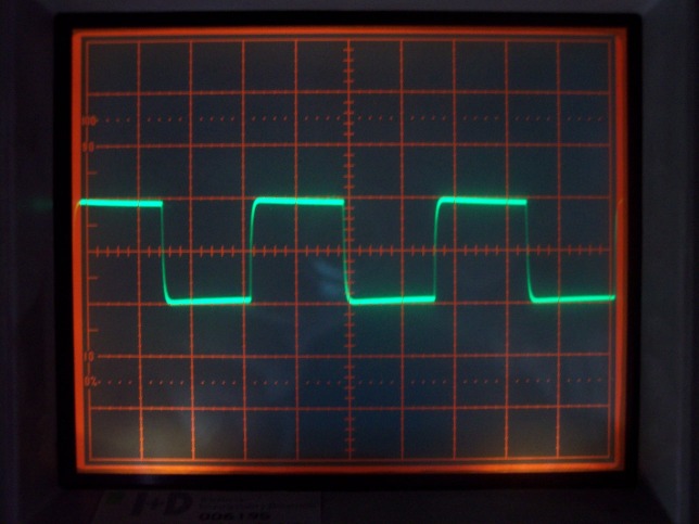

And this is the square wave response in the same situation (20V/div), 1 KHz square wave.
The resistor across the integrator is 47K in both cases (with 150K the oscillation in the sine wave started with a smaller amplitude)

The sticking to the rail is most probably not caused by the unity-gain point. I don't have an idea what might cause it at the moment.
The 1/2 f-carrier unity-gain point comes from the fact that a class-d amp is a discrete-time system and therefore the Nyqvist theorem should be taken care of (or one can get instability).

I know what you refer to, classd4sure. My comparator is not extremely fast, but the effect you talk about is seen with more amplitude and in a more erratical way just at the peaks, I have seen it. It is produced when the duty-cycle is required to be near 0% or near 100% as the pulses are so thin that they sometimes disappear.
This is ringing, not false triggering of the comparator. The proof is that it also appears with a square wave of enough amplitude: the top and bottom have oscillation but you can continue turning the amplitude up.
I am getting more and more convinced that it is a problem of estability, although the square wave response is very good.

As I etched two boards I have built the second one, and it shows the same problems as the other (it has ringing with big signals), but it is even more prone to oscillation than the first board.
So I am starting to think that my phase margin is smaller than what my simulation show and that any parasitic can make it conditionally estable or even unestable.
A question for Charles: what happens if the 0dB point of the open loop freq. response is located at a higher frequency than fsw/2? I know that's not good due to undersampling (violation of Nyquist theorem), but I want to know if that can make it oscillate.
The amp runs fine up to, say, 40Vpp with sine wave, above that, the oscillations are big. The square wave response is also good, until a certain amplitude where the oscillations are sustained (not damped).

There could indeed some instability arise if your unity-gain point is higher than the Nyqvist frequency. This is what the written theory says (the reason why I never even tried to go over it in proctice though I should maybe try once) and also what simulations showed.
In order to get more phase marging one has to add more phase-lead in the forward path. This could either be done by adding a lead filter (i.e. using an additional op-amp) or by a modification to the ffedback network of the integrator. I would recommend the latter but you would have to use a fast op-amp.
