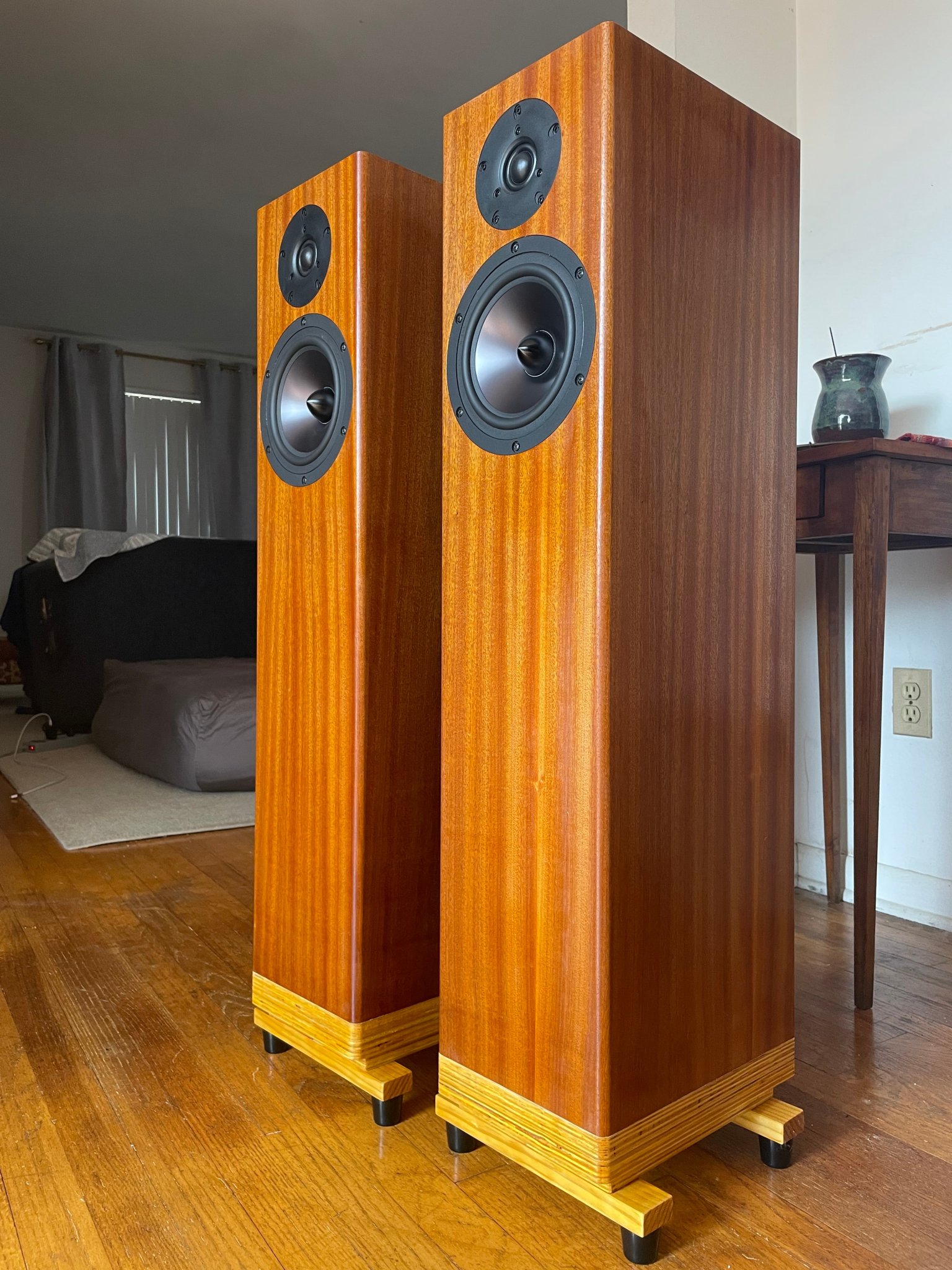

Were you using MiniDSP + something-something for the 3-way and passive with the Amiga?
Yeah, just 5.1 outs from motherboard into amps, xover done on PC. Amiga is passive, it's just the kit. I actually won a little contest at PE for my Amiga's. First thing I ever veneered, first DIY speaker. They have a lot of sentimental value.
My active 3 way is honestly a hassle and I'm always scared the 3.5mm plugs will just slide out, they have once and sent loud buss into the mids. I feel like DIY active 3 way is not friendly to my income. I'd like to make a passive xover but my attempts have been poor and it seems like the speaker has other issues. I'd argue my complaints aren't so much for imaging, I can hear where things are, but the sound stage feels flat, not much depth to it. The Amigas comparatively have a wide stage that floats about in the air, in the song Kenotaph by Ben Lukas Boysen I feel like I can hear where he is hitting the snare in 3d space, there is left and right as well as front to back.

Your Amiga's looks gorgeous ( and your three ways are not bad looking either).

I just have some polyfill in the mid, and the walls are lined with some sort of thing yoga mat stuff. I did have a bmr tebm46 tossed on some cardboard mounted in there and honestly thought that sounded better than the dc130. I thought about having friend 3dprint a waveguide/flare for that mid but that's another can of worms. Perhaps this mid is not the best, idk.

I'd love to quit this project, but I keep hoping it can be good.
Here is impedance of all drivers. I'm going to try and get some good outside measurements of the driver tomorrow. Other than that not really sure what course to take. I have them in another room so maybe that can help rule out if there's a bad resonance. Curiously the OSMC impedance plot for the woofer looks a lot worse than mine. These are from the cabinet with new braces, pretty much no change from before on this measurement it seems.
If it was me, I'd rebuild the cabs. Copy OSMC aluminum corner brackets + bracing and damping plans. Consider two shorter front ports like Harbeth and Spendor + center align the drivers or rear port like OSMC. Work on passive crossover with people here 😀

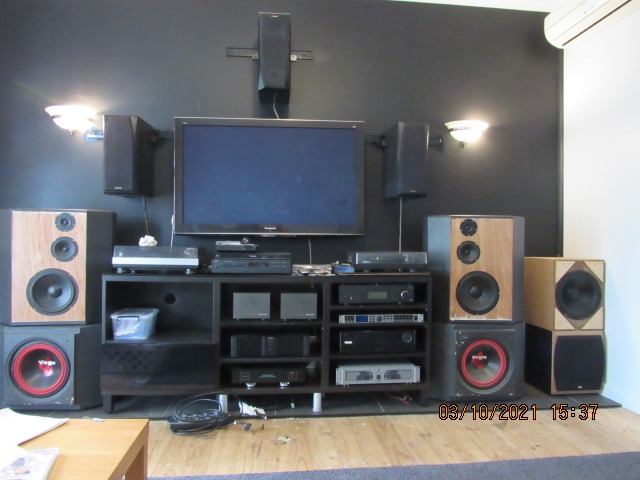

Most of us don't have good listening spaces [ in my case it's WAF and conflicts with "decor"] so the room does seem to be the defining factor in how speakers sound.
My loungeroom system has wide baffles and imaging is good at the sweet spot and lucky for us the sweet spot is reasonably wide
