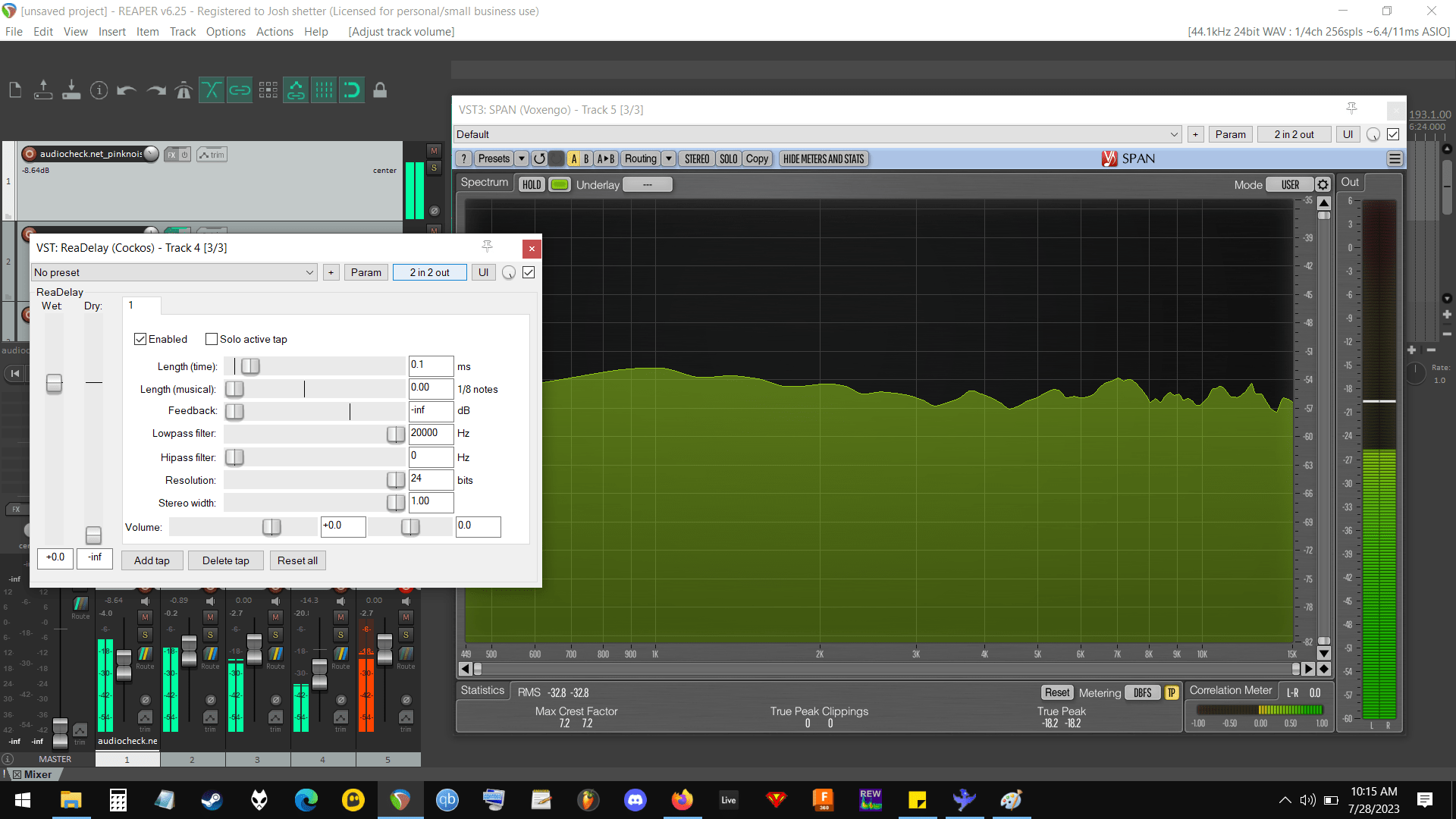

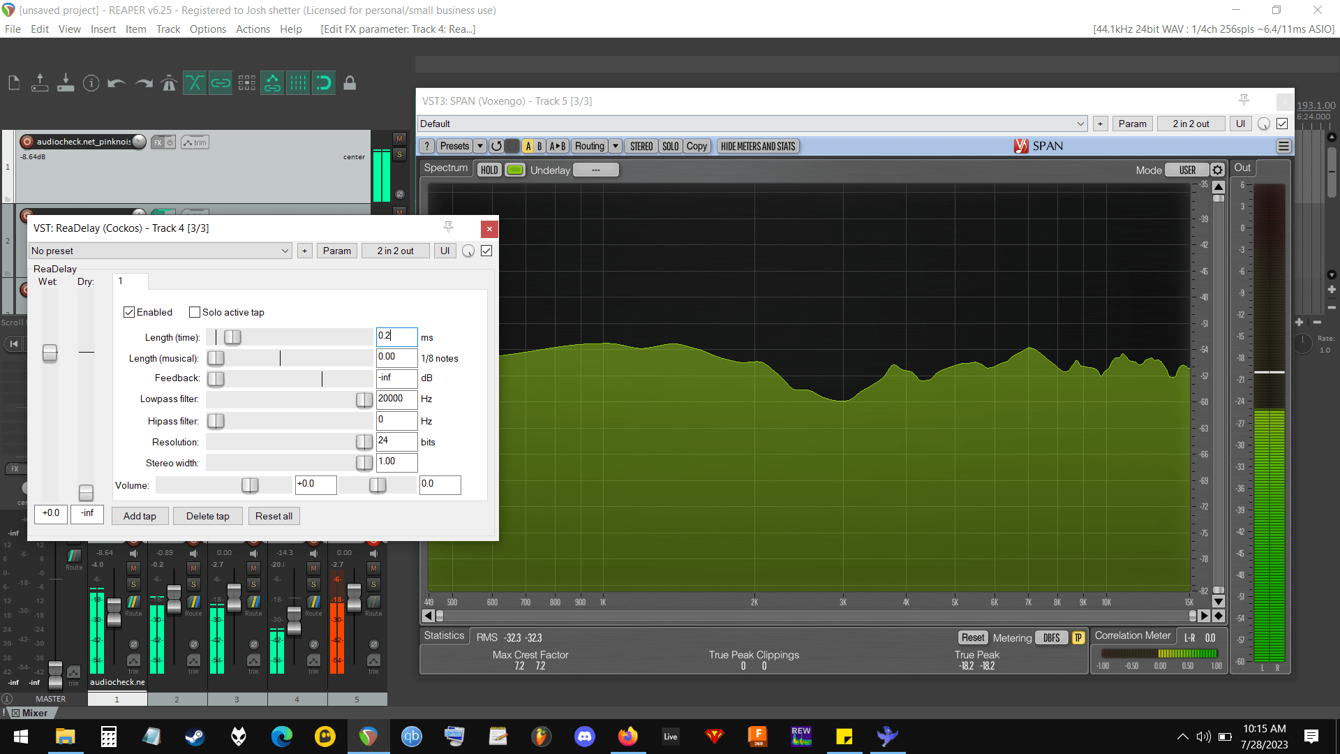

I played with driver delay and 0.1ms was the only setting that filled in the crossover dip. I was using 0.4ms before as that's what I came up with doing some math, but this shows that would be wrong.
0.15ms seems to sound even better, but I'm not sure if readelay is applying it. There is a definite audible differnce between .1 and .15 but readelay makes the 5 disappear upon closing the plugin, I can only assume it's still applied since the sound doesn't change.
Your thinking is sound. A prudent measuring jig would typically include series resistance, attenuation, DC blocking and so forth.If I kill an input
So you've established that you're on the wanted side of things phase wise. The proper phase isn't always the one that gives the highest summation, although it's a place to start.I played with driver delay and 0.1ms was the only setting that filled in the crossover dip.
I'm going to settle on 0.15ms, it sounds and measures the best to me. I don't even know how one implements that passively, but yes it was not correct before. Wonder how much that hurt the imaging.

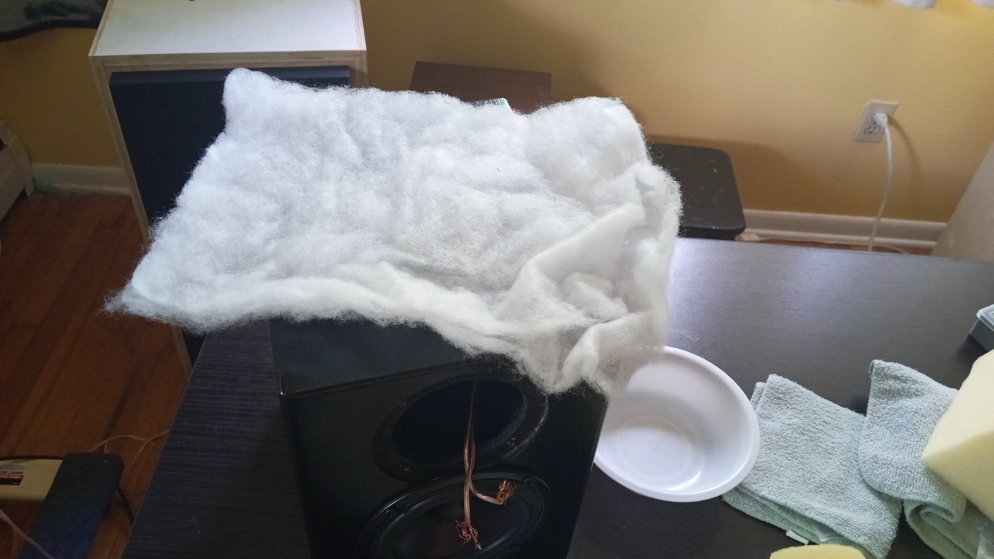

Well this is embarrassing. Apparently this little sheet of polyfill is all I had in the mid range enclosure. Place bets now on whether you think this was at all adequate lol.
Not sure what the ideal material would be here, I've got some memory foam I might try, local place has some denim insulation I might go get.
Well, from the example i have ( my 3 ways are commercial units i modified filtering from passive to dsp+multiamp) it seems very few absorbing material for mid.
In mine the whole mid box is stuffed. Not overpacked but in volume it is much more than what you have. I would not say it is mandatory as preference comes into play and some may prefer less stuffing but imo it is worth an experiment with much more volume than you have atm.
If you can afford denim insulation try it, for sealed mids it is perfect material.
I put some other stuff in there and seemed to have fixed a ~1khz resonance showing on the impedance plot and FR.
