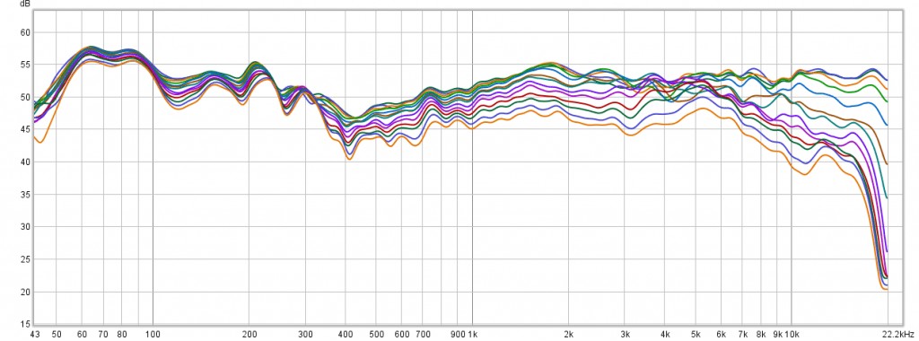

You can see here why I didn't use the Pit Viper xover. If you go into baffle sim software, take my baffle dimensions and place a driver on it, turns out moving the mid range to the side results in a nearly opposite response of the mid range. I took these on my angle marked lazy susan thing, but it's too small to actually get the cent of the cabinet at the center of the circle. Even so, the polars aren't very good for the tweeter.

I understand that, I definitely plan on considering enclosure design more in the future. There is plenty I know about optimizing the enclosure and baffle, but I kind of ignored a lot of it because I wanted cool looking ATC style speakers. We can see how that paid off. I have no trouble taking a step back and accepting that I made a bit of a stinker.

You have to solve the problem with the frequency response and phasing between bass and midrange.
You're basing this off what exactly? I already measured the speakers and implimented my own active filters.
