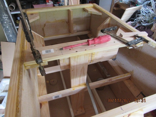

I hate to waste materials and I usually glue the speaker cut-outs to the box panels at random, cutting large woofer discs into halves or quarter sections sometimes but I use a lot of 42*19mm or similar when I make boxes and odd scraps of MDF glued in funny places at odd angles
Picture for giggles as this was a much larger box, 600 litres + after making an allowance for bracing and the shelf port

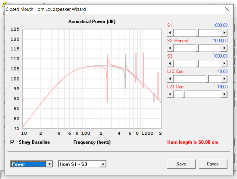

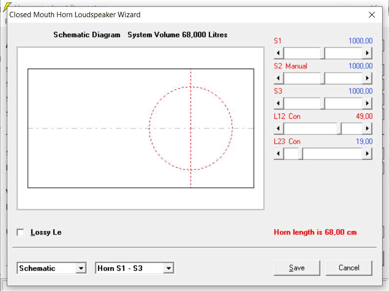

To add further evidence towards “it’s a longitudal box resonance” theory, here are @tmuikku hornresp simulations of the Yamaha NS-5000:
https://www.diyaudio.com/community/...tubes-reverse-engineering.399659/post-7362755
Yamaha cabinets are near identical to Coral’s and sims show 250 Hz first mode, just as I measured on real system.
It’s not a panel resonance, nor cone or surround resonance. Maybe let’s stop with ideas not based in theory or measurement, those are not constructive and only add doubt and uncertainty.

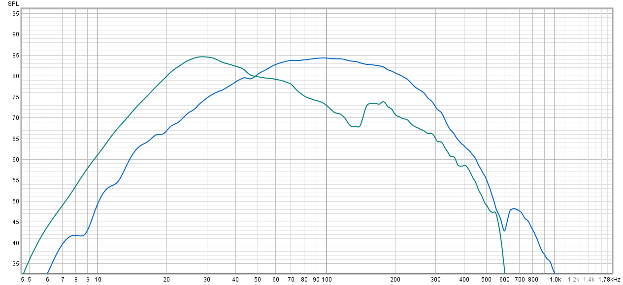

@wafflesomd could you please do port and woofer NF scan and show both graphs like in my previous post?
Isn't it nice how wavelength corresponds to physical objects size 🙂 anomaly in frequency response can be quite reliably mapped to physical size / features as long as measurement data is reliable. Certainly simulators are reliable and a good way to zone in to problems. And to learn about it, intuition thinking loudspeaker systems and their features with wavelength.
What is special in this case, or it is actually quite common, that its the lowest mode, the most longest wavelength that is the hardest to tackle with absorption. Polyfill must be packed quite tight to have any effect. If there is problem with standing waves its always the lowest one, all the above are progressively easier to handle and less problematic. Well, lowest mode is easy to tackle as well: position the woofer on the center of the dimension. Or multiple woofers with their acoustic center at the center.
I got rid of ports, its nothing but problems in home hifi and not really necessary in my opinion. Just use big enough cone, enough amplifier power and DSP to have any knee you want with a closed box and problem solved. Enough ways to the system so that the modes or other issues of any structure don't ruin the pass band. Of course, sometimes a port would benefit overall sound if the system has to be some form factor or something, but it just comes with trade-offs, extra hustle that then needs to be dealt with or tolerated.
Thanks. Seeing both on the same graph at the same level puts things into right perspective. Port output is much cleaner than I expected, 1st longitudinal mode is down 11 dB rel. to port main resonance.
4” port rel. to 12” woofer has 15 dB of area correction (20xlog10((10/4)^2), where 10 is actual radiating diameter of a typical 12” woofer). So 74 dB peak at ~170 Hz will be equal to 59 dB as radiated by the woofer. Coherently summing 83 dB (woofer level at 170 Hz) and 59 dB gives 83.5 dB in the far field.
0.5 dB - even 1 or 2 dB - narrow bump in the frequency response won’t be objectionable or even audible, so we can write off cabinet resonance as the source of any unpleasant coloration of the lower midrange. My next guess is the woofer to mid crossover.

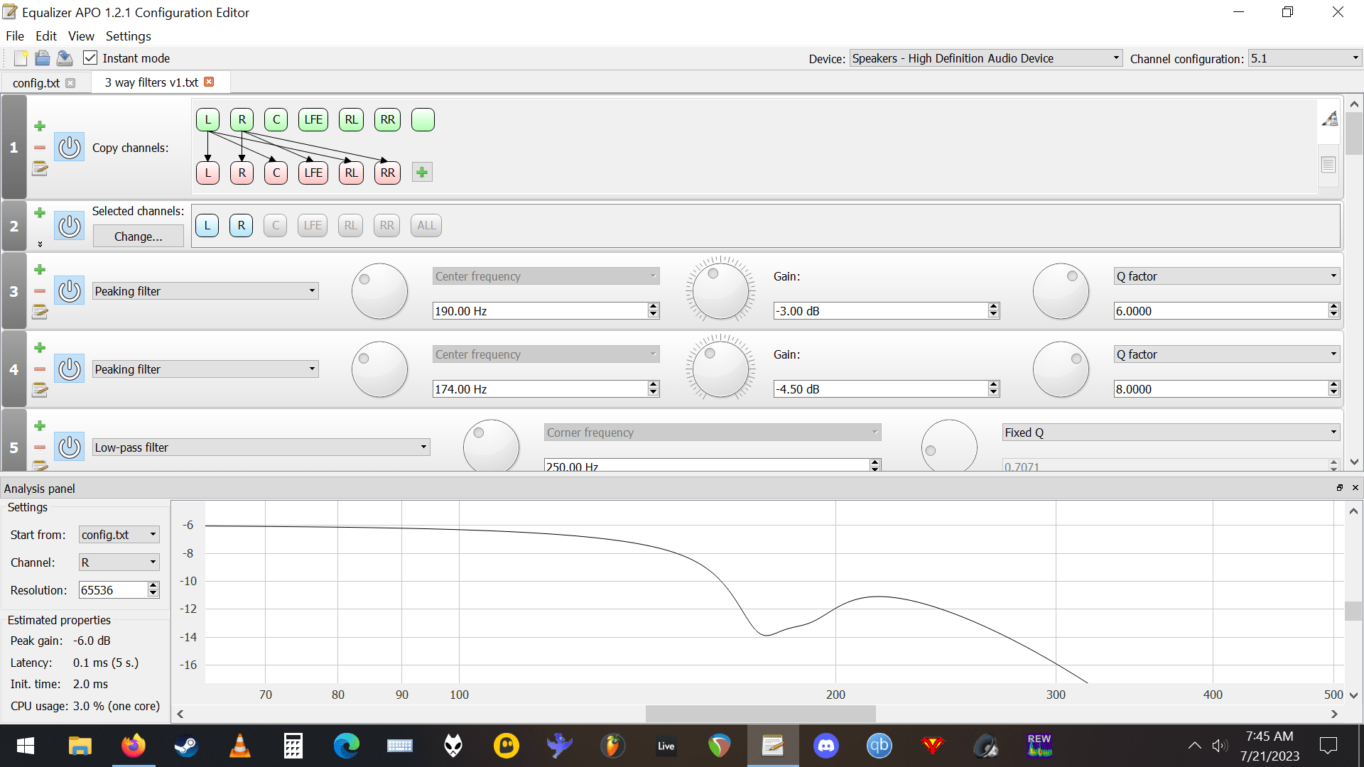

Right now I just have two 250hz low pass and hi pass filters in EQ APO for the woofer to mid transition. I haven't measured the speaker with all drivers connected outdoors because man, that is a bit of pain hauling my three amps and desktop out. I would like to eventually get some good on and off axis data outside to see how my xover is really working. I did get one set but the woofer response didn't quite look right and I didn't trust it, I assume I will need to do a close mic measurement and splice that in. I am also no longer using the tweeter from that data set so I will need to do a new one.
fwiw which is probably not much, these are my filters to help tame the problem area

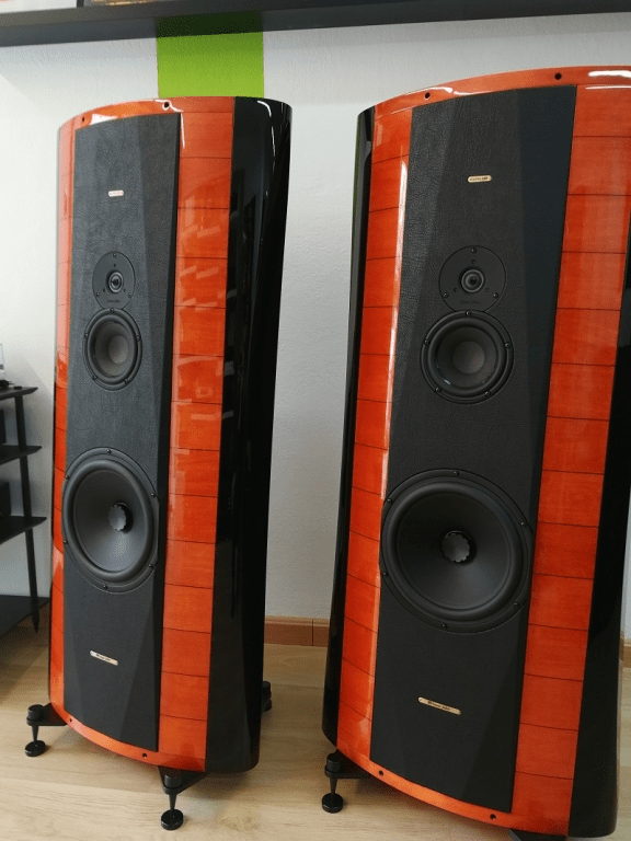

This is the kind of wide baffle that can produce excellent imaging. I don't know if AllenB had the Sonus Faber in mind when he spoke of a wide baffle, but this is one good example of a large, wide baffle creating directivity. Notice how much baffle there is above and around the tweeter.
With reduced directivity index you can improve imaging by reducing room interaction. Care needs to be taken not to introduce undue cabinet interaction.
@hifijim I wasn't think as specific as that, but good example.
Consider the term waveguide speaker design as a fancy way of saying I'll keep the sound under the control of a baffle in a consistent way, as much as possible. It then follows that the baffle has to be the right size to do that. It happens that room interaction reduction is the goal. Usually waveguide speaker designers come to wondering how low in frequency they can or should do this.
