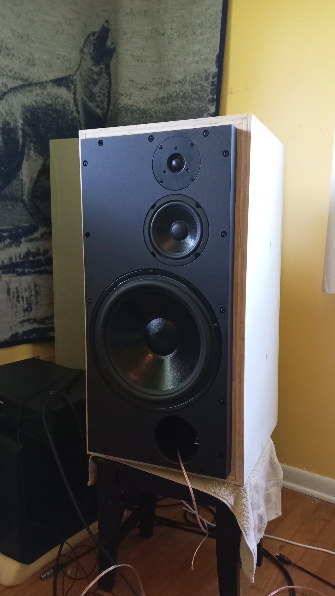

Howdy everyone. I've recently finished up the construction of a 3 way speaker and have run into some problems. The tweeter and mid sound excellent, but I think I messed up on the woofers cabinet. I think I did the porting, driver placement, and dimensions wrong to where I'm getting some sort of resonances in the ~200hz area and some others as well. I've tried a lot of dampening and plugging the ports but that hasn't helped. It kinda feels like I put a lot of work into these for nothing as this problem totally ruins the speakers. Is there any saving this build?
My drivers are the sd315a, dc130, and d27. internals LxWxH is 28.5x14x13", port is 4"x 10" on the front

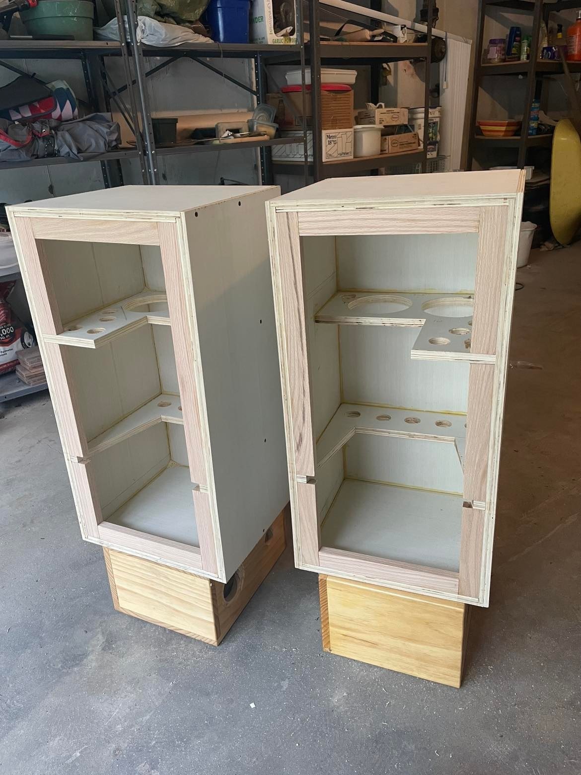

I have two brace across the side panels but they do vibrate at the offending freqencies, when listening near the side they almost sound like little radiators, maybe I'm overthrowing that though. it's 3/4" ply. 1.5" baffle and rear panels.

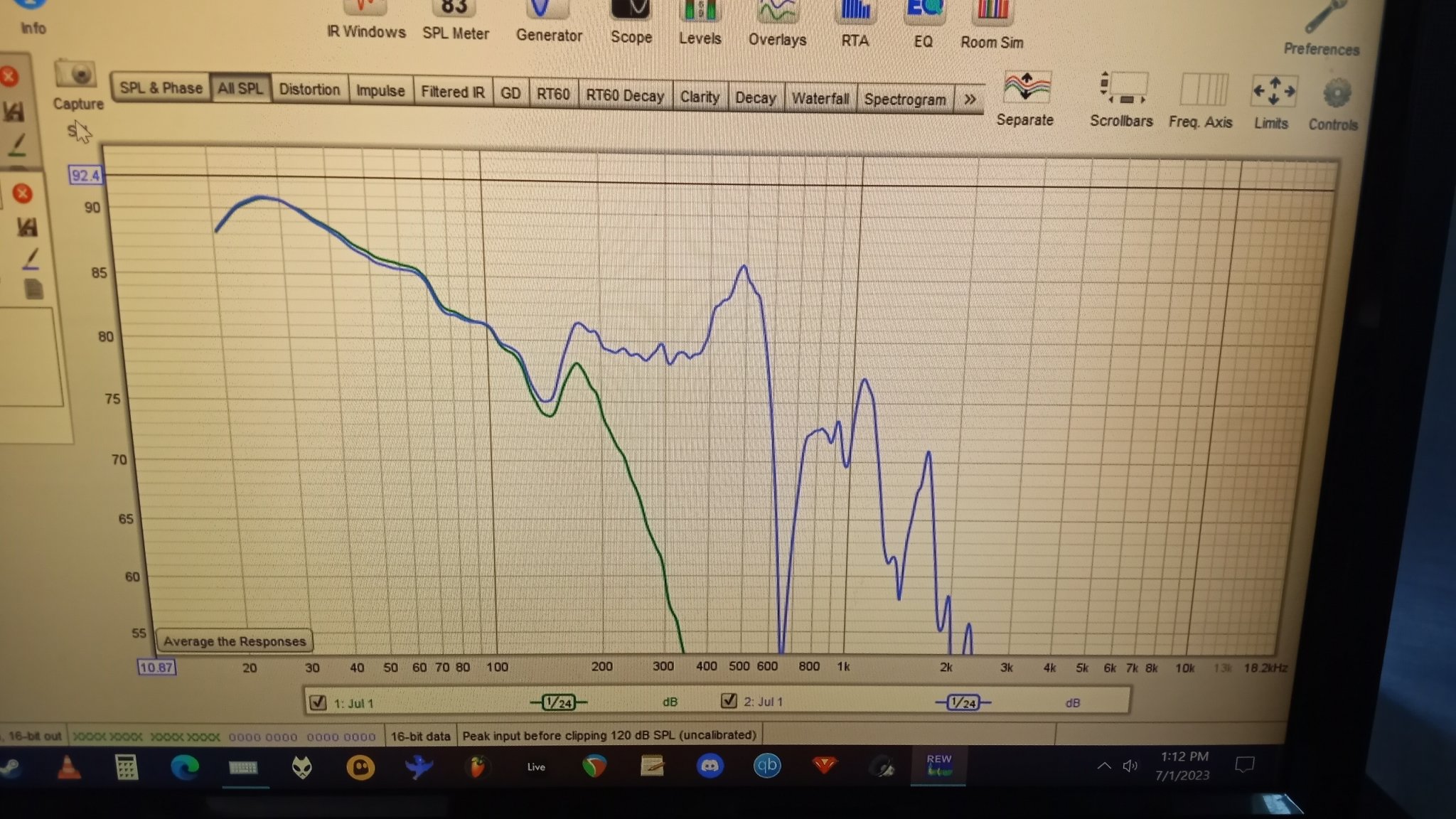

sorry for phone pic but my internet died today from storms. this is mic at port, green is with filter. blue is raw.

Bracing of the box itself doesnt look that bad.
What worries me is front baffle. It has four cutouts closely spaced which reduce its rigidity quite alot. At the same time, according to pictures, its screved on the box only on its edges. That looks like weakest point to me.
The impedance plot shows parasitic resonances around tuning frequency. Thats where alot of air is pumped in and out of the box, creating high acoustic pressure inside. Now the issue may be the port, but I wouldnt be suprised if the front baffle vibrate around tuning frequency like a drum.
Try to add braces between front baffle and the box, so additional support to the baffle is made, especially around the cutouts.

thanks for the assessment, I'm going to work out a plan for bracing and knock it out this week, i should be able add some to the front as well but there isn't a lot of room between drivers. I honestly find the baffle doesn't have much in the way of vibrations one can feel.
