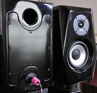

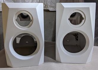

Don’t pick a simple rectangular box shape. Chamfering big time really works, see here and have a look at the off-axis response of this design. Whatever you do, think about the optimal placement of drivers on a baffle. Use VCad, Boxsim, The Edge and other tools available to design first and build later. That is of far more importance than buying expensive drivers. Although you could argue a RS150 or RS125 and a RST28A would have been better choices for a studio monitor, if you’d stay in the Dayton department. The XT25 plus WG300 you already have give an excellent starting point though, so I’d start with that one if I were you.
those chamfers are hard for me to do and not sure how to make them without a table saw. I did try once with circular saw but it came out wonky.

Crisply formed chamfers do require a table saw, generally speaking. However, a radius of any size can be made by sanding. If I was working without access to a table saw, I would use a hand held power sander with 60 grit to form a large radius. I would cut a template from cardboard with the correct radius shape, and use that as a guide while sanding.
Doesn't really seem worth the effort when one can just use a waveguide and round overs. Only chamfer speaker with waveguide I've ever seen is dxt mon. Seems to have most benefit with flat faceplate tweeters.
Can’t find the pics right now, but you can chamfer the baffle with help of two wooden guides and a hand saw. Yo have to sand the result of course, but with a circular saw you’re not freed from sanding either.

I prefer large roundovers. But...simple chamfer is more practical if using veneer that doesn't handle curves well. Facets come in handy in that they allow you to get the roll-off closer to the tweeter but not treating as much around the midrange/woofer where it is not needed and thus keeping the speaker narrower. Whether narrow is good or bad for imaging not being taken into consideration, but narrower is often desired for aesthetics.Doesn't really seem worth the effort when one can just use a waveguide and round overs. Only chamfer speaker with waveguide I've ever seen is dxt mon. Seems to have most benefit with flat faceplate tweeters.
