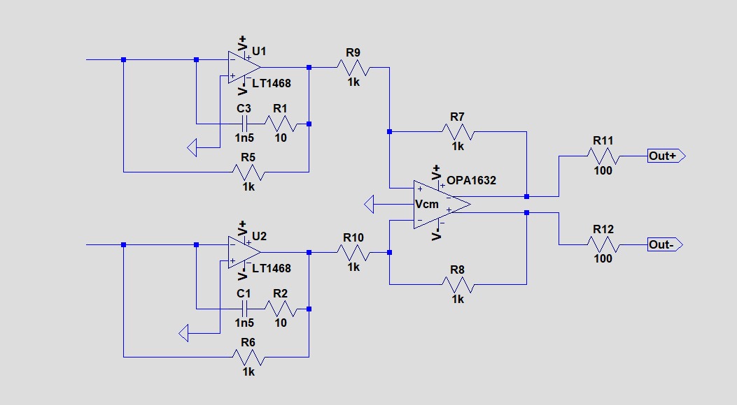

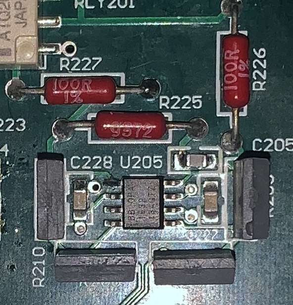

Winfried,
When looking for comparable circuit diagrams as what you have in mind, here is the differential/balanced version of my Bel Canto 3.5VB D/A converter.
Instead of a AD1853 it is using a PCM1792, both Dac's having current outputs.
This Bel Canto was a rather expensive D/A converter that I got for free because I gave some valuable feedback on their previous design.
As you can see, Bel Canto did not even use a filter around the OPA1632 and all filtering was done by the Dac's OS filter and the I/V converters with their 6db/oct slope.
In your case, you even have a 12dB/oct filter around the I/V converters (C46/C47 + C57), so you could also completely leave the filters around the OPA1632.
What we have seen in another thread comparing NOS Dac's to OS Dacs, was that we could not find any evidence that the HF content of a NOS Dac was noticeable, but that the length of the OS filter played an important role and short filters seemed to worsen sound perception.
These tests should be seen as a clear indication, but not as conclusive given the amount of people, but Bel Canto's decision to filter as little as possible can be fully understood.
So as a test, you could try exactly the same, with and without any filtering filter around the OPA1632.
This will also completely push the CMRR question to the background.
Hans

Hello Hans,
thanks for posting such a constructive comment, much appreciated!
Well, taking your remarks into consideration, my layout could go to production as and I could then build up differently populated boards. This way I may end up with a few unused or shoted components, but that's OK with me!
Caveats are:
I'm building this for a (new) active three way, so testing different 3-way board options does not seem viable...
I could build three differently populated boards, each according to a different alternative described above and compare these with my current, but by far not excellent passive speakers.
I will at some point need assistance with what / how to measure and compare board performance to support the final version decision
Winfried

HHm, the difference for magnitude and phase looks almost negligible to me. The 2nd pole of the input filter is way up, btw, making it basically 1st order.
@wgh52, I suggest you keep all the option in the layout for various cap arrangement etc.
I'd add series resistance (like 3.3R) to the board's supply input. The 1632 is a 180MHz OpAmp, we don't want to have any ringing (== high impedance) on the supply which easily happens with a cable connect to the main board (C-L-C tank circuit). EDIT I see now you have 100R here, maybe a bit large...
I haven't checked the layout thoroughly but one thing stroke my eye: The GND sides of the 100nF decoupling caps should not use seperated vias to connect to the GND, rather they should join first and then go to the plane at one single point (which may consist of multiple vias), and in this case the plane does not even connect these via points directly.
Now because of the balanced output this is all much less of a problem as no signal content actually is referred to GND, only the common-mode part is. Plus your layout would work fine quite probably.
Anyway, I again might suggest a 4-layer board which makes life so much easier, see my proposal sketch here:

What affordable 4 layer PCB design program could you suggest , I would be most interested because the ones I know are far from being cheap.
Regarding your comment on the input filter, you are right when you looked at Analog's suggested components, 2*220pF + 330pF.
In the sim I did, I used 2*500pF + 10nF giving a second order filter, just because we don't know what the cap values are in Winfried's system.
But it doesn't have to be a second order filter to filter the HF images as Bel Canto shows.
Images are probably at multiples of 8*192Khz with the multibit ƩΔ
That also questioned the need to filter around the OPA1632 with those numerous suggested caps.
I have added a picture made from the Bel Canto PCB showing its layout. Between both outputs there is still an RC network visible, R=100R, C=unknown.
Hans

You can't be sure, but chances are that the filter is close to the recommended circuit from Analog Devices. The team that came up with the recommended circuit knew the AD1853 better than anyone and must have spent quite some time optimizing it.
A very large capacitor between the virtual ground nodes will increase noise gain and reduce loop gain. Are the noise and distortion performance still reasonable with 10 nF?
Good questions, I didn't inspect those additional parameters, just created a second order filter because cap values were unknown.
So let's assume Winfried has the recommended AD values.
As mentioned, a first order filter will perfectly do the job.
Hans
