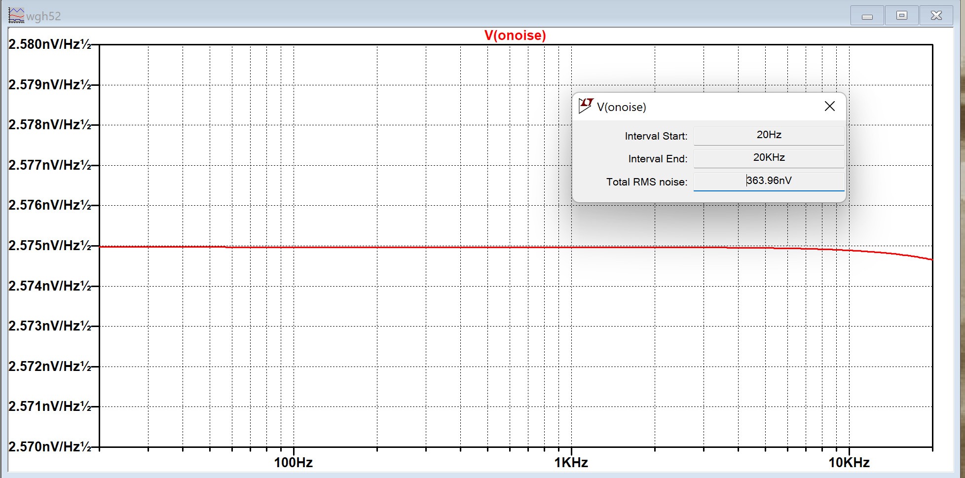

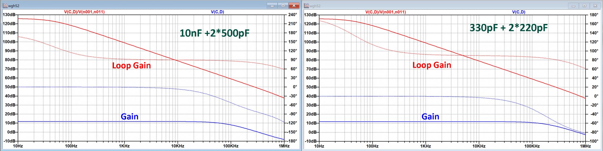

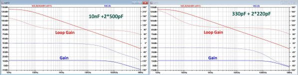

Marcel, since this was an interesting question, I simulated noise and loop gain by using the LT1468 as I/V converter, a fast opamp with 5nV/rtHz, slightly less as the OP275 in Winfrieds A/D converter.A very large capacitor between the virtual ground nodes will increase noise gain and reduce loop gain. Are the noise and distortion performance still reasonable with 10 nF?
The first image shows the loop gain for both versions, indicating that loop gain is not affected by the 10nF.
Concerning noise behavior, I have simulated 4 situations, with first and second order filter around the I/V converters and with and without the filters around the OPA1632.
Since all noise spectra were exactly the same, up to two decimals, only one spectrum is shown in the second image.
All this tells nothing about the perceived sound, but technically there are very little differences.

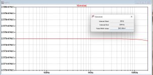

Could you post a schematic, including sources and Spice directives?
Marcel,Could you post a schematic, including sources and Spice directives?

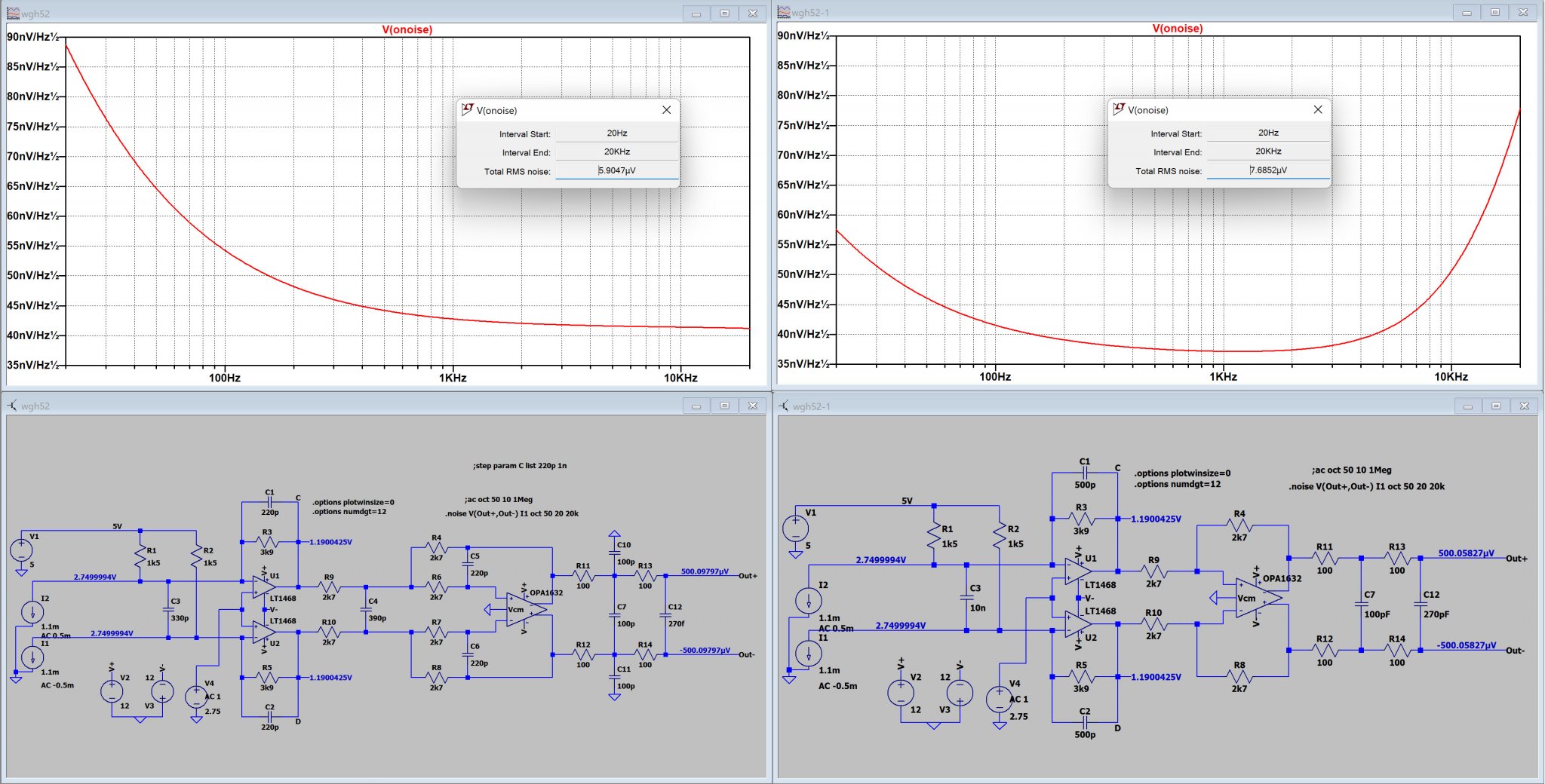

I can imagine very well why you are asking for the sources, because in hindsight I was rather surprised by the noise spectra.
With two 5nV/rtHz I/V converters with 3K9+1K5 around, these resistors producing almost the same amount of noise and with a noise gain of (1+3K9/1K5) per amp, one would expect behind the I/V converters already 1.4(1.4*5nV/rtHz)*(1+3k9/1k5) is ca. 35nV/rtHz.
At the output the OPA1632 circuitry noise would still be added to that, resulting in something slightly above 35nV/rtHz.
Nevertheless it took me some time to find the source of the problem.
The OPA1632 that I used was composed with a universal op-amp, where all relevant parameters were copied from the OPA1632, which always worked without a flaw.
However, just recently LTSpice changed the universal op-amps and as it turned out now, the previous ones are not compatible with the new ones when noise spectra are simulated but for frequency response everything is still O.K., quite weird.
I used an offset voltage of 0.5mV in my sims for this amp, but when changing this offset into 0mV, the whole noise spectrum changed completely, that's how I found out something was no longer compatible.
So, I changed the old universal op-amp for a recent version and everything seems O.K. now.

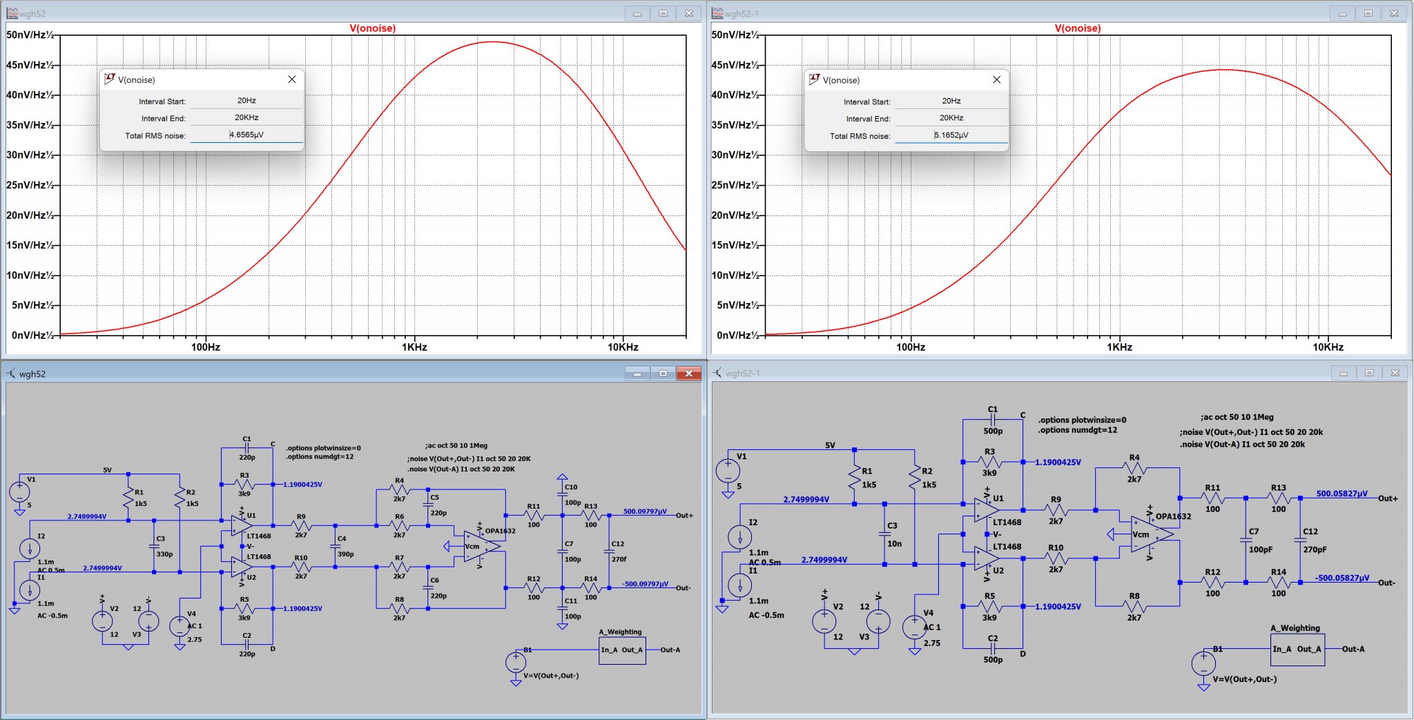

Below in the images you see the difference in noise behavior between the two versions, 330pF+2*220pF and 10nF+2*500pF.
With the 10nF at the input, noise above 10Khz is rising whereas with the 330pF it stays flat.
This results resp in 5.9uV and 7.7uV for the two shown versions, a difference of 2.3dB in favor of the almost single pole version.
When A-weighting these spectra, this reduces to resp 4.7uV and 5.2uV, a difference of only 0.9dB.
I could also have used smaller values like 4.4nF+2*220pF instead of 10nF+2*500pF.
Not shown here, but the unweighted and the weighted noise will then go to resp 5.8uV and 4.3uV, so even below the noise of the 330pF+2*220pF model with its additional filtering.
Keep in mind that this was in no way meant to push anyone in a certain direction, it was just fun to do the sims to get some feeling for differences between the various options.
If you still want the sources, let me know, but I think this noise aspect has been adjusted to where it belonged in the first place.

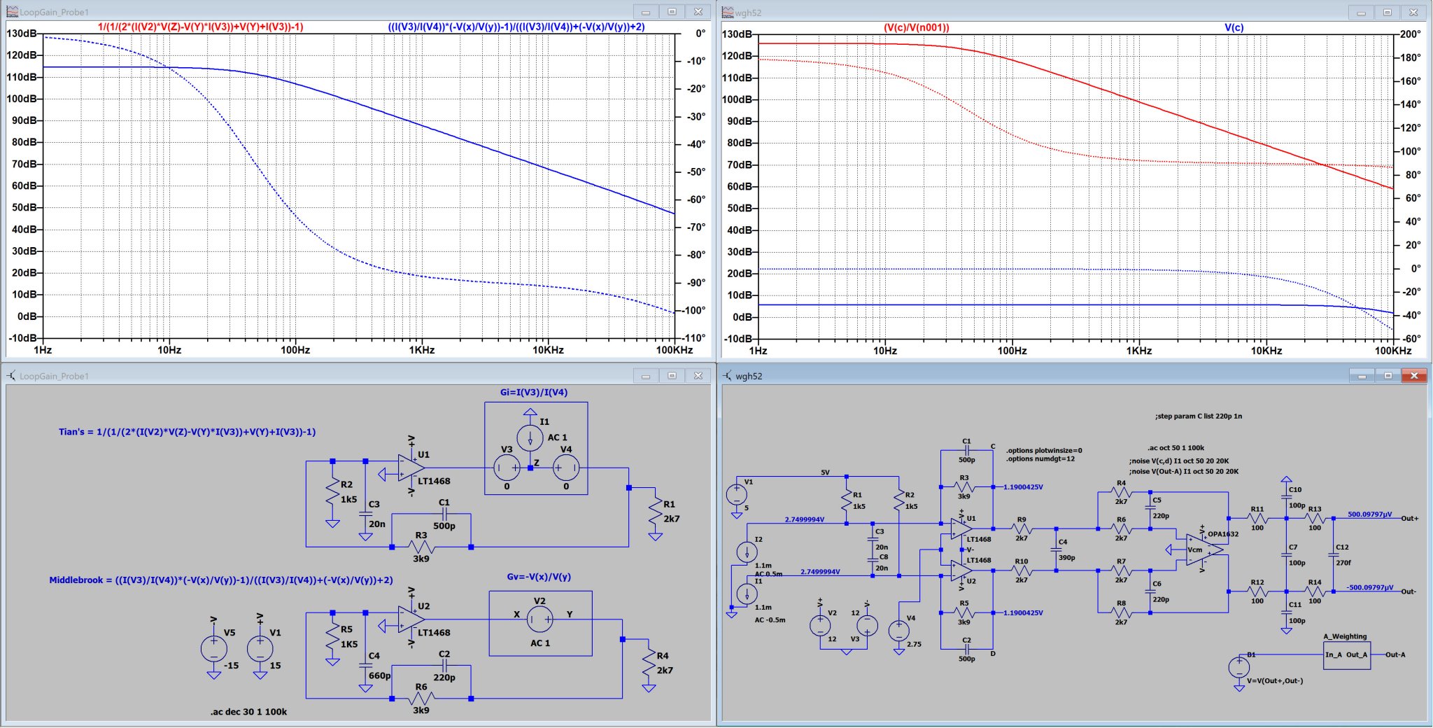

Marcel, I only used the op-amp model for the opa1632. For the I/V converters I used the LT1468 which is available in the LTspice library, so this was not affected by the bug.Hans, I meant the voltage and current sources, so they are already there. Great that you managed to debug the noise simulation!
How did you simulate the loop gain and is it any different with your new op-amp models?
To simulate the loop gain, I simulated the FR from 10Hz to 1Mhz and divided the diff output by the diff signal at both virtual ground inputs.
Hans

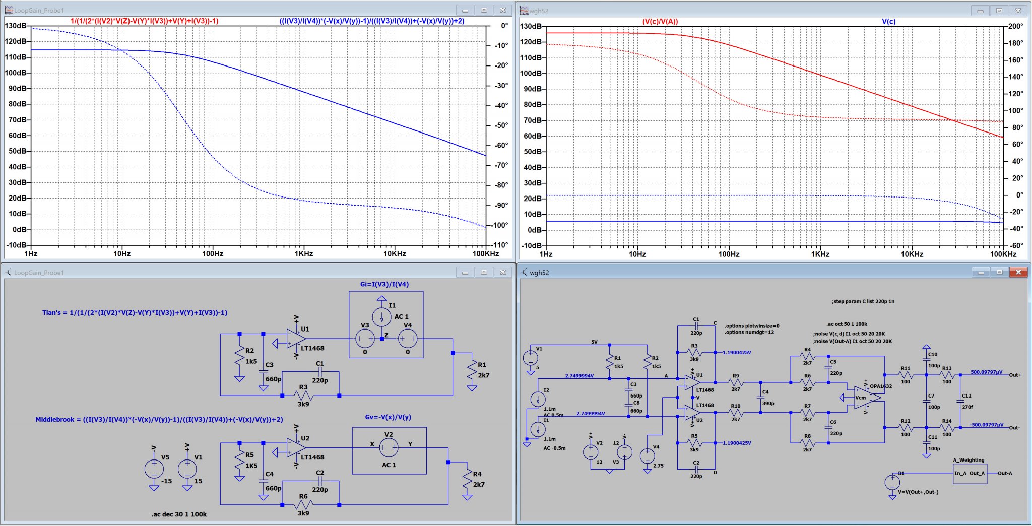

I see. That results in the open loop gain (gain of the op-amp) rather than the loop gain (gain of the op-amp times gain of the feedback network).
There are ways to simulate loop gain including all loading effects using Middlebrook's method, but I never used those (and never understood Middlebrook's method). I'm more familiar with the asymptotic gain model, but that isn't supported by LTSpice.
Marcel, isn't the loop gain circa the open loop gain minus the gain ?I see. That results in the open loop gain (gain of the op-amp) rather than the loop gain (gain of the op-amp times gain of the feedback network).
That's why both were shown in the previous images.
But to be more precise since you refer to it, I used both Middlebrook and Tian to get a more accurate result.
In the first image taken to investigate 330pF + 2*220pF, you see the loop gain according to Middlebrook and Tian on top of each other, so both giving exact the same result. Because I only looked at one halve, the 330pF had to be increased to 660pF
At the right you see both open loop gain and gain, where the difference between the two should give circa the same result as both curves at the left.
In the second image I changed the Tian to the equivalent of 10nF, and because it was only halve a section to 20nF.
The Middlebrook version was kept unchanged, but as you see in the image, loop gain is still exactly the same for both, so is the right part of the image compared to the first image.
This all should have shown that 10nF has some effect on noise contribution but has no visible effect on loop gain up to 100Khz.
However as we have seen in another thread, using a MFB filter around the I/V converter had a negative effect on sound perception, most likely because the DAC didn't like the cap directly attached to it's output. So when experimenting, one should listen carefully because nobody knows how the DAC output really looks like internally.
