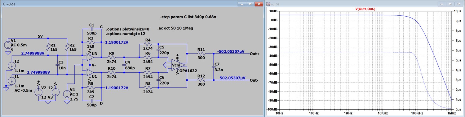

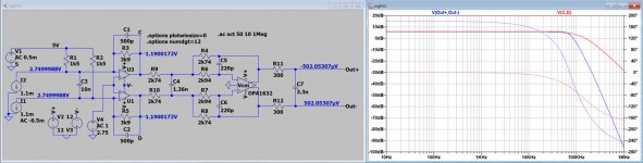

Whereas using a single capacitor cripples common-mode filtering.
In any case, two times 680 pF in series is 340 pF.

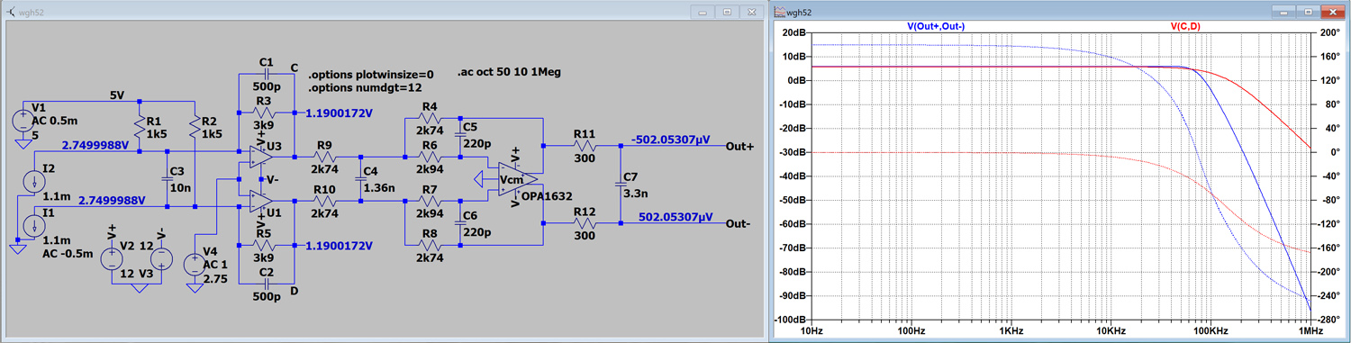

Klaus and Hans! Thanks for the unexpectable simulation work! I'm amazed! And so far as I understand the results, things look well!
I'm a bit concerned about the SMD and 4-layer "mandate", because I understand the electronic and appreciate the size advantages, but am a bit doubtful about my SMD soldering skills and also have not designed a 4-layer board ever...
With Marcel's recommendation/correction to take 340pF instead of 1.36nF, the resulting simulated bandwidth would just be wider and the phase shift lower in the audio band, right?
Now the question is which compromise to take? Better CMRR or better CM-filtering? Two or four layers? SMD or TH? It feels a bit beyond me to make appropriate choices.... Gut feel at the moment: Maybe I could/should do at least a 2-layer SMD board and go with Klaus' schematic seemingly addressing the CMRR and the CM filtering...

Right, but 340pF gave a bad FR.Whereas using a single capacitor cripples common-mode filtering.
But looking for the flattest possible GD, the optimal value is 680pF.

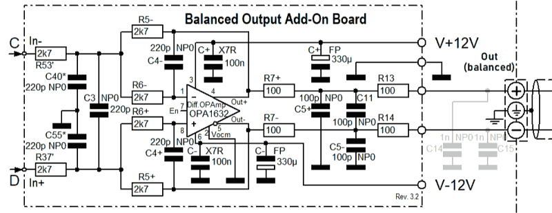

Hello again!
Here's my Rev. 3.2 Schematic:

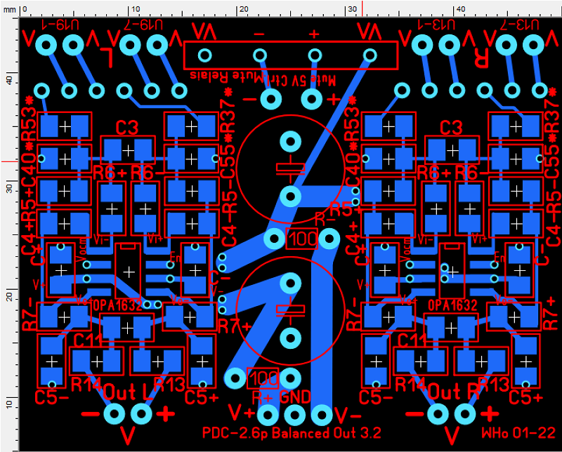

I hope to have reflected all or most of the suggestions... In any case, I took a go at a dual layer SMD PCB for both L and R channel:
Front side:
Back side ("x-rayed" from front):
All SMDs are 1206 size because that's what my old hands can handle 😉 My Project (just as a friendly reminder) is to have three of these PCBs in the PDC to drive three way active speakers. At the moment there is provision for jumpering the inputs into the Buffer or back to the main board. Not sure if these will stay. Also on the PCB is a muting reed relay to drive the OPA1632 Enable function which shall be driven by the PDCs output muting signal. Still missing are fastening holes as I have to still develop a good way of "piggy backing" the Output Drivers on the main PCB, wanting to keep the cabling from I>V to the Buffer as short as I possibly can...

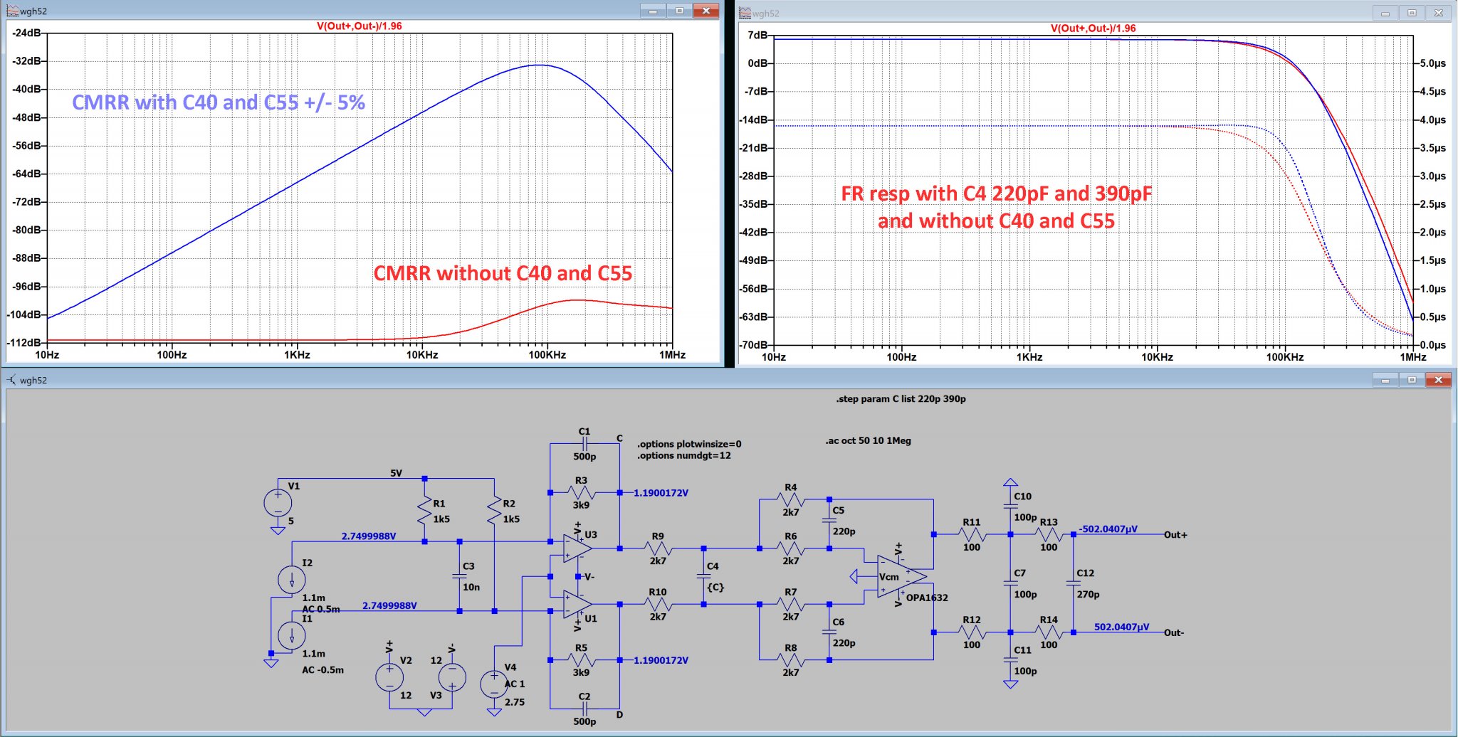

Hi Winfried,
1) Leave C40 and C55, they heavily cripple CMRR as mentioned before, see attachment upper left.
That's exactly where differential topologies shine, the least possible connections to gnd.
2) I have added 260pF at the output for your 5m cable and done the sim again.
Without C40 and C55 and with your latest circuit diagram, your C3 should be 390pF for the flattest possible GD.
Counterintuitive, the larger C3, the further the FR extends, a 1nF value gives the flattest HF response so you have the choice.
3) Since you have an almost empty bottom PCB side, I suggest to use a ground plane.

Hello Hans,
thanks for your valuable input and the simulation effort! Your simulation results look compelling! While technically they point at an electronic optimum, I'm unclear about potential relevance to sound quality - being unable to judge which compromise is best...
on 1.
The choice for having C40 and C55 in the circuit was based on Klaus (kstr) input and simulation results. So, here I'm unsure what to do, but will leave the components on the board to have options.
on 2.
I'll do the same as for 1. and keep the layout to maintain the option of populating or not.
on 3.
Maybe it's not obvious, but the back side already is intended as (kind of) a GND plane. Yes, with a few "cracks". But I hope it will work anyway 😉

Winfried,
To avoid a misunderstanding, the 270pF was just to simulate your 5 m cable capacity, it was not meant to add to your PCB.
Those comments on C40/C55 are showing IMHO a lack of understanding.
Argumentation on what they could possibly add to a differential topology in a positive way would be interesting to hear.

If they were separated by resistors on each leg then the caps would make more sense. Exactly what AKM did with AK4499 eval board after the I/V. Also, same as what Topping did in D90.
Isn't it obvious? It's nice to have some common-mode filtering because any real-life differential active circuit can generate intermodulation products between the common mode and the differential signals if the common mode signals are large or steep enough. For example, the capacitance of the tail current source of the input differential pair will cause variations of the tail current when the input common mode level changes quickly, which will modulate its differential transconductance.Winfried,
Hans
In this case it probably doesn't matter much either way: the common-mode rejection is already messed up by the mismatch of the feedback networks of the two transimpedance stages and there is already some common mode filtering in those. My gut feeling is that wgh52 won't measure much of a difference between the circuit with and without C40 and C55, not even if he borrows a fancy audio analyser.
Hi Marcel,Isn't it obvious? It's nice to have some common-mode filtering because any real-life differential active circuit can generate intermodulation products between the common mode and the differential signals if the common mode signals are large or steep enough. For example, the capacitance of the tail current source of the input differential pair will cause variations of the tail current when the input common mode level changes quickly, which will modulate its differential transconductance.
As always your contribution is highly respected, but isn’t calling the CM/DM IM distortion as an obvious reason to necessitate CM caps a bit far fetched in a differential DAC configuration ?
Fast op-amps can perfectly cope with fast CM signals (spikes) as measured in another thread.
And yes, you are right, the caps around the I/V converter of unknown tolerance and the 220pF caps around the OPA1632 can also negatively affect CMRR.
So, when these 4 caps are of moderate tolerance, the whole CMRR issue is a non issue, almost leading to the question: why differential and not just balanced.
