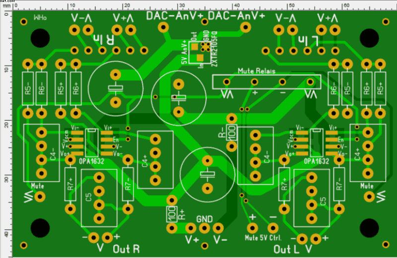

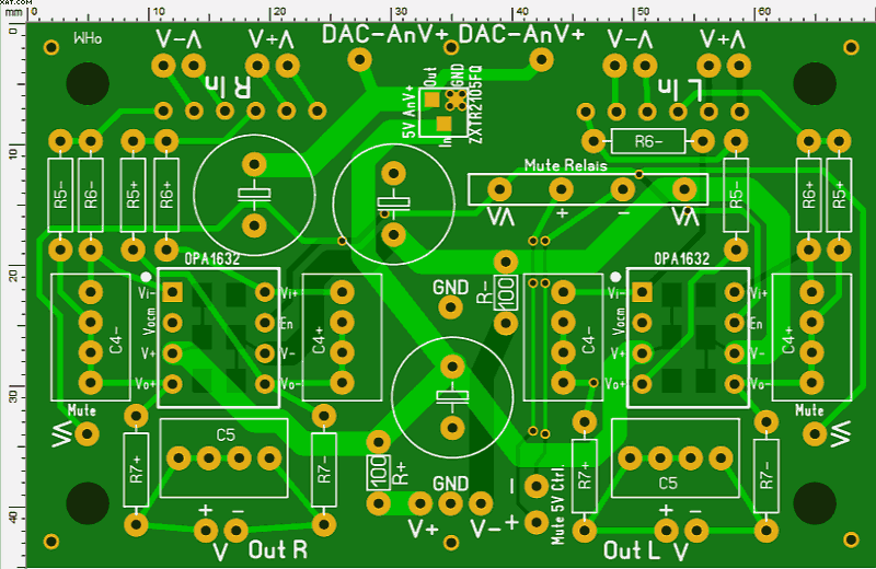

For what its worth, I have created a 70x45mm stereo buffer board. Actually, one version assumes the OPA1632 soldered on a DIP8-adaptor, so it would be more easily servicable if need comes up... So, here's my first hit at a 2-sided Sprint layout for your valued input.
An optional Reedrelay is on-board for the muting funktion with the chip's Enable function, also I have placed an optional 5V Regulator (feeding from the +12V rail) to potentially feed the AD1853 analog with 5V it needs (and not use the system's internal 5V for this).
Please let me know your proposals, objections or concerns, if any.

I would avoid using opa1632 on a dip adapter. its really not appropriate IMO. it isnt a super fast opamp, but it isnt super slow either at 150MHz bandwidth IIRC. are you using bipolar supplies? you should add a 0805 size ceramic decoupling cap of 0.1uf -> 1.0uf across VOCM->GND; this will improves noise performance vs just tying it to ground and it also provides a handy spot to add bias if required that you wont have if you just tie it to ground, without lifting a pin or cutting a trace. if you want the opa1632 to swing around 0V VOCM, setup like this, it will act to set VEE- -> VCC+ /2, which with symmetrical supplies will settle to 'GND'. With single supply it will sit VCC+/2 but not sure how I would decouple that, I would probably force a voltage of that in single supply mode and decouple/bypass that to ground, rather than leaving it floating (I have not done a lot with single supply with opa1632; as the performance is a bit lower)
The film caps for decoupling the rails, at the bottom of an adapter are going to be pretty much useless IMO. You may think you are following the application schematic, but the layout recommendations are not satisfied. i'll have a bit more of a look after lunch and provide a bit more feedback.

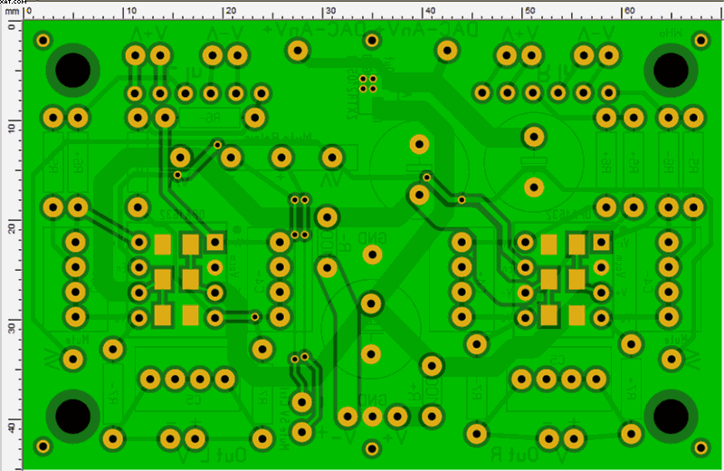

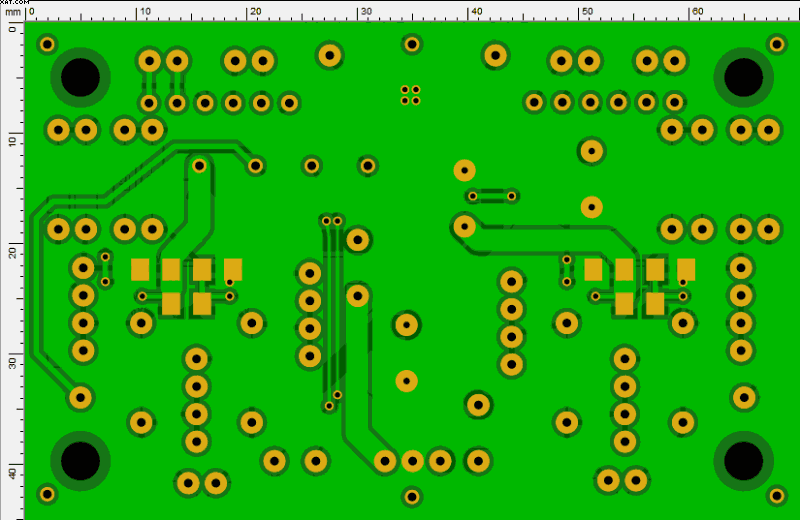

Well, the first layout I made was with the SMD OPA on the board without adaptor and as you recommend this over the adapter solution, I'll share it here:
As on the adapter, I have placed the 100n NP0 decoupling Caps on the back side under the IC connected with vias and hope this is acceptable. Also, as the back side is supposedly a Gnd plane, I have tried to place most component connections on the upper side. There are some vias in the supply and signal lines to keep Gnd paths short and low impedance. Not sure this is the right approach, but it made sense to me anyway.

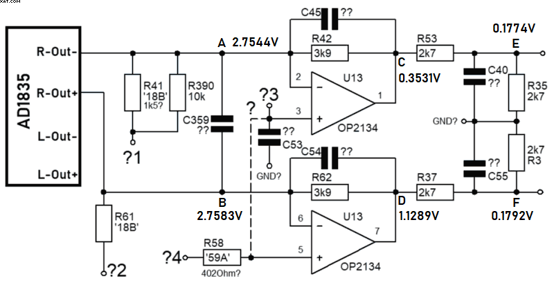

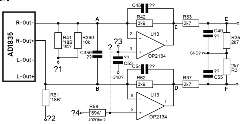

Next on my part is measuring the DC voltages you requested. Here's where I think you recommeded to measure:
DC Values to document as far as I understand:
A>Gnd, B>Gnd, A>B, C>Gnd, D>Gnd, C>D, E>Gnd, F>Gnd, E>F
These values for the R and the L circuitry.
Briefly confirm and I'll go with that.

When you look in the first schematic of post #1, you see that one of the outputs E and F is essentially connected to a negative op-amp input that follows the positive input (difference amplifier). Apparently E is connected to the positive input of the difference amplifier op-amp and F to the negative input. That explains why there is only little offset between them.
The offset between C and D can be due to the assymetry caused by R390.
