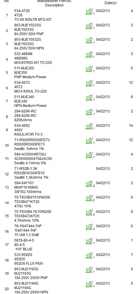

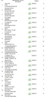

Just looking through your parts list in the earlier post. MJ transistors and washers are fine. However mica washers need thermal paste to work properly. The other alternative are the silicon pads which are used dry and are clean. I believe the "old fashioned" mica plus compound is the best for thermal transmission though.
Have you actually found any failed resistors ? just asking with you ordering some.
What are all the trimmers for :) 8 x 4K7's

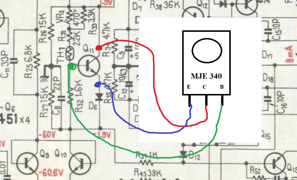

Don't forget the MJE340's for the vbe multiplier. They are a T0126 package so you need insulating washers for those.

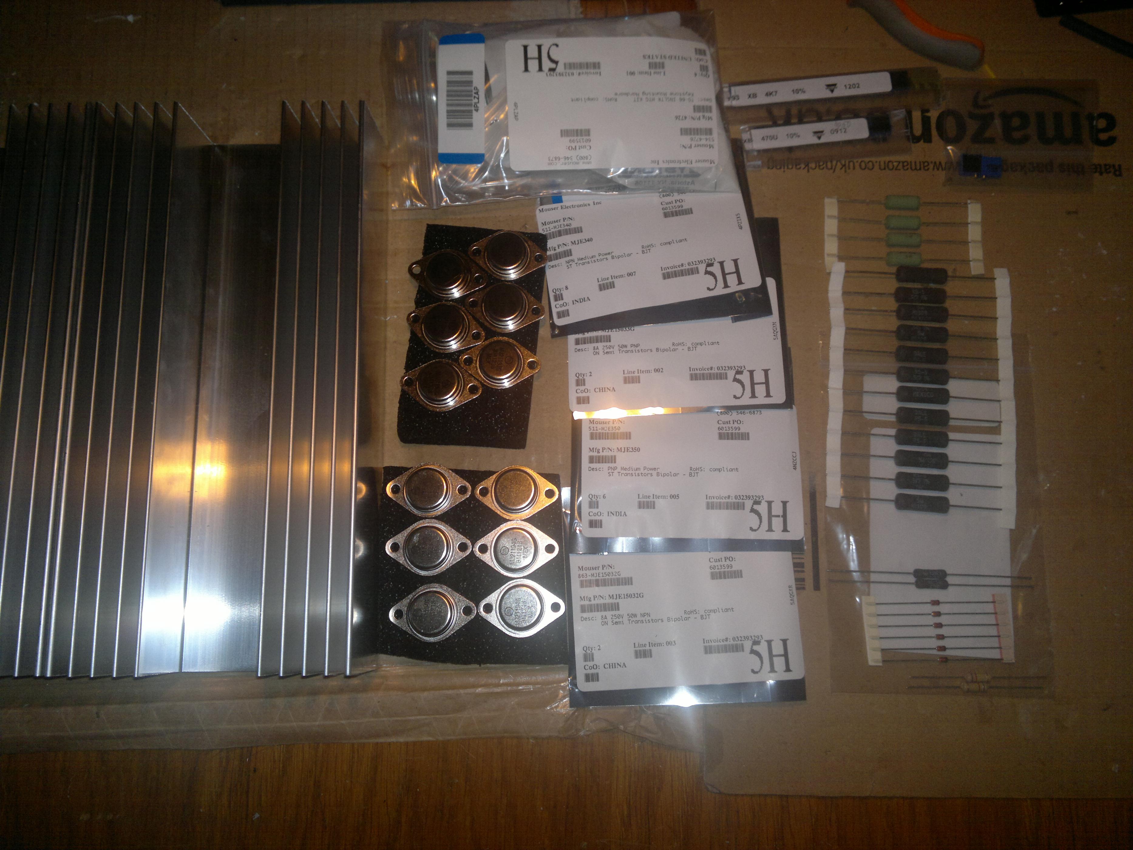

I order everything but I'm not sure I got the right isolators 1, 2, 3, 4
In any case I don't think it will be a problem I can find something locally if necessary.
I need to buy some thermal paste :)

They all look OK. Quantities seem a bit high for some :)
As a repair project this all has to be done carefully and slowly checking everything along the way. I can understand you wanting to order as much as possible but that approach might be unrealistic in practice.
One component that should perhaps be replaced is VR2 which is the preset that adjusts the bias. If the preset was intermittent then the bias current would increase which is destructive. When ordering presets remember that the modern small mutiturn ones won't directly fit the PCB and that adding wires to parts is messy. Drilling the PCB is an option or try and get parts like the original style. If they have wires attached then they won't be held firmly enough to adjust. At the moment and for testing VR2 isn't a problem because we have it (the whole multiplier) shorted out.

To be going on with you can fit one pair of output devices. Are we going for new insulating washers ? With thermal grease ?
Make sure the heatsink is clean and DO NOT overtighten the transistors. Tight, but not that tight it distorts anything.
If you are replacing the 0.5 ohm resistors then now is a good time.
Familiarise yourself with the pin outs of the MJE340 (that we will use for Q11) although we keep that shorted still for the time being.
The diagram in post #112 shows the pins as 3,2,1 when looked at from above. 3 is the Emitter, 2 is the Collector and 1 is the Base.

Next step has to be reinstating the Vbe multiplier Q11. Using an MJE340 this device must be fitted to the heatsink in the same sort of physical area that the original was mounted. The transistor has to accurately sense the temperature of the heatsink. If you have to drill the heatsink then make sure there are no burrs on the metal. The tiniest metal "flakes and chips" can puncture any insulating washer. When the transistor is mounted then check using a high ohms range on your meter that there is no electrical contact between the heatsink and the transistor leads.
Before wiring the transistor to the pcb you must turn VR2 so that it is at minimum resistance. You can check by measuring (on ohms range) across R33 that is across the preset. You want it turned to the end that gives the lowest resistance. It should ideally be zero ohms but pre-sets often have a few ohms of resistance even at minimum.
Wire the transistor to the PCB making 100% sure the connections are correct as shown.
Remove the short we applied earlier across the transistor.
