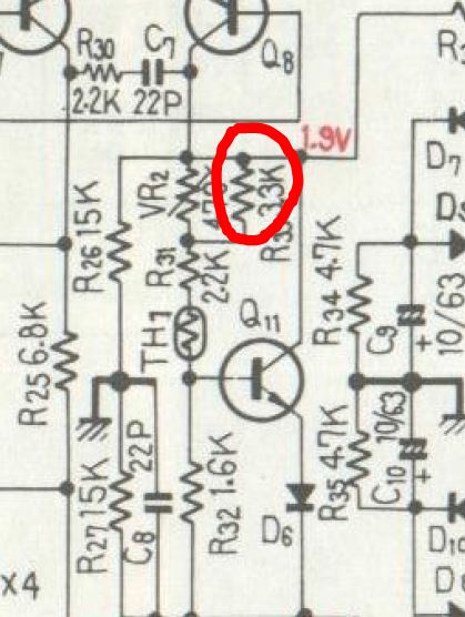

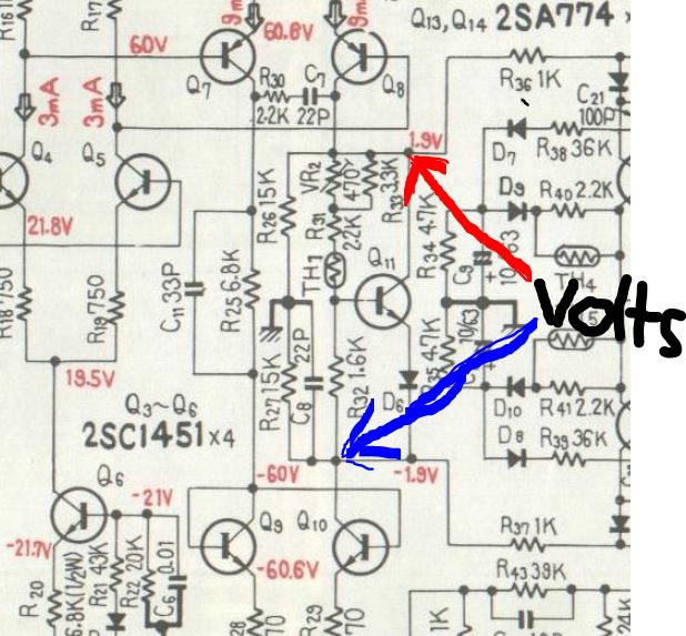

We have to do some careful measurments and tests now. I suspect that this might be down to slight differences in Vbe (the turn on voltage) of the newer transistors (which isn't a problem).
The DC voltage on L1 is correctly adjustable and swings positive and negative when VR1 is adjusted... yes 🙂
With VR2 at minimum resistance measure and record the DC voltage across TR11 and D6 as shown.
Now turn up VR2 to maximum resistance and again measure and record the DC volts as shown.
(Its much more accurate measuring this way across the Vbe multiplier than measuring voltages from ground)

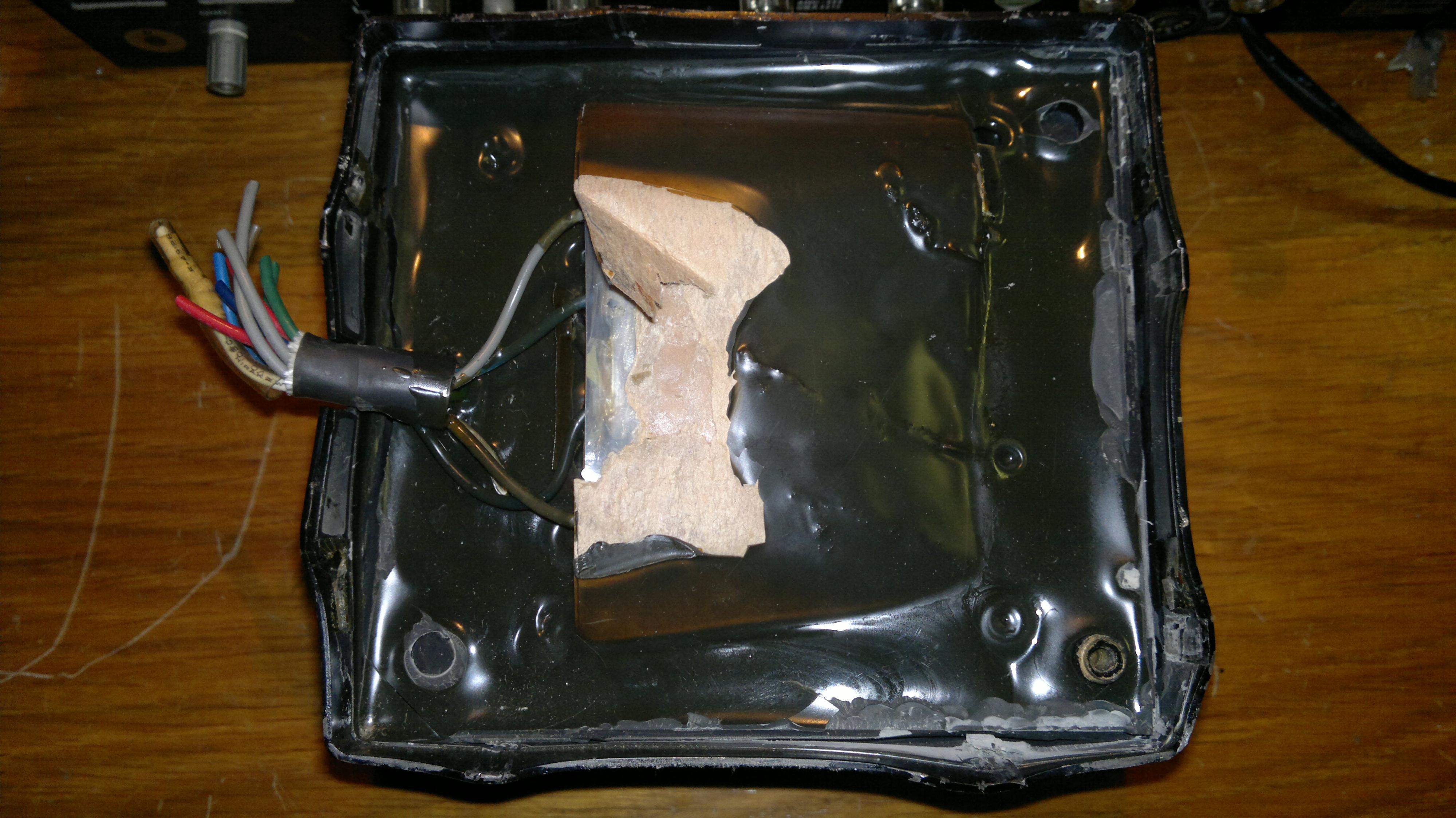

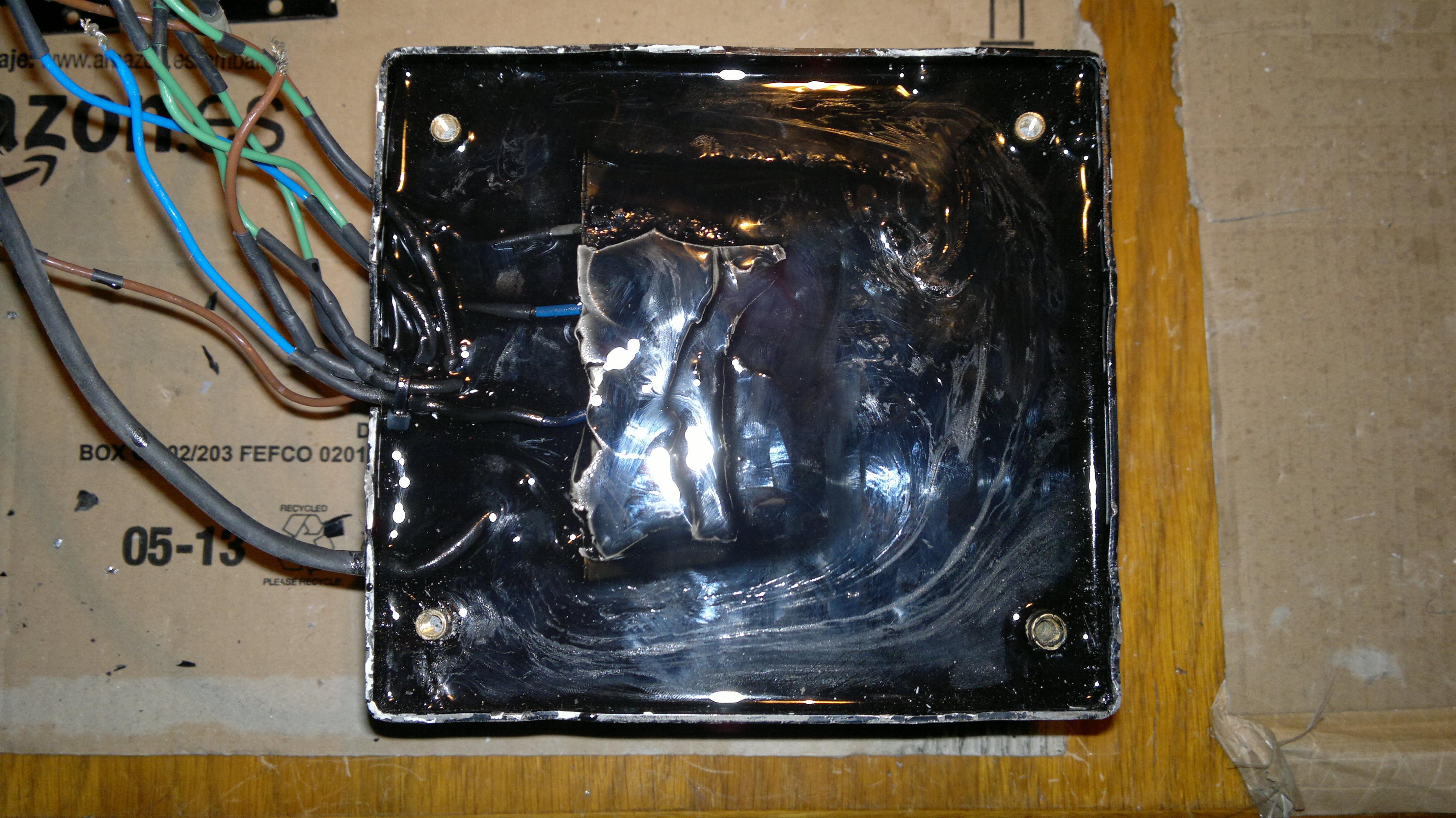

Transformer update
I finished fixing the transformer but I made a mess... I glued it to the floor 😀
After two hours I ended up removing the floor but as soon as my grandmother find out about it I'm death eheheheh
At least after all this troubles the transformer look a lot better 🙂
VR2 min, voltage across TR11 and D6 3.35V, voltage at R1 -6mv
VR2 max, 3.70V, R1 -2.2mv
Voltage at R1 don't swing but stay constant, 0mv between pin 9-13 and VR1 always at minimum
I After two hours I ended up removing the floor but as soon as my grandmother find out about it I'm death eheheheh
Your still here to tell the tale... for the time being 😀

R1... you mean L1, the output. You have to be clear and careful in all you do 🙂
So VR2 is swinging the voltage across the Vbe multipier (and diode) from 3.35 to 3.7 volts. That's a good result and it shows its working OK, just that its a little "out of range" to bias the output stage. We'll come back to that a little later.
For now set VR2 back to minimum resistance such that the voltage across TR11/D6 is at its minimum.
VR1. That should swing the voltage on L1 from slightly positive to slightly negative as it is turned. From what you have just written that is not happening so re check that adjustment works OK.

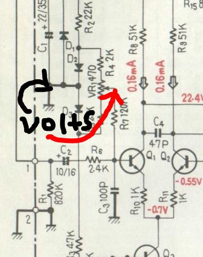

Yes sorry I mean L1, I will be more carefull about it.
The voltage on L1 don't go positive whatevere setting I use for VR1-2, the video show L1 after turning on the amp, VR1-2 at minimum.
If I touch either VR1 or 2 it goes more negative
Video - TinyPic - Free Image Hosting, Photo Sharing & Video Hosting
Check that VR1 is working properly. If you measure at Q1-B (Base) and adjust VR1, it should swing + & -
The two diodes, D2/3 clamp to ~ +/-0.6V which in turn sets the offset V.
If you measure DCV across Q1/2 collectors you should see it change from slightly positive to slightly negative as VR1 is adjusted. This indicates that VR1 is working correctly. There will be a null point where Q! & Q2 are conducting equally or the bias current is in balance.
There probably is some inter-action between adjusting VR1 and VR2
I'd go along with that 🙂
Hopefully there isn't a problem, its just puzzling that the offset doesn't adjust. It could be related to the fact the output stage is drawing zero current. I would be content for now just to know that the voltage on the wiper of the pre-set adjusts to plus 0.6 ish volts and minus 0.6 ish volts as the pre-set is turned.
With the output stage currently drawing zero current there is a "dead zone" around the zero point.
If the above checks OK then I think we should move on 🙂

This is what I suggest as the next step. The bias generator TR11 is developing 3.7 volts maximum. That is failing to turn on the combined base and emitter junctions of outputs, drivers and pre driver. That's 6 B-E junctions that need to be forced into conduction and if we say 0.65 volts is needed per junction (its around that figure give or take...) then we need nearer 3.9 volts.
So what I propose is to remove R33 and then starting with VR2 on minimum resistance slowly adjust it and see if you can get the output stage to draw current. You should then be able to get a voltage between test points TP9 and 13 (the output). Remember the voltage is small. If it adjusts OK then carefully see if it will reach around 50 millivolts. The bulb will probably begin to glow.
