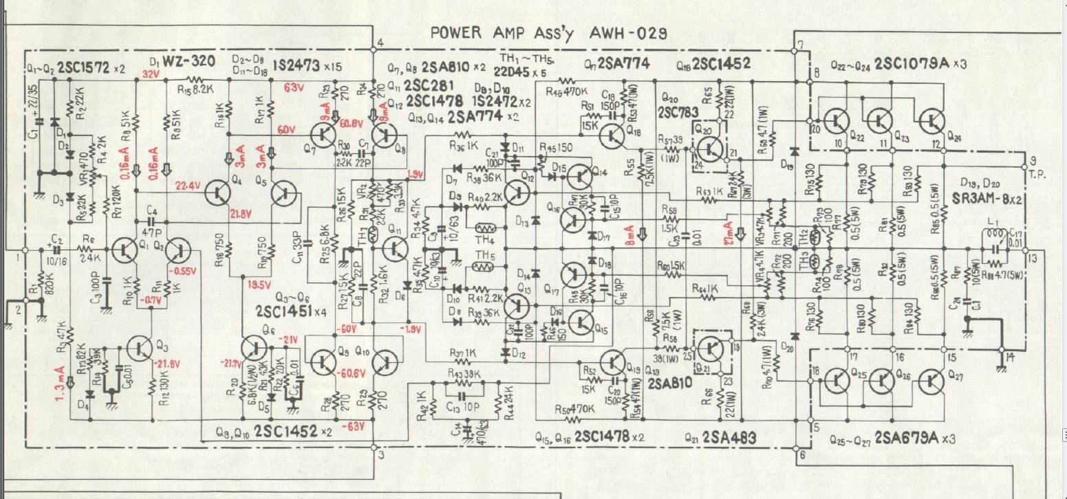

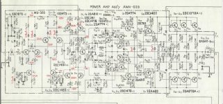

Is this the one.
If you are really intent on having a go then we can come up with a plan to test and work on it (but not today :))

Is this the one.

That looks promising... all things are now possible :)
I can outline the next steps for you (if you wish :)) which consist of fitting the transformer back and disabling the output stage such that it can not draw excess current. It all has to be done very methodically with a lot of checks along the way to confirm all is well.
Powering of the amp (when that stage is reached) must be done with the bulb tester.
