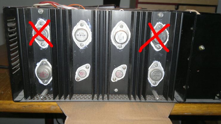

I've thought some more on the bias current, and a value around 50 milliamps seems closer to the ideal technically, given that the amp uses relatively high value emitter resistors. That would give a power dissipation of just over 3 watts per transistor (around 20 watts per channel).
Taking all this further, this is what I think might be a good idea.
Back in its day, this amp rated at 150 watts RMS needed the three pairs of output transistors to deliver that kind of output. Those originals (apart from voltage rating) are rated even less than old 2N3055/2955's
The devices we are using are far more highly specified and two pairs rather than three should be more than capable of meeting the full output required.
So here is the plan...
Still working on this channel only we fit just two pairs of outputs.
You adjust the bias to give 22 milivolts between 9 and 13
Leaving the amp on you monitor that voltage and make sure it is reasonably stable. It may go as high as 30 or 35 millivolts or so as the amp warms and then fall back down.
After say 30 minutes (and providing the voltage has been reasonably stable) you can then readjust the voltage back to 22 millivolts.
(Running two pairs of outputs rather than three has the huge benefit of reducing the heat produced).
If that test is all OK you then return VR2 back to minimum.
Remove the bulb tester so that the amp is on full mains.
Switch on and again reset VR2 following the above so that you have around 22 millivolts between 9 and 13 when the amp is full warmed.
At this point you can test this channel with a speaker. You can turn it up quite loud. Keep checking the heatsink temperature. As long as you can touch the transistors themselves for 4 or 5 seconds without burning yourself they are OK.
As it gets hotter we do another check.
Turn the volume right down (leave the speaker connected) and again check the voltage between 9 and 13. It should always be trying to fall back down to around the 22 millivolt level.

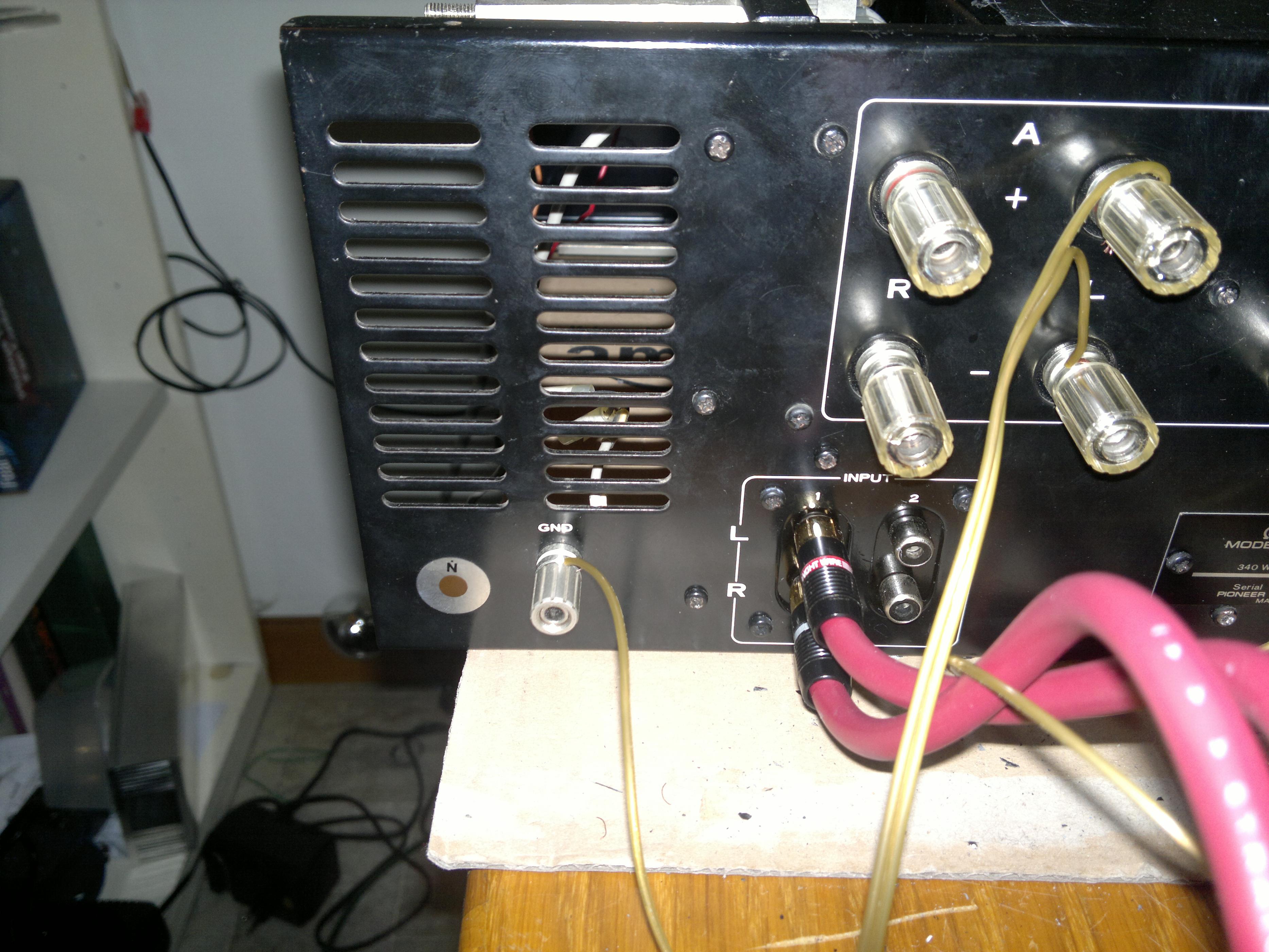

I put back D11-12, I added two o/p transistors and I regulated the bias to 22mv. After 30 minutes the value stabilized at 24.2mv, during this time the value regularly increased
Then I set VR2 to minimum (bias 1.8mv) and turn off the amp...
I removed the bulb and connected the amp directly, turn on... nothing happen (not even the meter turn on) I inserted again the bulb and the amp don't start, the bulb don't even light on
EDIT: the main fuse blow out, after checking I noticed that is rated 5A while it should be 6A. I hope the problem is just related to the old fuse, I will change all four just to be sure
