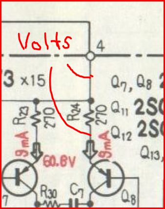

gde3... get it all back working with the bulb tester again. Lets be 100% sure all is OK
One other thing you can check is this (because I want to be absolutely sure everything is good to go 🙂)
Using the bulb tester and with VR2 on minimum again, measure and record the DC voltage across R24
Be extremely careful measuring as one slip would be a disaster
Now adjust VR2 as before to give around 22 millivolts between 9 and 13
Now measure and record the voltage across R24 again. It should be the same. If it is you can carry on with testing on full mains voltage. If it isn't then wait.
Return VR2 back to minimum and switch off.
Reason for doing that is to be absolutely sure that the rails aren't dropping to much under test with the bulb and causing the current in TR11 to fall.

2.613 DCV on R24 with VR2 at min an R1 at 0
With bias at 22mv DCV on R24 is 2.315
Should I continue the test without the bulb?
Yes you can try without the bulb. Start with RV2 on minimum as before.
Measure immediately the bias voltage after switching on and if it is higher than around 10mv switch off.
It's working perfectly 😀😀😀
