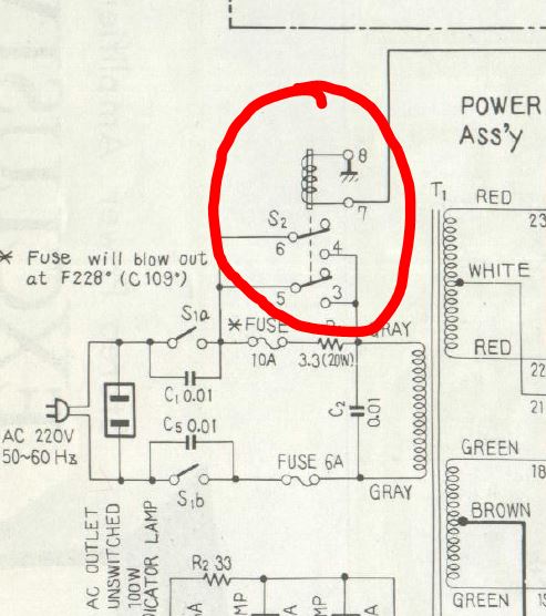

On the mains input there appears to be a relay (although its labelled as a switch). You need to confirm the operation of this is correct. This part of the circuit is a "slow start". If this wasn't working the amp would still actually work OK at lower levels but would be drawing all the power via the 3.3 ohm resistor.
So you need to confirm either by looking and watching or by listening that it clicks over correctly.

The relay is working fine, I can easily ear it when it turn on and I can see it from the multimeter

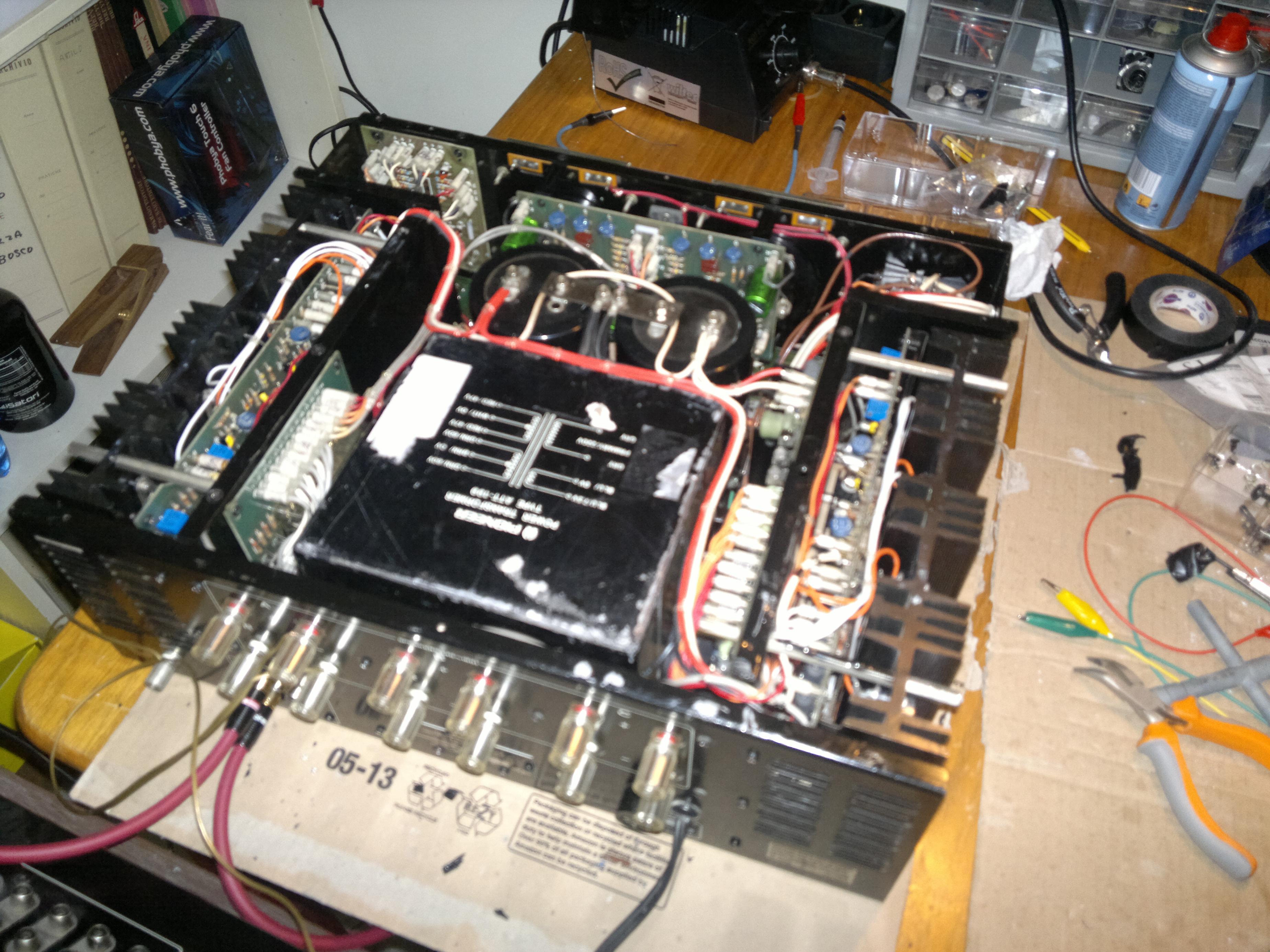

Unfortunately there's still a problem, I will open the amp and check the connections but the right channel is not working right (the one we have changed both drivers and o/p) it work with intermittence and a lot of distorsion, I hope the video could explain the situation
Difficult to say from the vidao but I see a lot of buttons under the VU meters, and these are presumably for signal routing, attenuation, subsonic filter etc. I would bet you have a contact problem somewhere in the switches or pots - while it's working give everything a 'wiggle', operate the switches, pots etc to see if anything changes.
My first guess would have been the speaker relay but I can see the left VY is not tracking the right one so the problem is not at the output - the input signal may not be getting to the amp board properly, I would check that before assuming the amp circuit is not working. If there was a real problem with the circuit it would likely result in the channel not working at all, DC offset etc, which would trip the protection circuits and you would not get a signal at all.

Now the amp work fine but I noticed a strange thing, the board with original transistors is really hot, can't touch it for more than 1-2 seconds, while the other is probably at 30°C

Something is not right if the board is that hot. Switch off while I read through everything you have posted.
Is it the board getting hot or the main heatsink ? If its the board can you tell approximately what area is hot.
The heatsink is hot, monstly the o/p transistors, the drivers seems a little colder
72 millivolts across 9 and 13.
That is to high. When the amp has cooled is the bias back to around 22 millivolts ?
And just confirm to be sure... this is the board with the original driver transistors. Yes ? And is the repaired channel with the new drivers behaving OK ?
