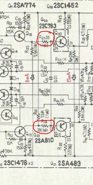

Remove these two resistors and then see if the bulb is out.
The bulb stayed on
Good
Refit those two resistors.

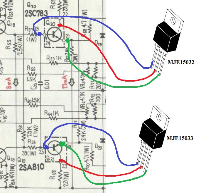

If you remove Q20 and Q21 from the PCB (the drivers) then the bulb should be off. Do that as a check.
What transistors did you order in the end as replacements for the drivers ? We can use MJE340 and 350 as a temporary measure for now.
I'll be back in a little while but don't rush ahead.

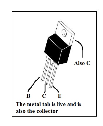

If the bulb is off when the drivers are removed then the next step is to replace both. An MJE340 for Q20 and an MJE350 for Q21 (unless you have something different). The pinouts for the MJE350 are the same as the MJE340.

Without the drivers the bulb stayed off
I have:
four MJE340
six MJE350
two MJE15032G
two MJE15033G
I made a stupid mistake, I inverted the driver transistors
Now the bulb stay low but voltage on R1 is -9mv, no matter how I regulate VR1-2 it's alway negative, also between pin 9 and 13 there is no voltage
Only two o/p transistors (in the right position eheheh), Q11 D6 and R1 shorted, no D11-12, all the rest in
