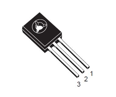

TR11, originally a 2SC281. Electrically, replacing this is straightforward. The problem is that whatever is fitted must be in thermal contact with the heatsink in the same way the original is.
Only you know what is possible by looking at the components. Could a flatpack T0126 device (as shown below) be fitted possibly by drilling the heatsink ?
If the original TR11 is OK (and a suitable device) then there is no problem reusing it.

Replacing the driver transistors will need some thought...
The 2SA1668 and 2S4382 (Sanken) could be possibles.
Whatever replacements are used will mean using a different device package and probably having to fit insulating washers although I think the Sanken devices above are full insulated (all plastic).

- a substitute for the 2SC281, one of the two hitachi was substituted in the past with an unkwnon one, who doesn't touch the heatsink correctly.
As I said before a flat one could be fitted easily and I prefer this solution, but I couldn't find either the 2SA1668 or the 2S4382

Q11 could be something like an MJE340. Any generic NPN is absolutely fine for a vbe multiplier. MJE340 and an insulating kit 🙂 sorted.
Drivers are going to be the problem. The old standby of MJE340 and MJE350 are just not really sufficiently rated current wise for supplying 3 pairs of outputs although they would work well and reliably for testing and getting the amp up and running. It would be at full power testing that they would be problematic.
