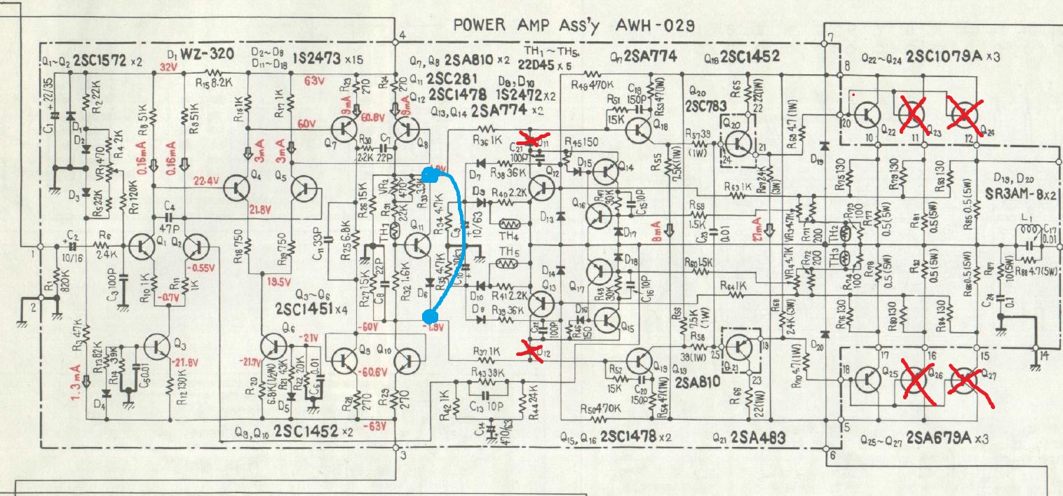

If all the PSU voltages are OK then we can move on to testing one channel. This is where you must not run ahead but must be methodical and careful.
Each channel uses 3 pairs of output transistors. We are going to build the amp using just ONE pair initially. The protection circuitry is going to be disabled and the vbe multiplier disabled to force the quiescent current to zero assuming there are no problems.
The circuit shows what to do. You link TR11 and D6 out as shown. D11 and D12 are removed. And you remove two of the three pairs of outputs, which ever pairs are easiest.
Measure the transistors first or better still, if the good channel has originals use a pair of those. Check the 0.5 ohm resistors that connect to the output transistors are OK (not open circuit or high in value)

That should be enough to be going on with. Make absolutely certain that you have the four supplies correctly wired and also the two grounds.
You can leave the input (pin 1) floating. It might be advisable to also link out (short) R1, the 820K to prevent any stray pickup and noise affecting things.
With the amp in this state the bulb should still be dim/out. The DC output voltage of the amp measured on L1 (extreme right of circuit) should be 0.00 volts give or take a few millivolts.

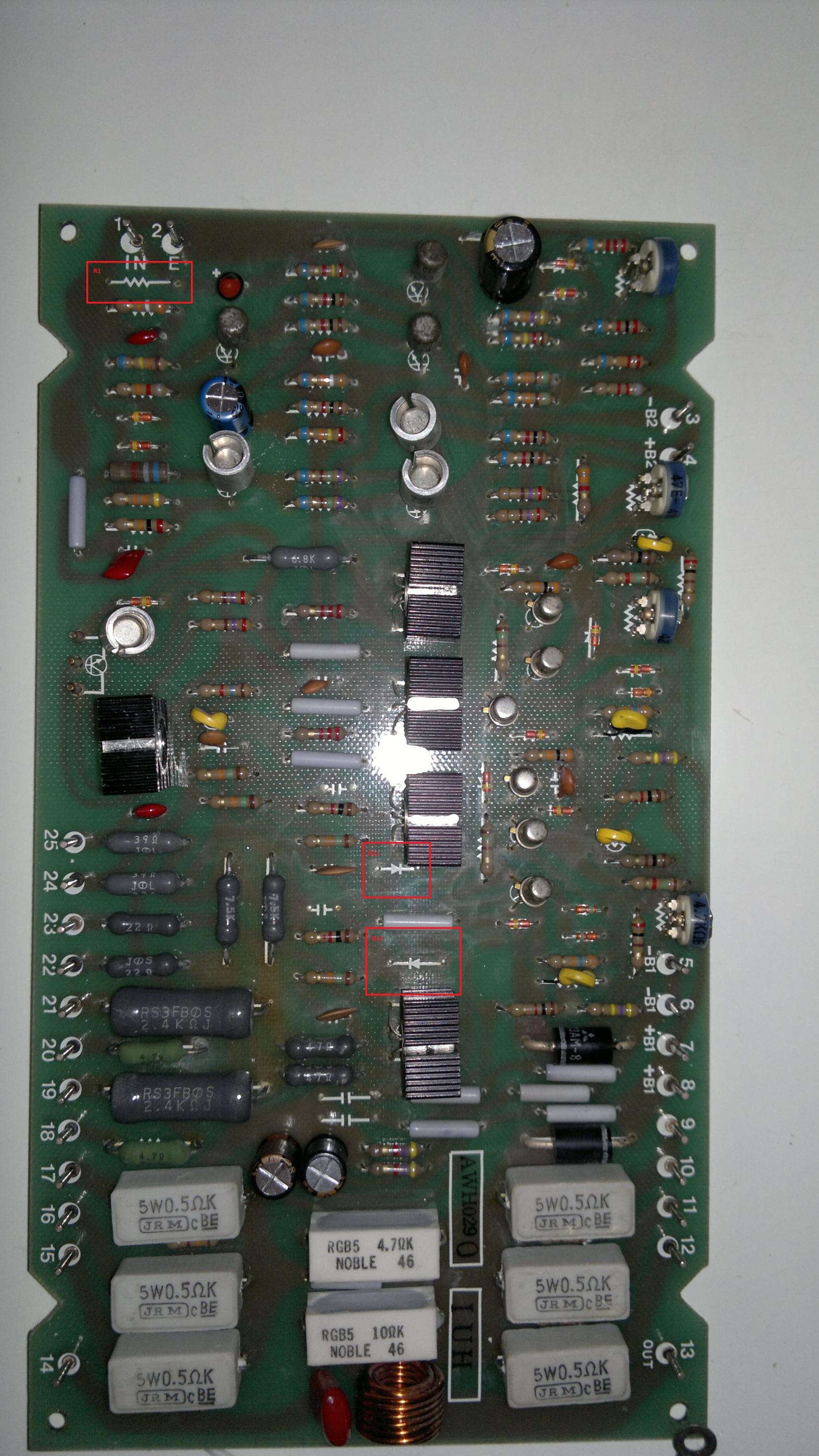

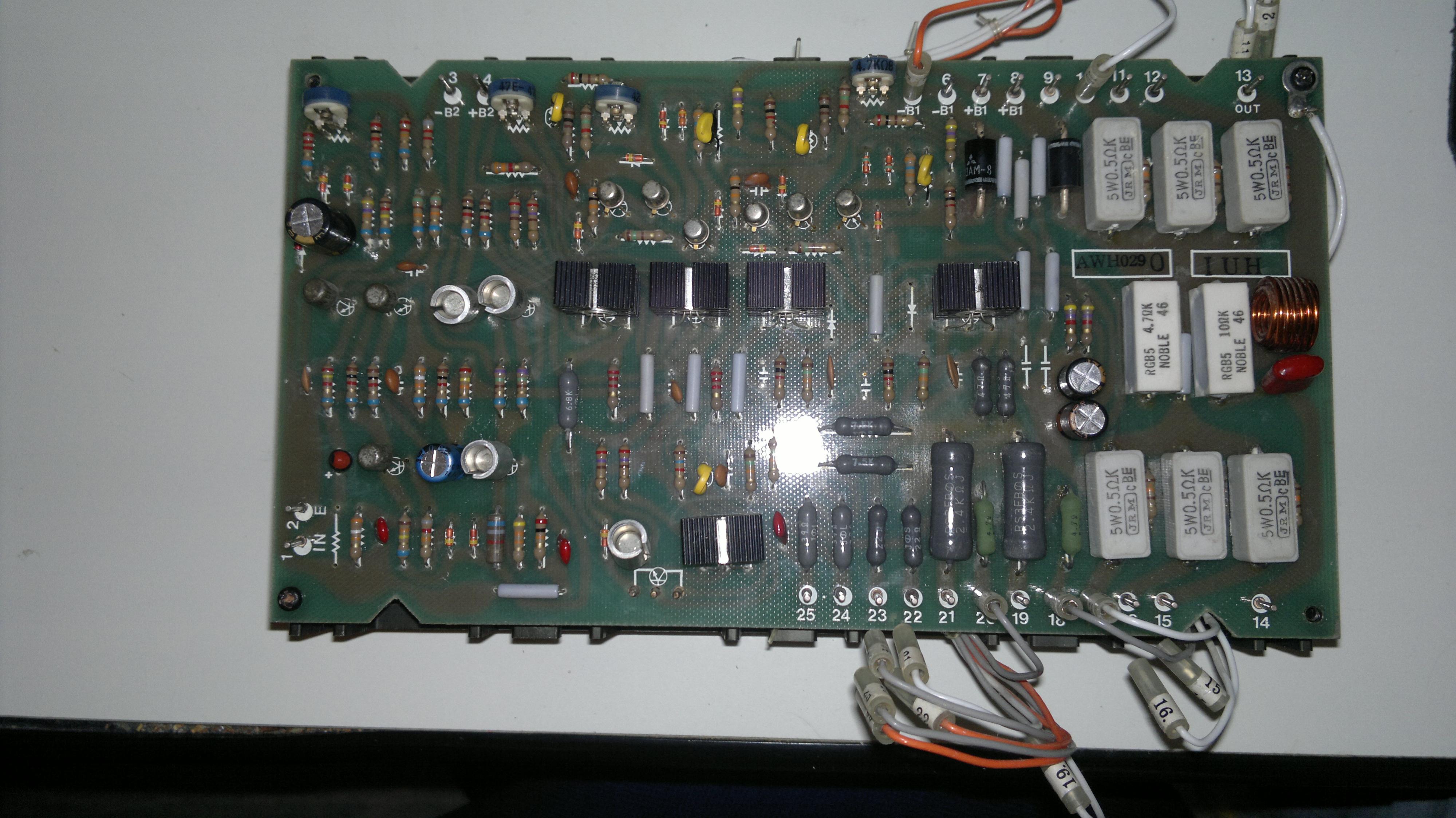

I tried to follow instructions, I'm not shure if I had to remove Q11 or not. Secondly I didn't understand where to measure L1.

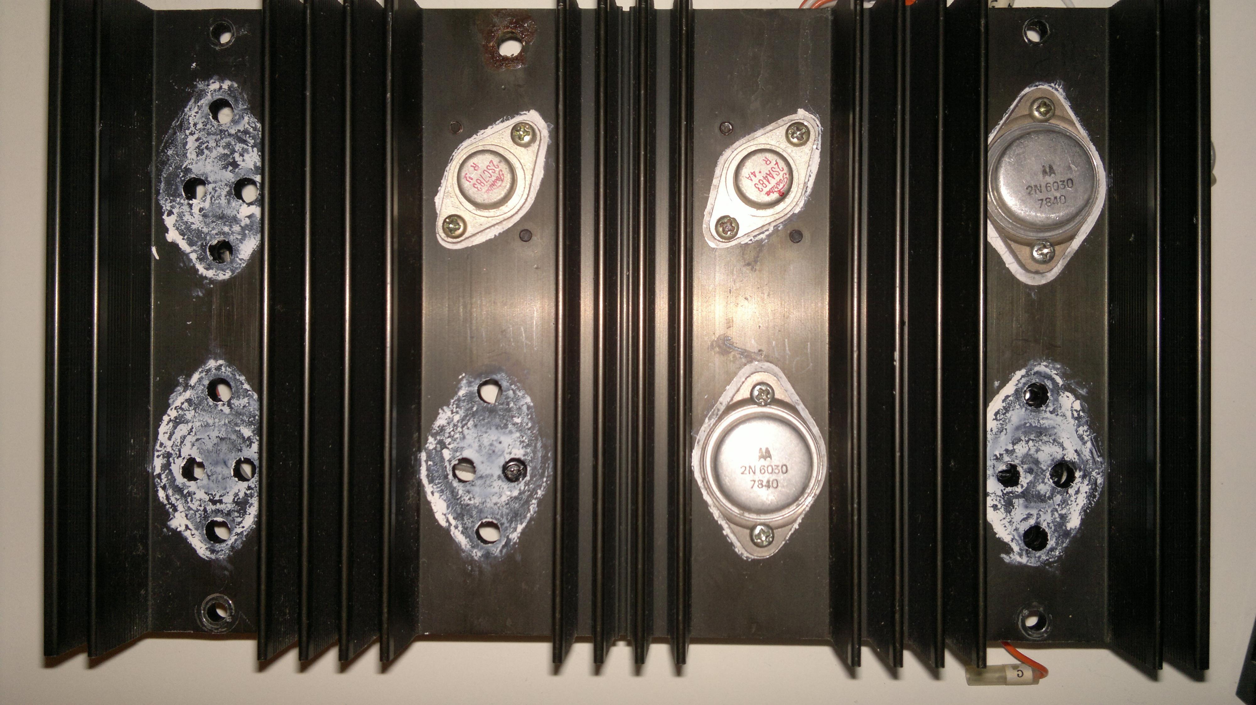

About the output transistors none is original so I will start with two motorola 2N6030 since they seem in better condition.
One more question how do I measure if the transistors are working right?
You've only got one side of transistors there. You need one transistor in the LEFT hand socket, and one in the RIGHT hand.
Can you list what transistors are installed on the big heatsinks? Let's see if you've got anything decent in the set to try with...
2x 2N6030 motorola
2x 2SA679 toshiba maybe original
4x 2N3442
2x 2SC1116 sanken
2X BDW52B
