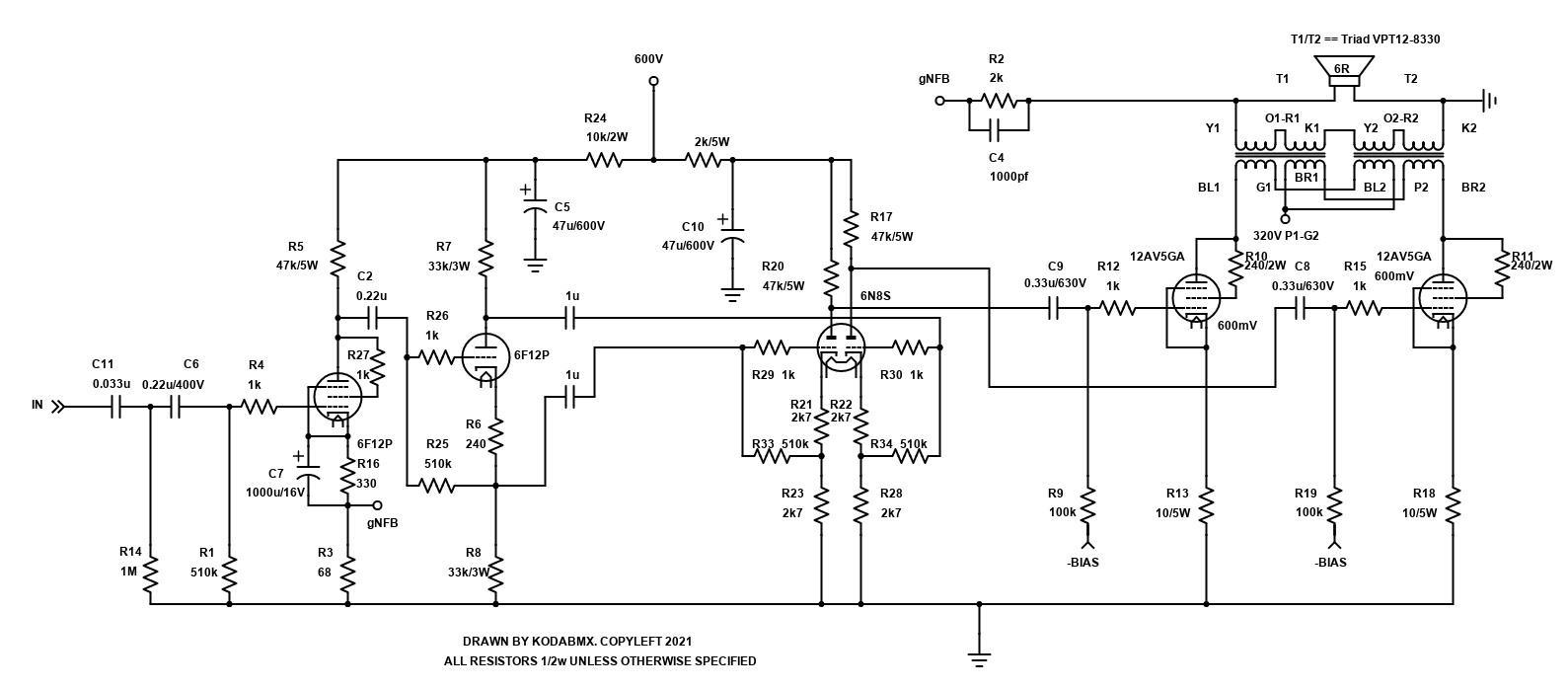

For the circuit in #80, the time constants C1, R23 & C5, R29 are to close to each other. If NFB were used there is danger of LF instability. For a long tailed phase invertor the relation Rk ( mu +1 ) >> rp + Rl must be satisfied. This one barely makes it, but R21 has been made slightly larger to help that. A CC in the tail would be a better fix. There is no cap between the input jack & the first grid. A drop of 25V across only half of the OPT winding with a plate current of 50 mA indicates 500R. That is very large, eeven a low cost replacement OPT would do better.
All these points make me wonder if the circuit was ever built.

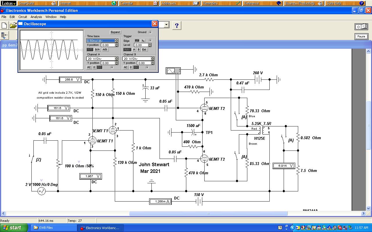

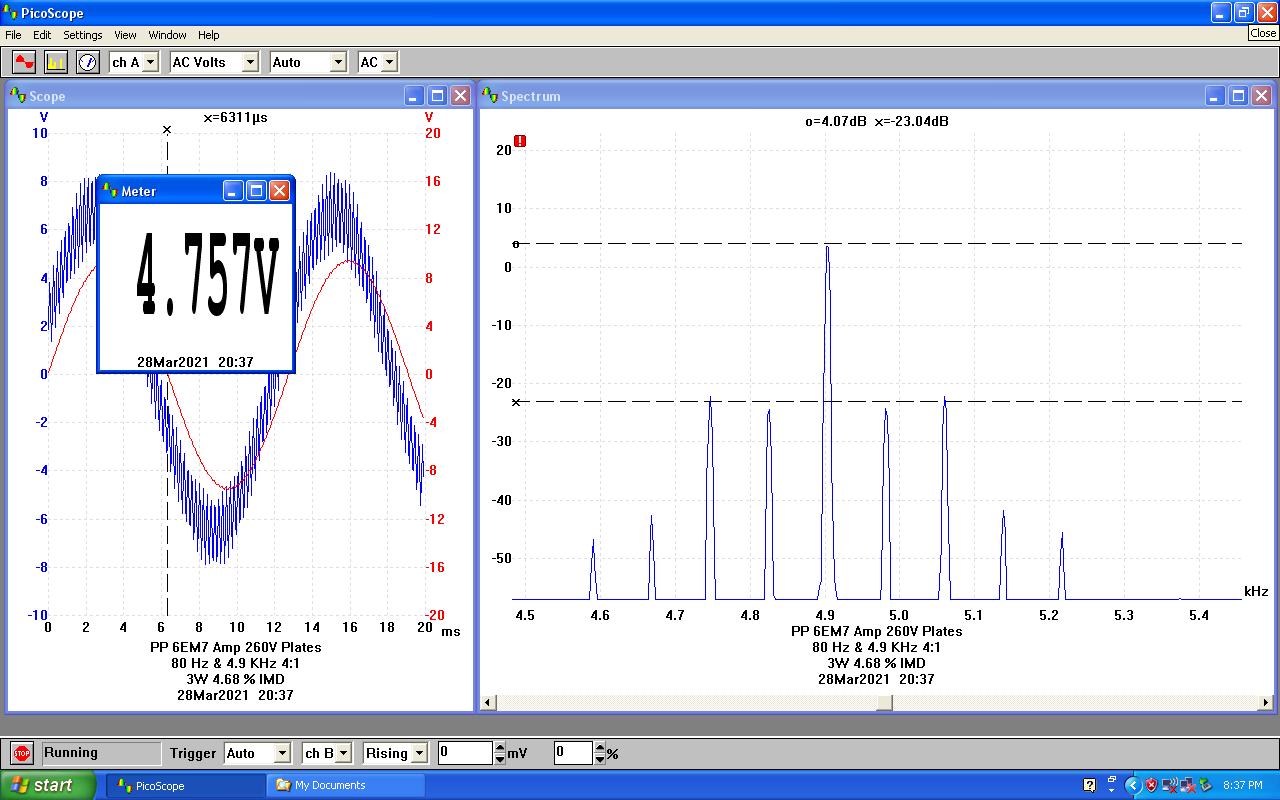

I've had something similar running on & off the bench for about a year. An honest 7W at clipping in Class A PP without exceeding plate dissipation. The 6EM7 dissimilar triode has about the same plate dissipation as the 6AV5. But includes another high mu triode for a voltage amplifier. Connected as a differential stage here with a 120K tail to -150V, results in a very good phase splitter. Still needs a front end. The spectrum shews SMPTE Intermediation Distortion at 3W,

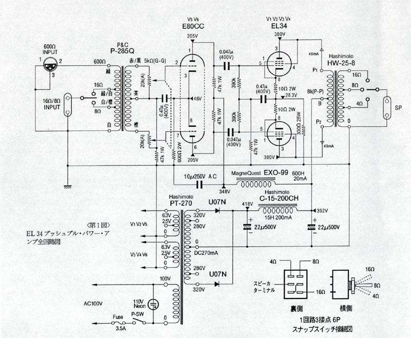

I have gravitated towards this circuit to base the amplifier on. I have a couple of signal transformers that ought to work for the input phase splitter.
http://www.tube-amps.net/EA_Hashimoto_EL34_PP_NNFB_02.htm
I have similar enough iron, and some 12BH7s etc. I have the intention of making "tube rolling friendly" for the small tube (adjustable current source for the input differential pair?), and probably fixed bias for the output tubes.
