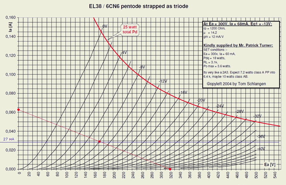

Second choice would be EL38. I have plenty if you PM me - I'm in London. I spent all of 2020 building prototype SE amps with pentode tubes in triode, and EL38 was easily the best sounding. I have a few different types including some rare ones. These have a top cap if that's OK.

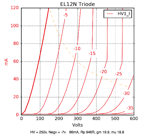

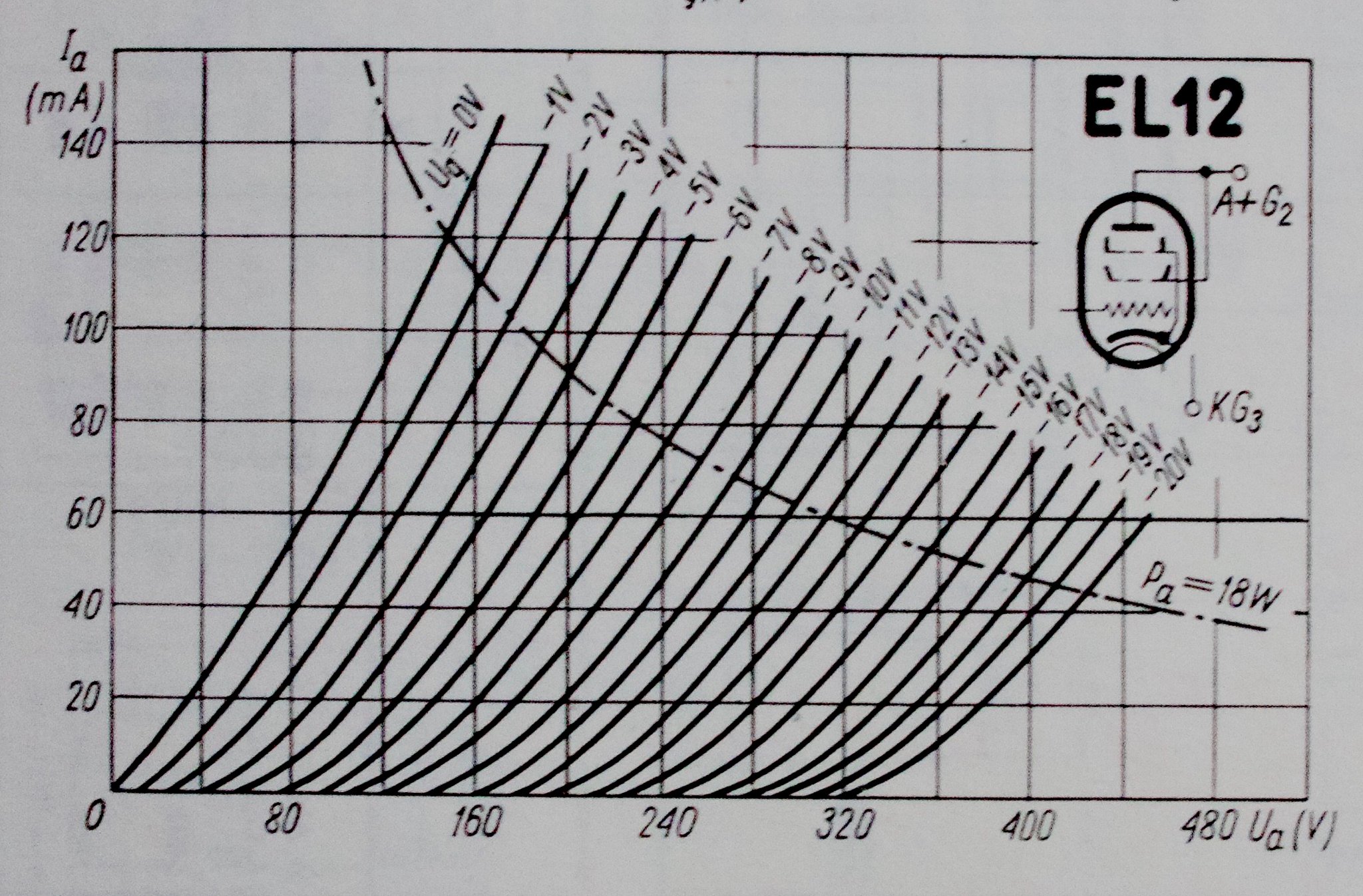

Third choice, again from my 2020 experiments, was the EL12 which was second only to the EL38. Hot tip is the EL12n which has no top cap and is available new from a few European dealers. Again, I have stocks of unused ones including a matched quad. These are good value tubes. I also have several of the regular EL12 and EL12 Spez.

Here are the triode curves for EL38, EL12n and EL12. Very good sounding tubes, these. The EL12 was much used and valued in Europe. I slightly prefer the EL38 but it's close.
EL38 is around £20 each used for Mullards. I did a big shootout and it sounded better than the EL34s I had in triode. How cheap do you want to go? There's always PL38 of course - that's cheaper.
