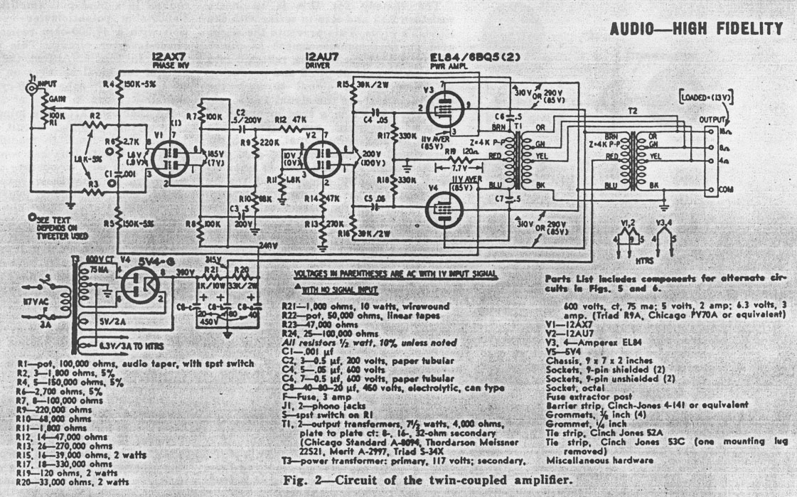

The halved impedances shew up on his schematic. I pulled up the article, Crowhurst comments on it there too.

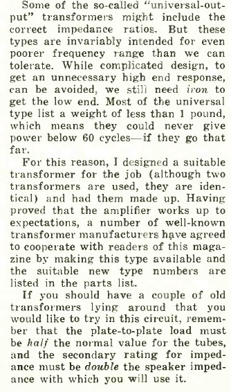

And Crowhurst's comments on his purpose built OPTs

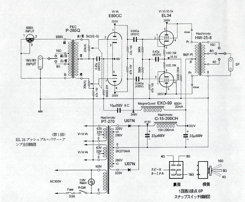

I have gravitated towards this circuit to base the amplifier on. I have a couple of signal transformers that ought to work for the input phase splitter.
http://www.tube-amps.net/EA_Hashimoto_EL34_PP_NNFB_02.htm
I have similar enough iron, and some 12BH7s etc. I have the intention of making "tube rolling friendly" for the small tube (adjustable current source for the input differential pair?), and probably fixed bias for the output tubes.

Note: Your schematic is obscured by some other image on top.
