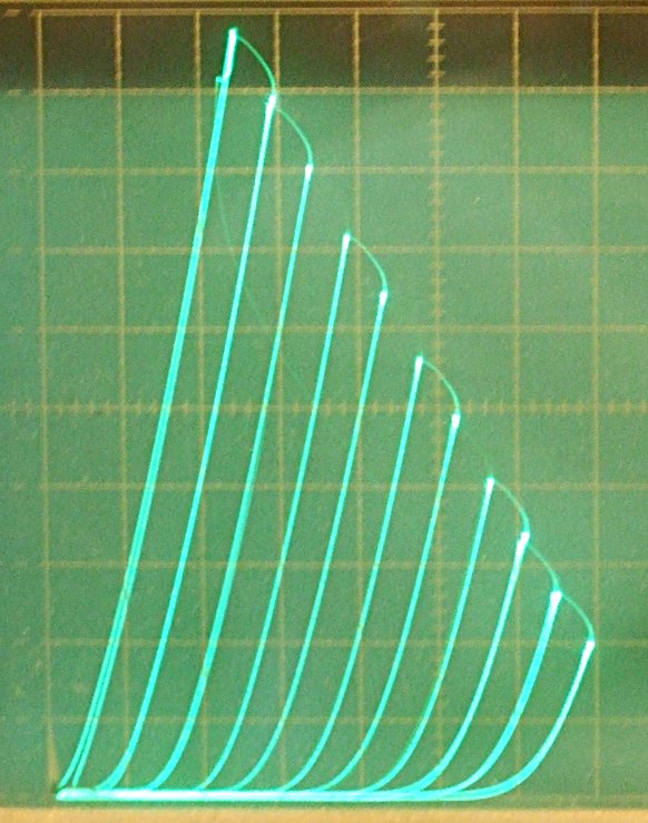

I do see a difference in the pin-out diagrams between the two. I checked the JJ KT77 here and they are beamers as they are supposed to be. The triode curves on the curve tracer here look like the ones shown. Which aren't too bad. The KT77 triode curves are what attracted me to get some to trace .
Here is another source indicating not the greatest triode curves for the EL34.
http://www.dissident-audio.com/Yves/EL34-Trioded.gif Looks like it came from a datasheet, and it looks to agree with the earlier Audiomatica EL34 curves (different vertical current scales).
The JJ KT77 curves I see on the curve tracer here agree with the earlier Audiomatica KT77 curves. The kind of triode curves I like for $19.
Although certainly not up to 300B or 2A3 curves. $$$

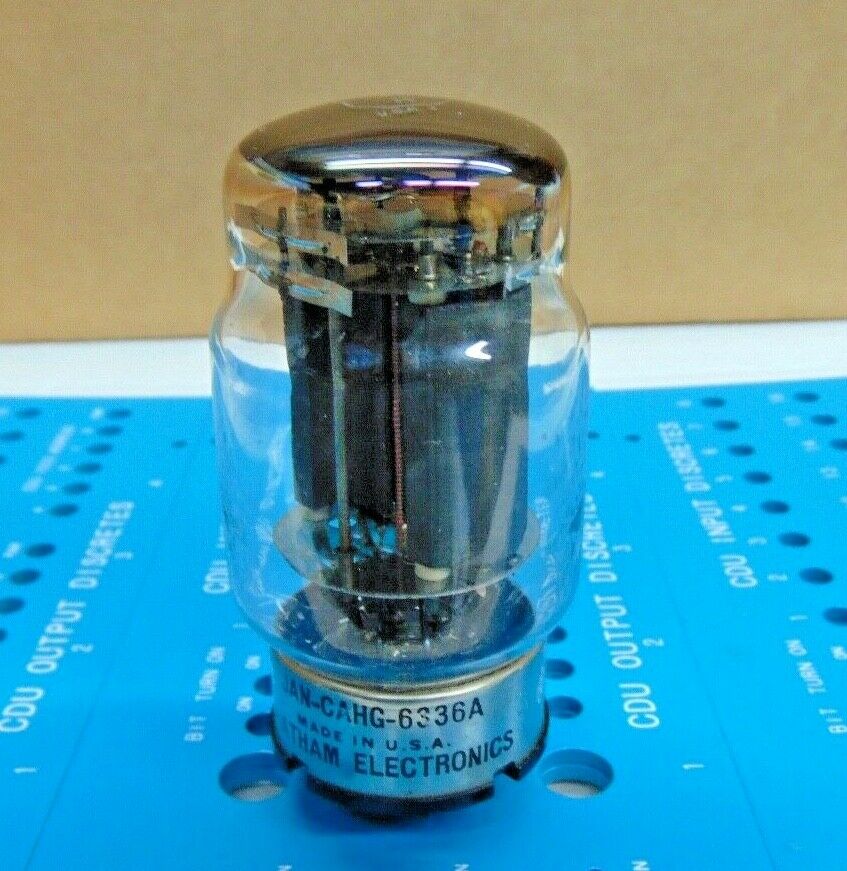

6336A I love that tube. ordered one (£65 all in) on ebay from the states, it made it halfway across the country and then made its way back to the seller. full refund offered no explanation, but I got the feeling I was trying to export some thing that I shouldn't.

Weird about the 6336A shipping problem. Maybe the seller wrote "JAN xxxx" in big letters on the box or shipping label. Can't imagine an old V Reg. tube being an issue though. I plan to try one out in the tube emulator scheme, give it near perfect 12HL7 curves. Turn it into a low Voltage, high current 211.

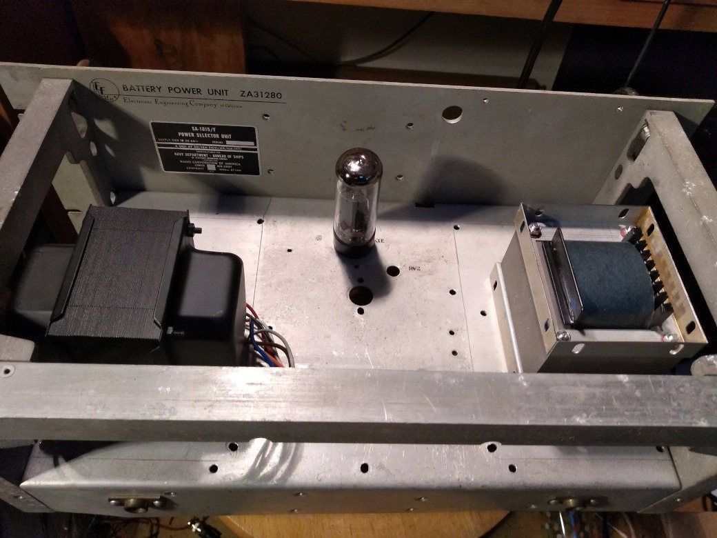

Am thinking about output transformers now (for those that may have missed it, I am going to use KT77s), and a very happy thing has happened 🙂 🙂 🙂 it is fairly safe to assume what I will be building is in effect a triode wired EL34 push pull amplifier, not that revolutionary, and almost 100 years of prior art to plunder.
Even more exciting EL34 data sheet suggests 430v and a 10 k anode to anode TX in triode mode for 14W and less than 1% distortion. this sounds thoroughly worthy, low distortion is a fetish of mine at the moment.
http://www.r-type.org/pdfs/el34.pdf
I even better I have a 20 watt el84 transformer, as well as the one pictured above which will be lower z, in my stash, so am pretty confident to start cutting holes 🙂

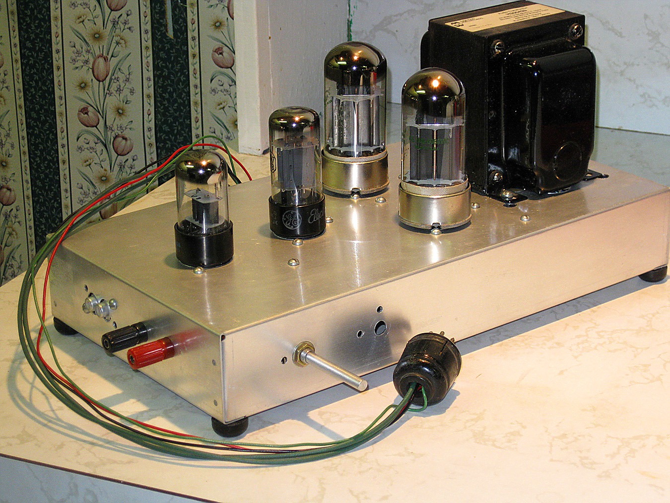

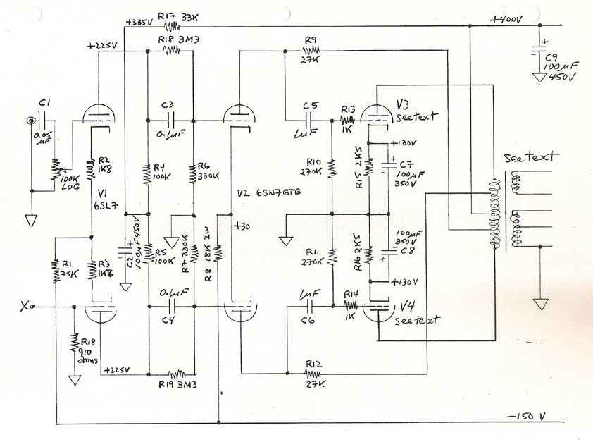

A pair of 6080's using cathode bias on each tube is good for 25W.
