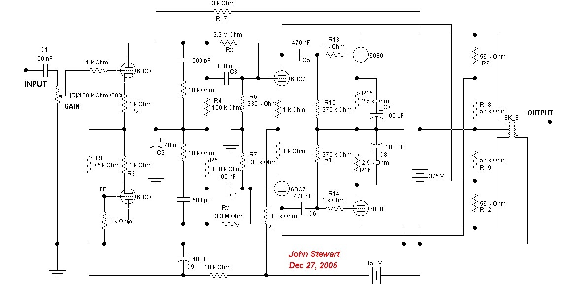

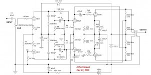

Although post #39 is about the Brook 10C, still a warning about the schematic of the Brook 12A: The polarity of C3 is wrong and the filaments of the 2A3's are not grounded.
What would be a good OPT for that amp?A pair of 6080's using cathode bias on each tube is good for 25W.

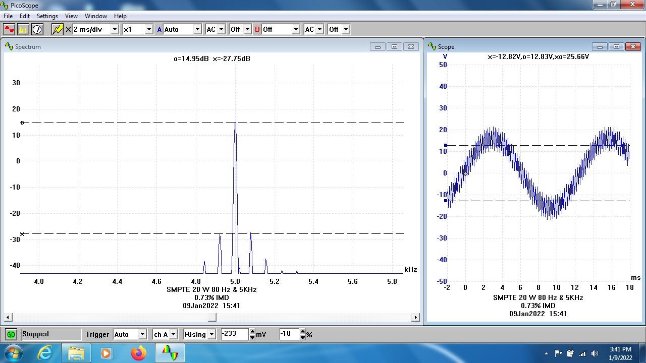

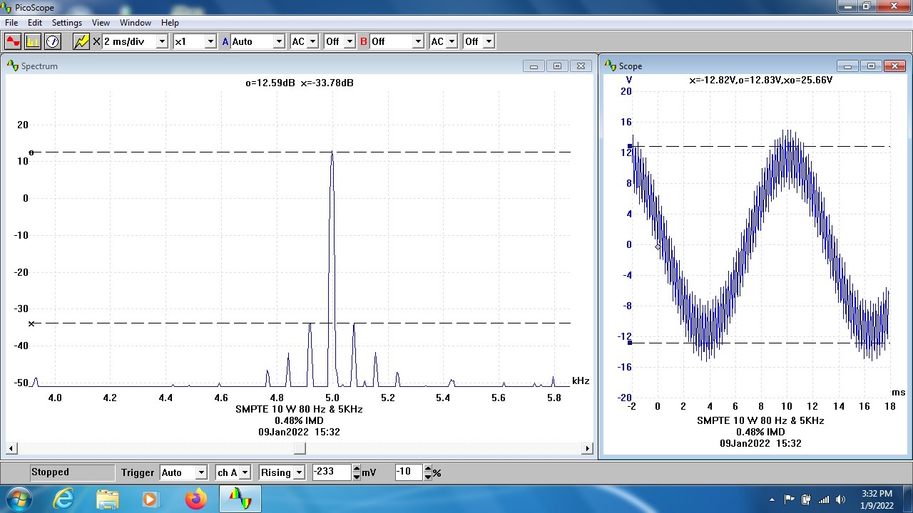

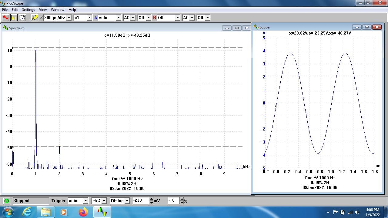

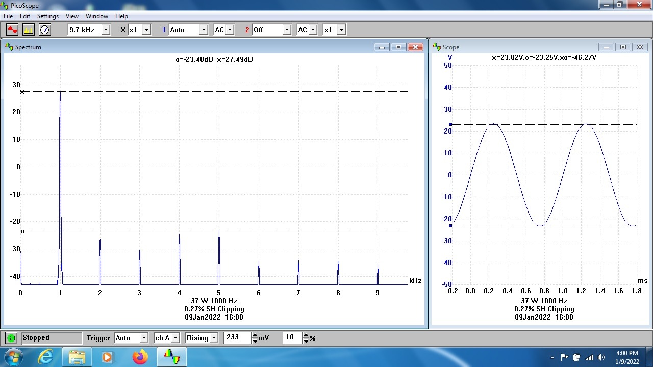

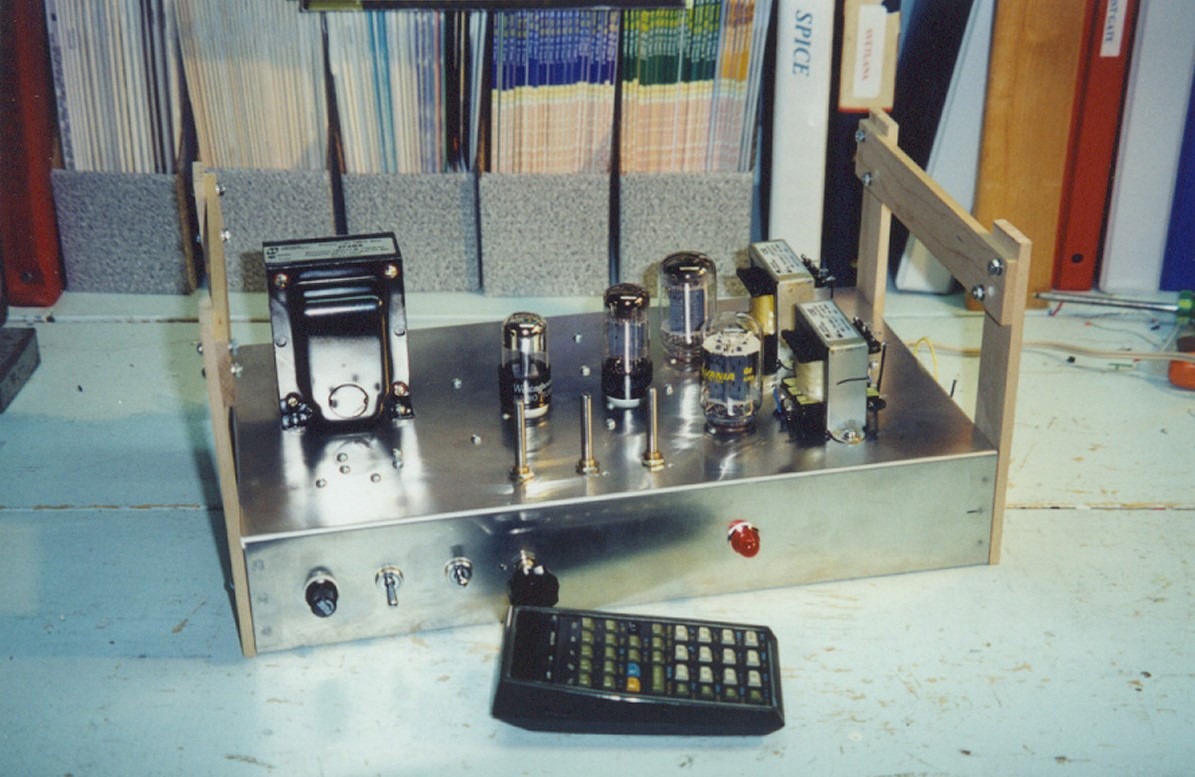

As it happens my vers of Crowhurst's Twin Coupled Amp has been on the test bench for the last couple of weeks. When I get a chance from pushing snow & fixing things around the place I fire it up & do some tests. So attached are some of the results.You can also use two "OT" xfmrs in the Norman Crowhurst "Twin Coupled" arrangement, to get doubled primary voltage, inductance and power. With the 50% CFB you get with that scheme, any V reg. tubes (6080, 6AS7, 5998, 7236, 6336, 6528... ) will shine like 300Bs, from the inherent high linearity mode. (which V reg tubes aren't generally known for, although P-P helps a lot) ( I would suggest using the high gm 6528A for CFB mode, to keep the drive voltage reasonable )
This project was published Aug 2004 in AudioXpress magazine. And many times here on this forum.
Everything is 'off the shelf'. No boutique parts at all. The OPTs are Hammond 125E Universals. And CF driven PP 6LU8s.
The OPTs are a limiting factor, I had to series the secondaries. Purpose built OPTs would fix that as it did for Crowhurst.

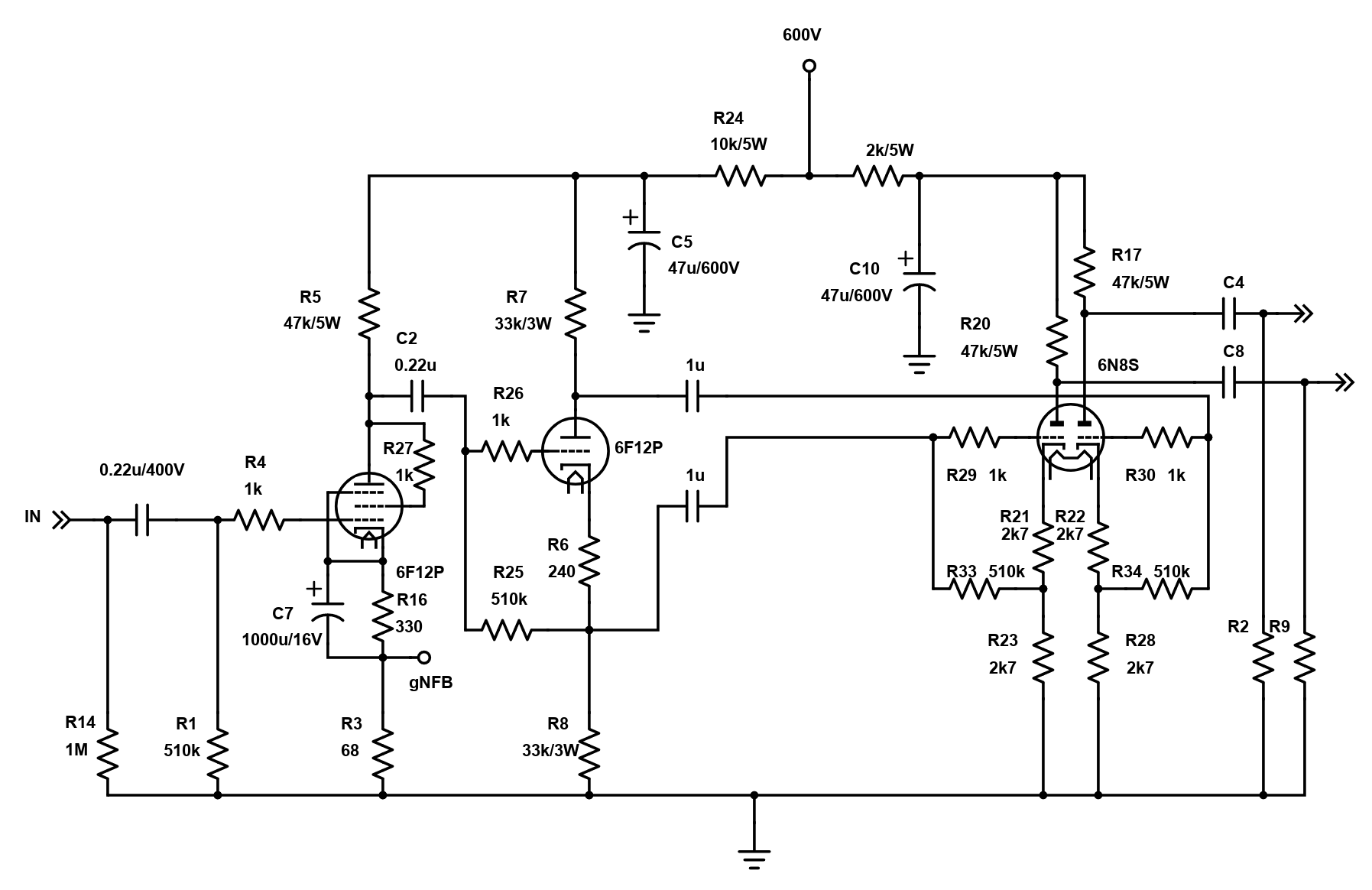

That all depends on voltages. If you use a 300V B+ you'll have crap bass. If you use 150V B+ it'll be fine. Also I have a driver that swings enough to drive it a cathode follower - and berfore you say "but where do I get 600V?" a quadrupler off 120V or a doubler from 230V... A tripler from 120V gets you close enough, too... Also the 47uF/600V cap is B43541B8476M000 from TDK but you could use a series pair... I redesigned my boards to use a pair to avoid a single source part.It'd work, buy you'll have crap LF power.

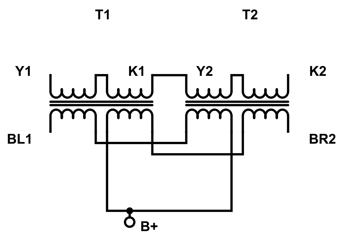

Edcor offers a 25 Watt 1.6K to 16 Ohm OT now. Using 2 of them for the Crowhurst Twin gives you a 50 Watt 3.2K to 8 Ohm composite OT (secondaries paralleled). Unfortunately, their prices seem to have shot through the roof lately. $92 for one of them!

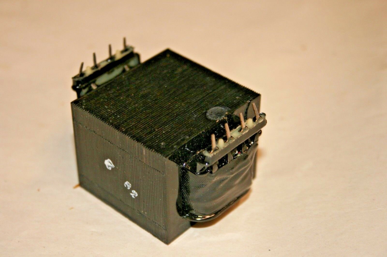

I'm going to have to start thinking about some clever work-arounds for OTs now too. I have a bunch of Signal Transformer 24 Watt DPC-xxx transformers
115V/115V to 60V/60V,
115V/115V to 20V/20V,
115V/115V to 8V/8V and
115V/115V to 6.3V/6.3V
that I got off Ebay years ago for cheap. Layer wound with good insulation from primaries to secondaries. The 115V/115V to 60V/60V could be used in reverse for B+. Circlotron mode allows any number of xfmrs to be series'd to get higher voltage windings, without huge distributed capacitance problems developing..
