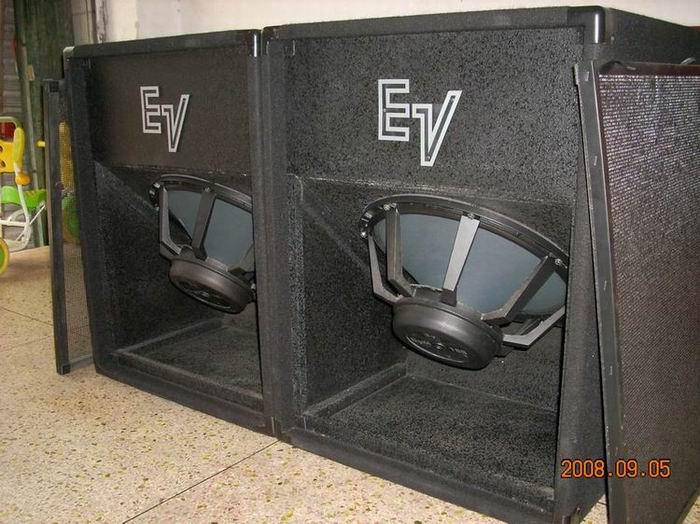

You gotta 4018LF in one box.
I gotta SI HT 18 in one box.
The box is a TL 505.
I would like low E bass guitar up to my available x-over (125Hz) in my cab. Yep.
One 18" mono subwoofer
Blend in with my TL 12's
Is this the way to go, all things considered? I find the purchase price of the SI HT 18 very attractive compared to others that offer similar spec's. The SI drivers are designed here in the USA then sent to the low bidder in China. Did you know China has better forgings than US?

The SI HT 18 should be capable of a lot more LF than the 4018LF, but the upper response around the crossover point may not sound as good. It is a hell of a deal for that amount of Xmax, but the TL 505 ports are way undersized for that much excursion.
The 4018LF is also a lot more sensitive, so you wouldn't need as much power on average.
There are advantages to each, but for the price, looks like the SI HT 18 would be a better choice for you.

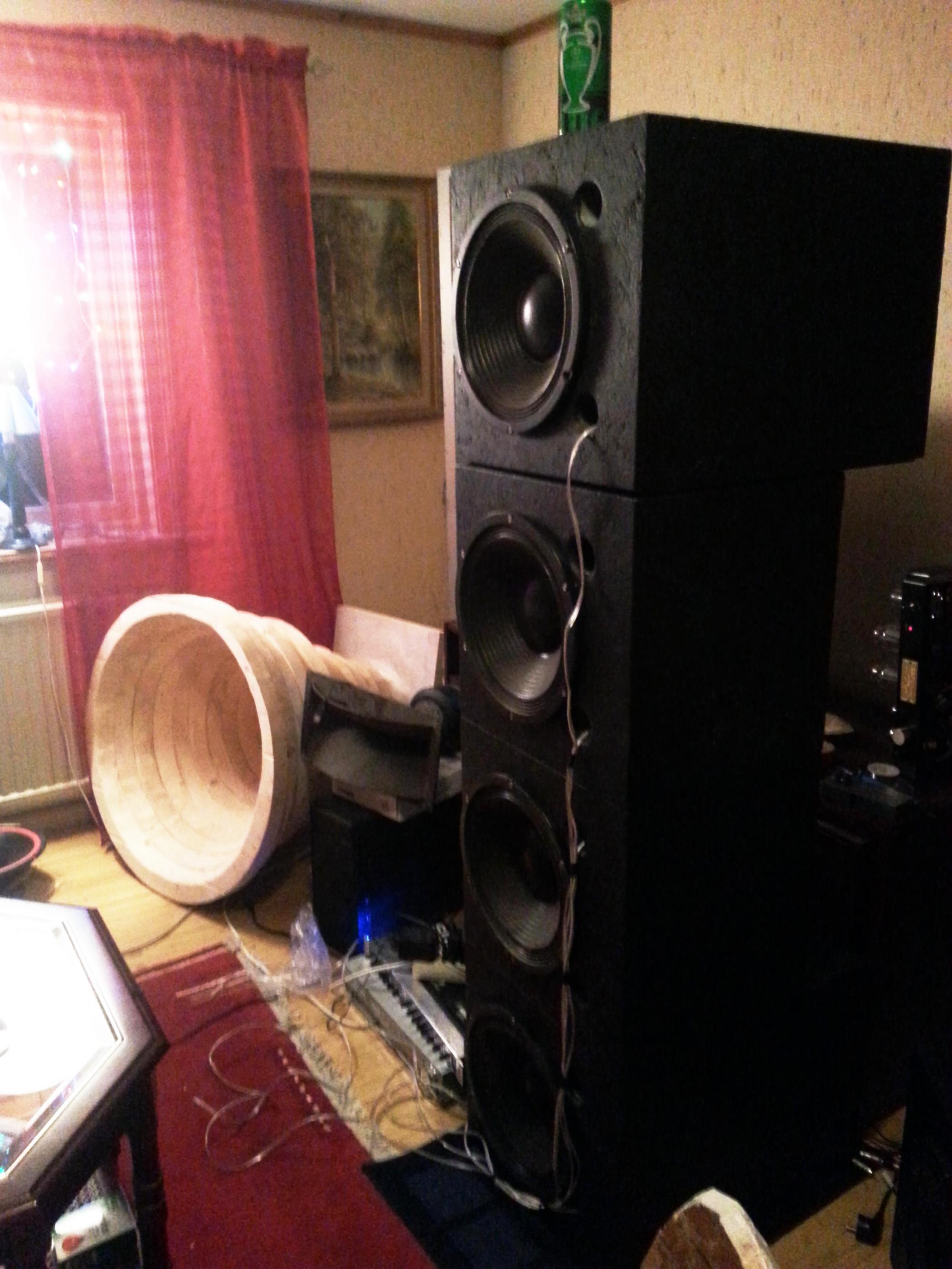

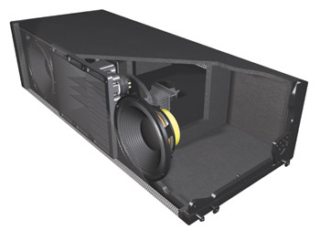

Last night I finished my latest project, a Meyer Milo replica midbass array that will let me lower my sub to below 70Hz. Great exercise, I woke up today sore all over.
Approved by Metallica!

Very cool story about Metallica. Will check the Kill Em All album after someone named Al. If you are lucky there will be at least one.
I have been messing around a lot with horns and although they are fantastic and so detailed with a very fast attack, they miss the fullness of a midbass cabinet. Horns alone are really just good for ridiculous nonsene-jazz, or "fjantig tramsjazz", as we call it in Sweden.
Tonight was the first time I have been able to enjoy metal for a while, thanks to the Meyer Milo replicas. I have them hooked on to a 5 watt 2A3 tube amp, which must be getting rather warm by now, because the sound is magical. The original cabinet has a 4000 watt amp. Not sure what they use the rest of the 3995 watt for. Oh, yeah, Metallica need 138dB! Ofc...
The midbass tower dwarf everything in the room, even the 1 meter mouth horns. My sub is the 12" I mentioned earlier, the Eminence LAB12 in a sealed cab. It was plenty yesterday, but now it it looks and sound puny. I will put it in a basshorn and see what happens. I have straightened out a Labhorn in a round frontloaded horn. That will be interesting to hear. I haven't had time to hook it up. To busy studying to become a heart researcher, or at least something within medical research.
I may jump on your 18" sub. Make a good design and I will replicate yours as well. "Resistance is futile. I will add your heavy metal subwoofer's technological distinctiveness to my own." It will make a nice addition next to my Metallica speakers. 😛 My ridiculous nonsene-jazz-horns are in need of a double dose of testosterone - STAT!

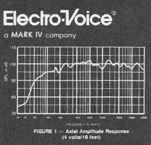

Al,I've narrowed my search down to two candidates. The tried and true block buster EV 505 Theile cab, or the yet to be refined SH 1810-ER. Bass reflex vs. short horn. I plan to load either with the deal of the century SI HT 18.
Unfortunately, nether of those cabs will work very well with the SI HT 18.
The stub horn is already "off the pipe" (-6 dB) at 50 Hz, and response goes way south from there. You could put the full output of your PL700 in, all you will hear down low is flapping and clacking from the loose SI HT 18 suspension and voice coil hitting the back plate.
With a BR you could tune the box low enough to get keep the flapping under control or stuff socks in the ports to keep the driver from unloading.
Have fun, keep on trukkin'!
Art
Stuff socks in the ports? You are a man after my own heart. Thought I was the only one that does that. The dirty ones smell beter down low. You could call me a dirty cotton sock cutter.
Art, thanks once again for crushing my dreams. LOL
