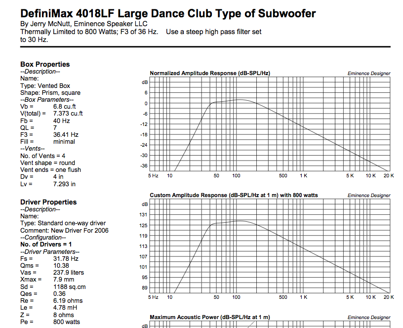

But to support your speaker quest, you need to hone in on a few basics, you started out wanting a ported 18", then you have gone off the rails.
1)Are you thinking of bridging the PL700? An 8 ohm load in that case presents the amp with the same load as two four ohm loads. The amp can handle 4 ohms per side (or bridge mono 8) if fan cooled.
2)Do you want one or two 8 ohm 18?
3)What price range?
4)What size is acceptable? Decent quality plywood is not cheap anymore, though you can often find empty cabinets for less than the cost of wood.
5)What sound level you want to achieve at various frequencies at what listening distance?

Actually, the first three lines of my original post: "I want to build an 18" mono sub and need advice. Not even sure what cabinet alignment to start with. I am leaning toward at least a bass reflex or maybe a scoop". I failed to mention I need to keep it small as possible so I can move it around. That's why those short horns caught my eye. I think a full scoop as well as a keystone would be too large.
1) Mind reader! That's exactly what I was planing. Bridging my Phase Linear 700 with an 8ohm 18" speaker. Are you saying the out-put would be the same as stereo 4 ohm (as in a dvc 4 ohm speaker)?
2) Yes, mono 8 ohm 18" single driver.
3) Hopefully around $200 or a little more. You know, that mule thing.
4) Smaller the better.
5) I would like to blend in with my Theile 12's @ 10~20 feet.

1) Yes, bridged mono at 8 ohms the output is the same as two channels each with a four ohm load. In either case, fan the amp to keep it cool if you are going to try to get full tilt output. The Blue Light 700s could do an honest 700 watts per side at 4 ohms, the series II might peak around that, which would be 1400 watts bridged mono at 8 ohms. Don't hang less than 8 ohms on it bridged, even with fans.1) Mind reader! That's exactly what I was planing. Bridging my Phase Linear 700 with an 8ohm 18" speaker. Are you saying the out-put would be the same as stereo 4 ohm (as in a dvc 4 ohm speaker)?
2) If you insist, though two 12" may have more output and less power compression.
3) Probably a little more if you want good quality.
4) Smaller speakers in general perform better in smaller enclosures than larger speakers.
5) Your pair of TL 12 boxes can probably do around 123 dB max around 100 Hz at around 200 watts per. Given around 700 watts, a box like the WS Lab 2x12" or a DefiniMax 4018LF can do about 124 dB. At four meters (about 13 feet) the level would be around 112 dB.
The 4018LF at about $260 is a better deal than a pair of Lab 12" at $350, but the Lab 12" would go a bit lower in a slightly smaller box.

I really would like to build an 18" mono subwoofer to match my EV TL 12's. I am not very interested in being talked out of my desires. I would rather have support in the fact that I know what I want, not sure how to get there. Know what I mean?
OK, the TL12 is rated 93 dB/65 Hz, rising to 97 dB/100 Hz and the Definimax 4018LF calculates 95 dB/1 kHz, so should dovetail in somewhere around an 80 Hz XO point.
With a 32 Hz Fs though, going infrasonic in a simple ported cab will heavily roll off lower down if there’s not enough room gain plus dual drivers will ideally be required. Size wise, figure at least a Vb = Vas per driver and Fb = Fs or tuned lower if there’s some room gain.

Are you aware of the step down option for the TL12? It would provide output down to 43 hz instead of the standard 60hz.
The lowest setting on my old Pioneer SF-850 active is 125Hz. Wish I could go deeper, say 80Hz. The TL 12's go lower, I know. I hate to cross over right in the middle of my beloved metal bass. I am fixed at 125Hz x-over due to my 1980's theme.
The 18" EV Thiele 505 box looks good size wise at 2'Wx2.5"H. I can put wheels on it so I can move it about with my disability.
Loaded with an EVM 18B, looks like the response and SPL would blend in well with my TL 12's.
I would like to know if I loaded this box with a SI HT 18? Would I destroy it or better it?

Al,The 18" EV Thiele 505 box looks good size wise at 2'Wx2.5"H. I can put wheels on it so I can move it about with my disability.
The EV18B has only 3.3mm Xmax (linear excursion), the Eminence 4018LF has 7.9mm.
Doubling excursion gives 6 dB more output. There is no replacement for displacement, you would need more than two EV18B in two TL 505 boxes to equal one 4018LF in one box.
The EV18B will run out of Xmax at around 200 watts and start flapping uselessly if given more power (and may burn up or destroy the voice coil hammering on the back plate), while the 4018LF would provide clean output up to 800 watts, and at least 7 dB more output.
At 40 Hz, a 7 dB SPL increase or decrease happens to sound twice or half as loud.
