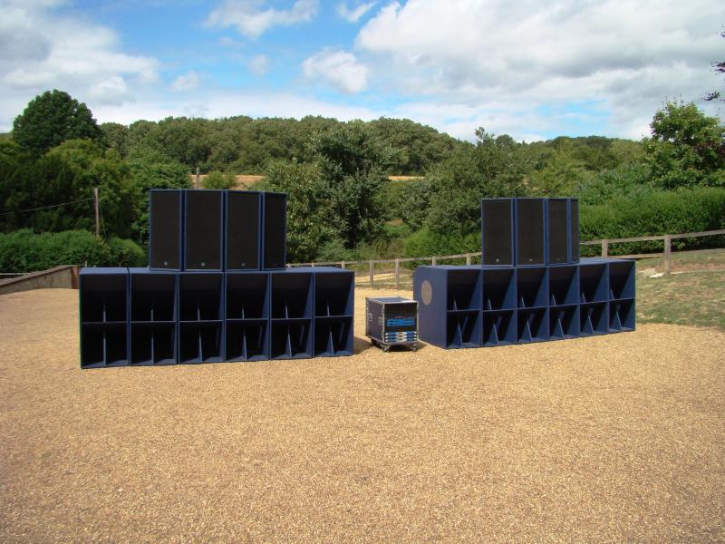

If you are lost for ideas then a dude in Sweden called Bernt (part of the No Frills Audio group) has an interesting bass. He has two 18sound 21" in a large closed box that he calls Barabas. It should not be hard to guess which 21" it was. He tested it in the garage at full blast at 10Hz and everything started moving and he got groggy so he turned it off. It weighs 100kg. Powered by a 2000W hypex Ucd2k. He crosses them at 73Hz 18dB upwards and 30dB downwards.
Here's the dirt cheap way out:
Rear-loaded subs have a bad reputation among the DIYers I have asked. If building a horn why not seal the back chamber like in the labhorn? Or just go for a box with or without ports.
With a labhorn they say you need at least six of them for some reason. Must be the case for rearloaded as well. One should never just build one pair of labhorns, they say.

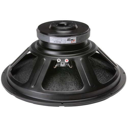

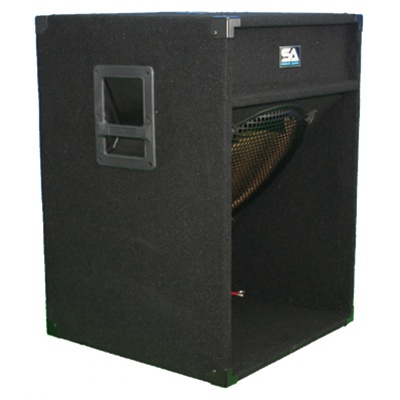

The empty 18 box is $170 shipped free. Ad in the $100 Dayton and you got a dirt cheap 18" sub bin for under $300.

I found materials for my subwoofer behind the woodshop in their recycling container. 2" thick MDF. 😀 Total cost: $170 for the Lab12 driver.

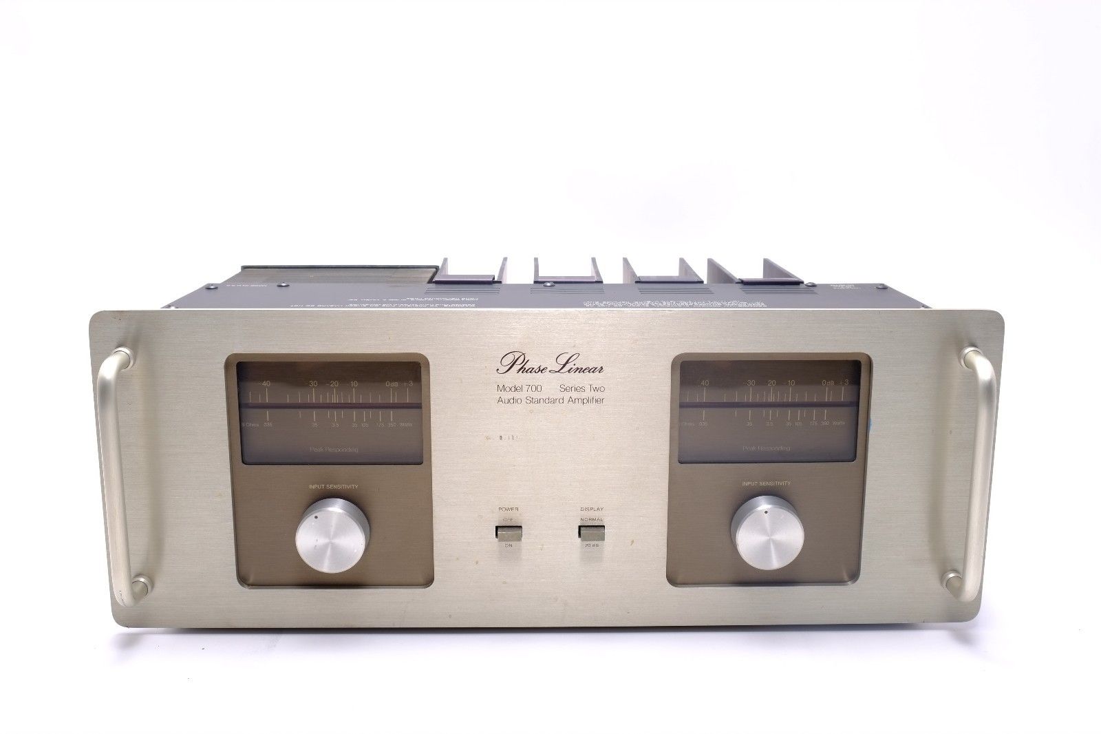

then I bumped into an old Friend that still has a couple empty TL505's. So we go over and dig one out. Low and behold, I can so easily reach right in the speaker hole and add as much shelf as I like. It just lays in there on top of the struts. Had to see it to know I new that. Been talking to some PL guys that say bridged on 8 ohms 1225 watts RMS and only guess at the headroom. Just keep it at 8 or it will start smelling like a crack pipe. That SI 18 is rated less than half that, so I dunno. If the 505 can be tuned for that driver it should be OK? I'd hate to see it choke to death on it's own woof.LOL

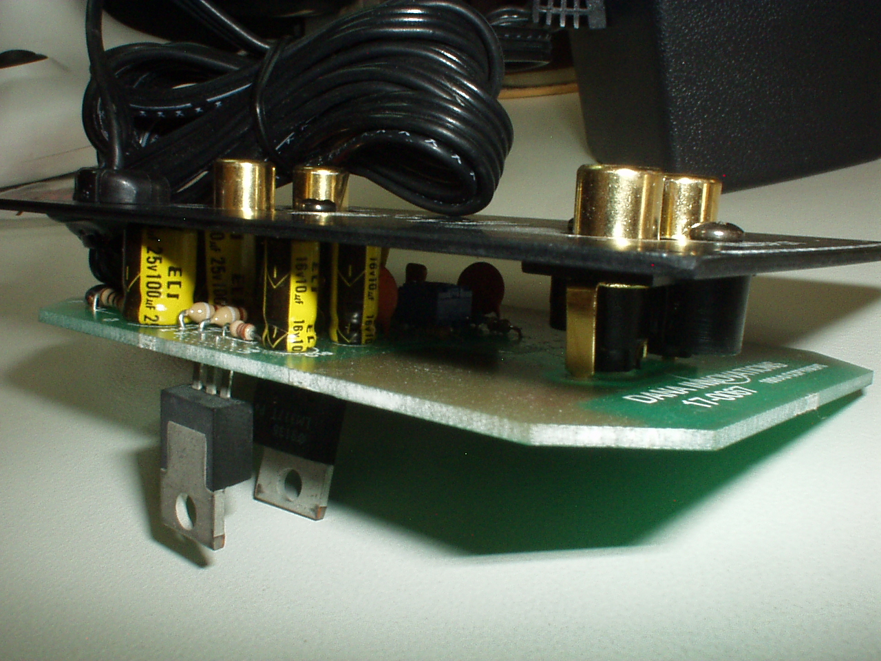

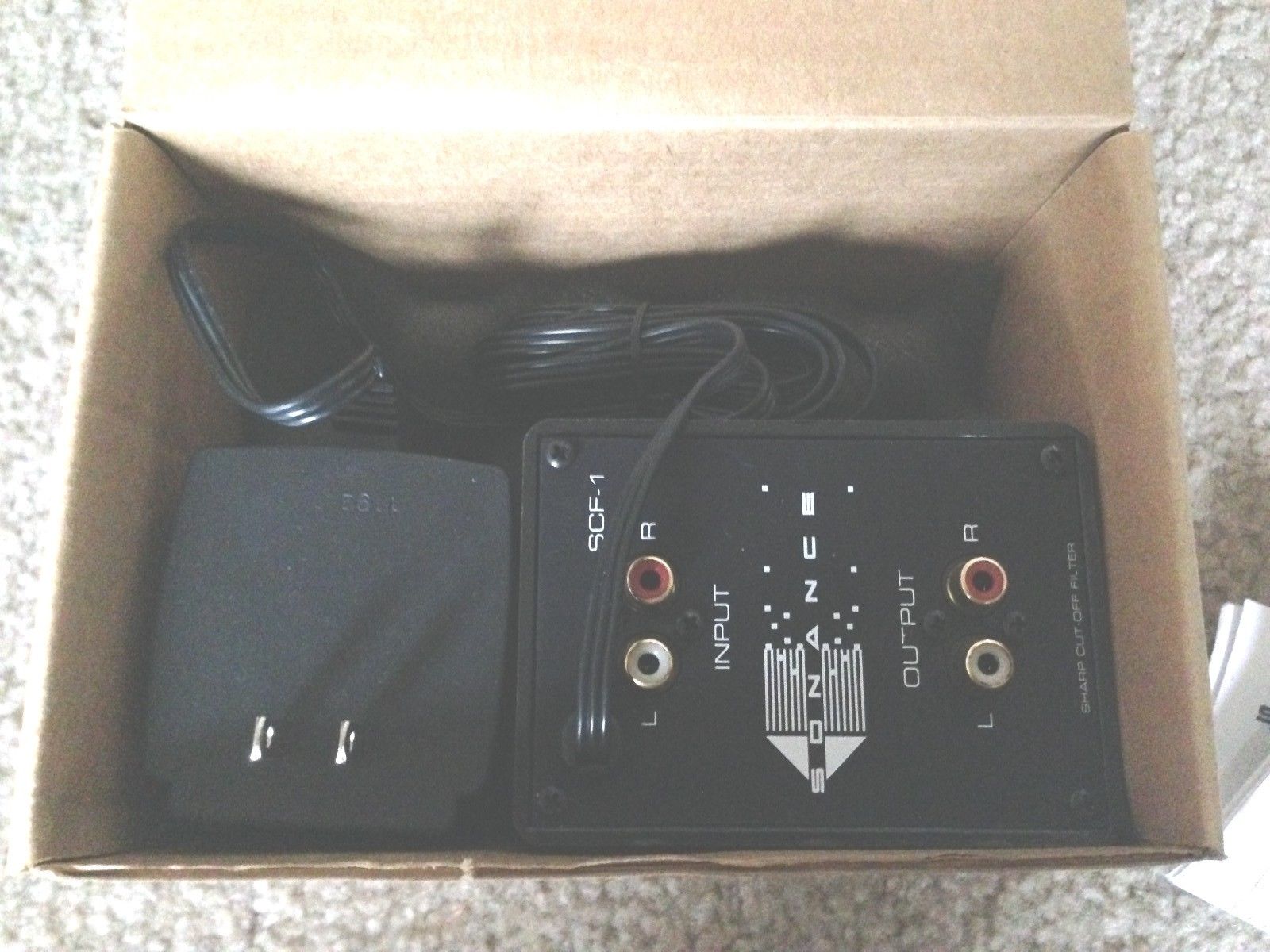

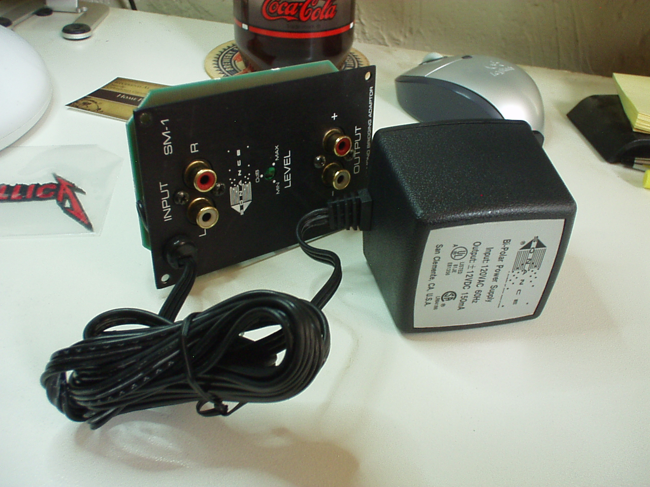

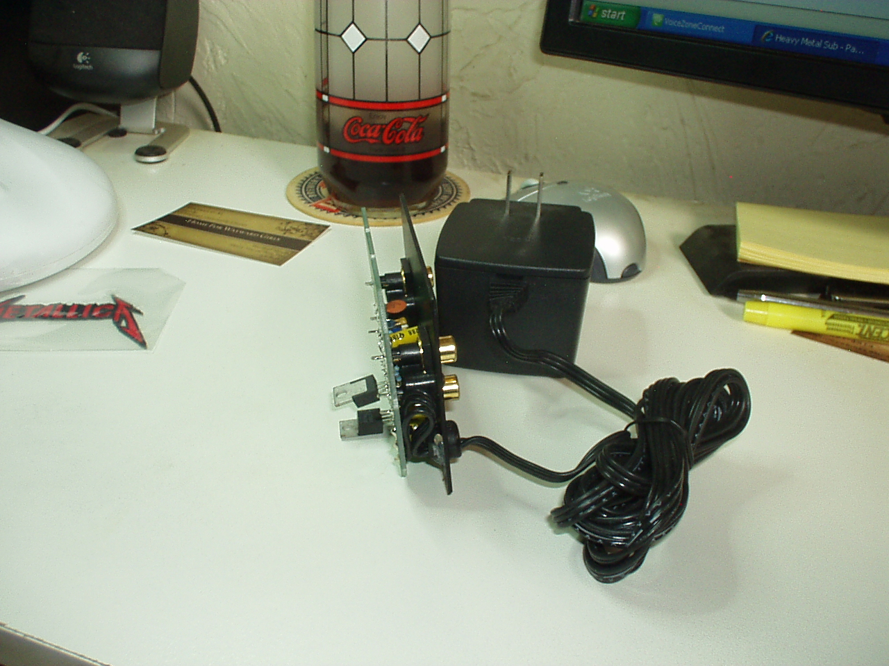

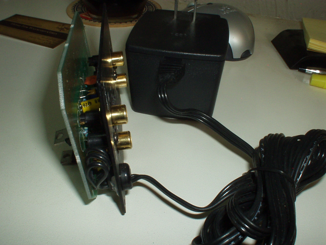

Well, I'm feeling rather Randy Dick right now. My concerns involved the Rane stereo to mono summing circuit with the weird impedance. Along came this SM-1. Then I was wondering about some secret sauce bridge building. Along came this SM-1. When I wanted to run that 1,000uf motor starting cap on the sub for a 20Hz Hi-pass, I got straightened out real quick. Along came this SCF-1. Sharp cut must be at least 3rd order? I was taught too sharp a cut will make it ring like a Christmas bell. What do I know?

I just ran some sims in Hornresp using your driver in a 170 liter (505 size) enclosure using a port about the size of the center port area (42.875 sq inch).
Hornresp says a round port 24Hz Fb would be 33" long, your 505 shelf port probably would only be more like 25".
The port still would need to bend and go up the back of the cabinet.
With a 24 Hz Fb at 79 volts (a lot more than the PL can probably put out) the 3.5 ohm driver stays within 22.5mm excursion from 19 Hz up, one meter SPL around 120 dB at 25 Hz, 124.5 at 40 Hz, and 123 dB at 100 Hz.
The 22Hz tuning Stereo Integrity recommends would make the response dead flat.
If we raise the tuning to 36Hz, the response tilts up at the bottom, +6 dB at 44 Hz compared to 100 Hz. The lower 24 Hz tuning will sound "tight", the higher 36 Hz tuning will sound more "boomy", kind of like a Wurlitzer jukebox run through an octdivider 🙂.
Don't get how you plan to get around the low impedance issue, a bridged amp sees 3.5 ohms as 1.75 ohms, and the PL ain't gonna like that.
