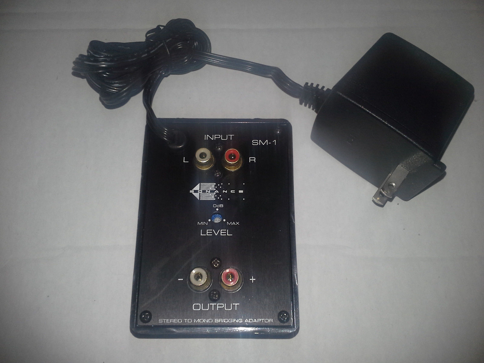

I found this gizmo that may address my summing and bridging concerns. Looks like I patch it in with +output to channel A input.
-output to channel B input.
Speaker + goes to amp channel A +output, - to channel B +output, negs not used.
This assumes a 180* phase shift on the gizmo's output. I have no specs or "user manual" for this.
Thanks, Al.

Also, I read amp bridging requires common ground? The PL has a coupling switch, normal or direct. What's this all about and are they related?

The gizmo does a polarity reverse (not a "phase shift"), same as swapping + and -, but probably isolates/floats the chassis ground, which is why it needs power to do it's thing.
The " - " speaker outputs are often the same as chassis grounds and directly connected to each other, you can verify that with an ohm meter, if they are common they will all read near 0 ohms resistance between points. The PL schematic would also confirm this. The normal or direct switch, IIRC, "normally" inserts a HP filter, "direct" allows the amp to amplify down to DC, good for tearing up loose cones or operating shaker tables 😉.
Some amplifiers are already "bridged", the speaker " - " are also hot, isolated from the chassis, and hooking them together will result in amplifier shut down or smoke 😱.

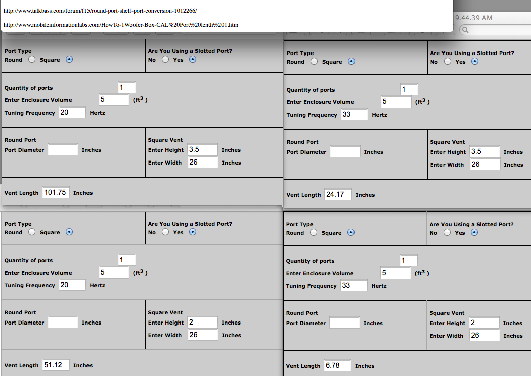

Some discussion about port types:
Round port to shelf port conversion? - TalkBass Forums
And a port calculator:
Port Length Calculator
The port calculator does not tell you what vent velocity will be. Too high of vent velocity, and the port gets "blown out", it will make chuffing noise and loose LF output. Keeping vent velocity below 15 meters per second (or so) will result in a port that works well but is not overly huge.
You probably can get by with around 50 square inches of port area. Some examples below. I always like to make ports a bit long, and verify tuning with a sine wave sweep. The cone movement will be at minima at Fb, if Fb turns out too low, chop off some port.
Remember Hoffman's Iron Law: Low, Loud or Small, pick two, lower tunings won't be as loud.

The gizmo outputs a polarity swap, you say. I thought I needed a mirror image phase shift to walk the bridge.
I can not figure out if the gizmo will work.

I summed the three port areas and devided by three and entered this as three ports on your port calculator. That did not turn out too well. LOL

Al,I summed the three port areas and devided by three and entered this as three ports on your port calculator. That did not turn out too well.
The gizmo outputs a polarity swap, you say. I thought I needed a mirror image phase shift to walk the bridge.LOL

Using the 33Fb "step down mode", the calculator pukes out a 7.72 length port compared to the 505's stated 4 inch depth.
Probably a depth somewhere between the two is the real Fb. As I mentioned, I always like to make ports a bit long, and verify tuning with a sine wave sweep. The cone movement will be at minima at Fb, if Fb turns out too low, chop off some port. Easier than adding length.
A 180 degree "mirror image phase shift" over all frequencies results from a polarity swap. However, loudspeakers have a different phase response that varies with frequency.The phase inversion in bass reflex cabinets occurs over a limited bandwidth. Since you seem to be inquiring about both, thought making a semantic distinction useful
