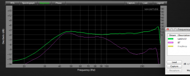

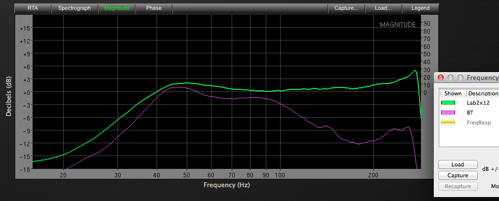

P.S. Also have one nifty little 2x12" band pass box design I call the "Bow Tie" available, it is 26.5" x 22.5" x 15", it didn't quite make 100 Hz as the sim predicted, but would work well with your TL 12s around 80-90 Hz.
Output between the WS 2x12" and the BT compared below.
The BT has really small back chambers which keeps excursion low below Fb without requiring a HP filter.

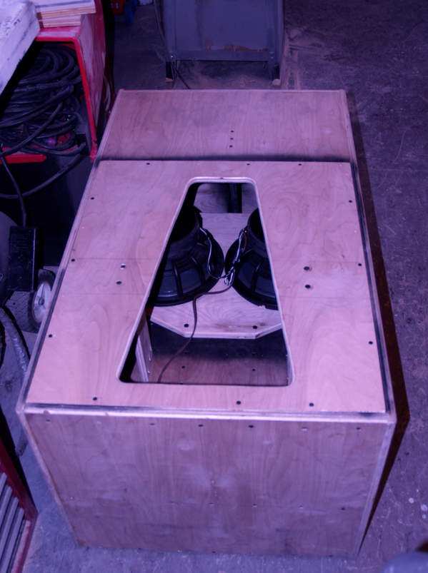

I was searching for a pic of Wayne Johnson strumming through your Thiele to post here with no luck.
If my mule came in like a train I would build both your Lab 2x12 and my variant so as to compare with a pair of ears. Well, that train derailed somewhere in Washington I think.
I like to hear with my eyes as well. I picture a big gnarly reverse loaded 18" tapped short horn bandpass box sit'n in the corner in all it's glory with it's balls hanging out.
To me, that would sound incredible before I even turned it on. Don't hate me.
I would like to build one (actually half of one). Unfortunately I have no dimensions or driver spec's that variant was designed around. Maybe you could help?

Half of the offset dual 18" ported cabinet would be a bit underwhelming, the horn is already not doing much below 100 Hz, cut the mouth size in half and pfft.
That said, you have the dimensions in mm, just divide by 25.4 and away you go, the box is 48" x 30" x 22.5". The speakers look like they might be some JBL 18".
The Keystone would kick it's butt, you could forgo the grill if you want it to look more gnarly.
