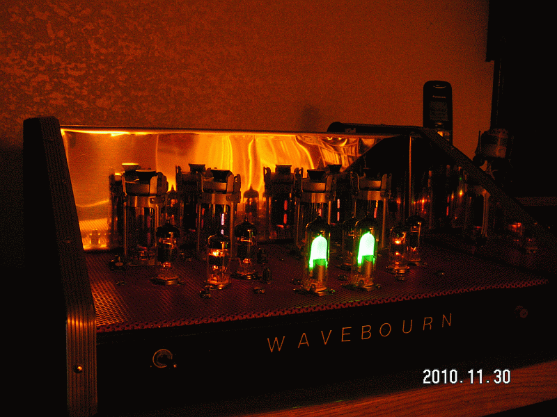

Here is a picture of my last amp prototype that uses tubes in normal regimes, attached. Perforated aluminium chassis allows free air convection, and spreads heat well due to thermal conductance of aluminium. Capacitors are below, so cooled by the coldest in the amp air. Mirrors reflect rays preventing heating of transformers by tubes.
But in this particular topic I was asking about source of coolers because I want to run 6С19П tubes with higher anode dissipation power than allowed by manufacturer...
