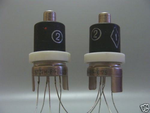

heatsink for a small tube
For which one?
I have a pair of such thingies, to toy with them... Used as radar screen deflection tubes in military jets.

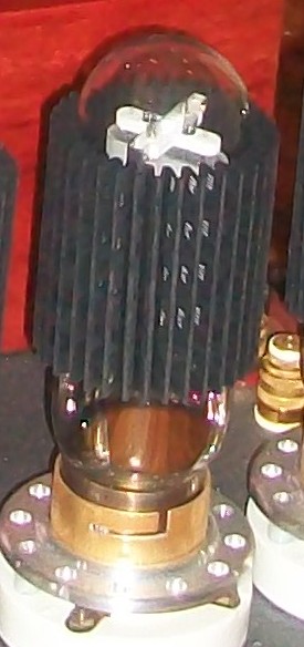

I think that Wavebourn's example heatsink that started the thread is a significant compromise and probably poorer than the Pearl examples - as the conductive cross-section from the contact metal to the outer 'fin' section is very minimal, and even the metal-glass contact would have a relatively high thermal interface resistance due to air-voids.

I pulled them from some US Army equipment; I think engineers who designed them knew what they were doing.

Yes, anodes themselves are cooled by radiation. But maximal power dissipation depends very much on convection.
Here is the graph attached: allowed power dissipation of GU-50 depending on air temperature, when glass envelope is 200 degrees Celsius. As you may see, in 100 degrees environment only about 15W is allowed, when in 20 degrees all 40 Watt.

But the question was, does heatsink help to cool down anodes, or not.
Imho the answer is yes, as is based on a simple thermal resistance concept and the fundamental mechanism of blackbody radiation between two surfaces in a vacuum.

Yes. If the heatsink is an efficient one and a true blackbody absorber with no heat reflected back and able to create a temperature gradient, then Prevost's Exchange principle would apply. The larger the gradient, the better the transfer.
On other hand, if the heat sink blocks off air circulation and is not able to carry the heat away or reflects the heat back, then it would be useless.

The better the glass is cooled, the more power dissipated by anode allowed.
Very weak dependence imho. To improve heat transfer some glass tubes like GU72 have anode contact on top. That design allows anode heat be taken away from glass envelope by thermal conductance not by IR radiation only. Here we can put good radiator on top that would work efficiently.
Cooling glass envelope by itself does not make big sense for anode cooling. Like it was mentioned earlier in the topic tube screening with metal radiators could protect other parts in proximity.
