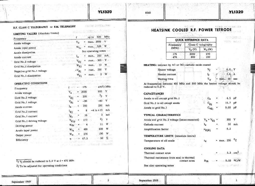

I removed it from some military transceiver tightly packed inside. The idea was to use such coolers for 7 - channel tube amp, you may see it on the picture around 6S19P tube, the amp would need 14 such tubes. I gave up the idea.

In the final analysis I must trust the military and their use of IERC coolers. When lives are at stake, it is quite a different situation than when only listening pleasure is the outcome. I am a disabled former MI officer and I know full well the results of inattention to details under combat conditions. Regards
