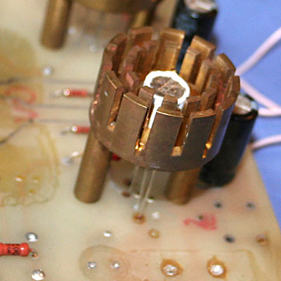

If that was the case it seems unlikely I'd ever have seen any temperature reductions, something I emphatically have, and repeatedly.My point is that radiation and convection are likely to be worse with a cooler than without. A cooler can only improve things by using conduction, which requires good contact all over the glass. It seems that this has only recently been achieved.
This is a many faceted problem, not one 'resolved' by over-simplified views.
A black surface (the best option) immediately outside the glass could radiate up to half its thermal loss back into the valve.
It can't. A first, it has 2 sides. Second, area of anode is much smaller than area of heatsink. Third, unlike anode heatsink is exposed to an air convection.
Glass is cooled also, due to chimney effect that accelerates air flow.

Yes, it has two sides. That is why I said half radiation could go back in. In practice convection and fins on the outside would mean that less than half would go back. Which radiates most into a valve: a hot black body ('cooler') just outside the glass, or a cooler grey body (chassis, transformer?) some distance way? The area of the anode is irrelevant, as much of the incoming radiation will be absorbed in the glass.It can't. A first, it has 2 sides. Second, area of anode is much smaller than area of heatsink. Third, unlike anode heatsink is exposed to an air convection.
Glass is cooled by the chimney effect with a loose 'cooler' which has an air gap big enough not to restrict flow. Such a 'cooler' cannot use conduction. You choose: chimney or conduction?
I will choose what allows me to dissipate more power on anodes of 6С19П tubes.

A good thread topic always endures, and having read through this one I suggest many comments are riddled with a misunderstanding of thermal physics and how heat from a power tube is mainly transferred. There was a good mix of diy solutions and discussion on the Pearl coolers, and the more typical forced air cooling path.
The main misconception I thought was related to the valve glass envelope and infrared radiation. There is no net radiated energy transfered between two blackbody radiators at the same temperature in a vacuum. We don't have blackbody plates or glass envelopes, but from what I can gather they behave pretty much as black bodies for infrared radiation at the tempertures involved in a power valve, ie. the glass envelope is best thought of as just being opaque to the energy radiated from the plate. The net transfer of energy from plate to glass wall is one way and depends on the difference in temperatures - in essence all the heat generated in the plate is transferred to the glass - if the glass is cooler then the plate will be cooler.
Removing more heat from some regions of the glass than others will stress the glass as glass is a very poor thermal conductor. For the Pearl option, the actual blend of heat transfer processes from the glass wall to ambient air in the vicinity of the vanes seems to result in temperature differences that are acceptable, but other techniques have caused problems.
If high temperature was a problem, and existing air cooling was not sufficient or you don't like the Pearl option then there may be a better path to take by using something like Bergquist's gap pad or q pad to provide lower thermal resistance transfer from the total glass surface to say a split copper tube that can then conduct the heat to fins - as it achieves primarily conductive transfer of heat from the glass, and would be the basis of a much lower thermal resistance method than the pearl option. There is still a need to transfer the heat to air, but a copper tube buffer would allow the use of simpler and better heatsinking to air. Obviously not an easy practical method for ST profile glass envelopes, but reasonable for straight sided profiles.

Yes, and this is why I was asking about such thingy made like a bracelet that firmly touches all glass around:
If the glass stopped all the IR radiation, then closing the glass doors on a fireplace would stop the IR and would leave the human absorbers on the sofa cold. (at least initially) I think the glass on most tubes is thin enough to allow some significant IR transmission. You can feel the heat from the filament before the glass gets hot. (Try putting ones hands around a light bulb that is just turned on and see how fast they get warm!) Silica envelopes (transmitting tubes) would likely transmit a majority of the IR.
