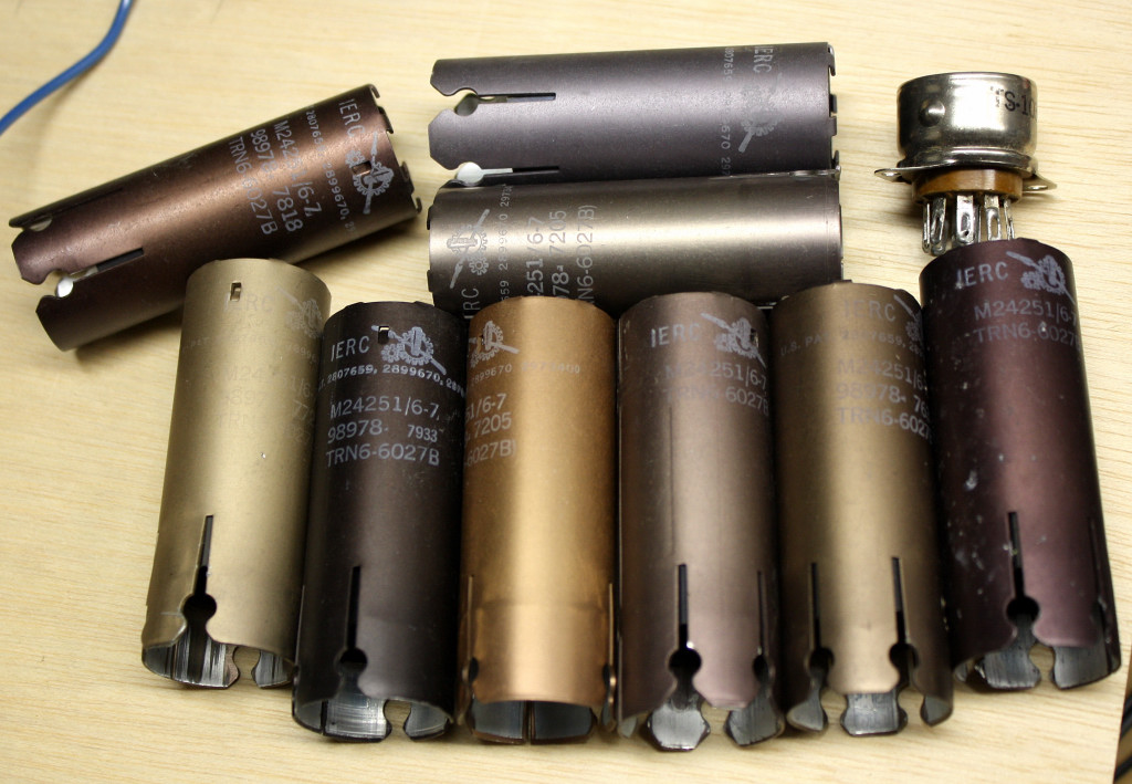

A series of 'military' coolers were made by IERC for over 50 years.
I routinely rip apart military surplus for the tubes and other useful components, so I looked in some of my goodie boxes, and found these. It looks like there are about 6 black strips inside that contact the glass and there are little chimneys between those strips and the outside wall. If air was forced up through the chassis it would flow through these little chimneys removing heat.
It is interesting that all of these have the same numbers on them, but no two are the same color. I don't know if all of these came from the same piece of equipment, or each came from a different boat anchor. Whatever it came from was likely stored outside in the Florida rain.

I think there are some special pencils or "crayons" that are made for checking temperature of surfaces. They either melt or change color at some specified temp. I can't recall at the moment what they were used for or what temp ranges they cover, but it was for HOT stuff. Might be a problem to get them to "draw" on glass though.
There are sticks of this but liquid Tempilaq works on glass
Temperature indicating liquids. Quick application.
It's used to indicate temperatures for heat treating, as well as over-temperature indication. Used in R&D labs, on race car engine parts like turbochargers etc. You can find out peak temperatures by painting on a series of strips or dots of successively higher temps
