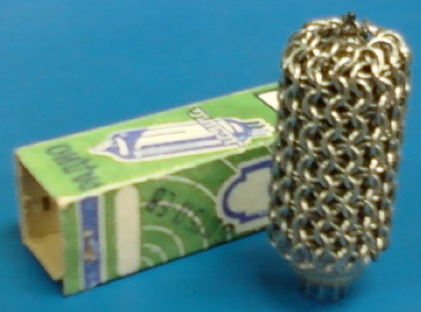

About 30 bucks in hand tools, probably half already own: You can have
as many chainmaille coolers as you got time to spare. 6BQ5/EL84/6P14P
take about 2hrs, maybe less, especially if you get organized about it.
You need:
Two sets of pliers (Home Despot or Lowes Life) covered with gorilla glue
(the polyurethane glue is only if you care about not leaving tool marks).
One set of vice grips and a Wall Mart knitting needle for coiling mandrel.
Turn the vice grips and form coil by hand, do NOT use a power drill!
One set of tungsten carbide tile nippers, and dremel tool to modify the
stops (that part of the tool is not tungsten) to close down enough to
score 18 ga for clean breaking.
Breaking rings off a coil with the nippers is... I'd probably have to snap
you a picture, its not so easy to describe the technique in words. You
can use any cutting tool, but to avoid deforming the rings is the main
reason you will want to score and break them with nippers.
The toughest problem with aluminum is that its too damn soft, and will
easily deform in unintended ways.
If you got more money than time to throw at it, there's places online to
buy black anodized aluminum rings... But making the rings isn't really all
that time consuming. 15min out of your 2hrs per heatsink.

Do you have expert opinion wether maille might be better than nothing or worse?
I'm aware its not likely to compare well against a professionally engineered sink.
However, it could be tailored to fit oddball tube shapes, coke bottles etc...
Not as difficult as that might sound, just time consuming...

Ken Peter wrote:
"Do you have expert opinion whether maille might be better than nothing or worse?
Not as difficult as that might sound, just time consuming..."
If your question is directed me, I don't have any 'expert' opinions I just do the work ;-)
I think your idea above is very clever. It will rid you of hot spots and the enturbulation of air flow around the maille is a good thing. A hint, paint your parts with some hi-temp, flat black paint, it'll make all the difference.
