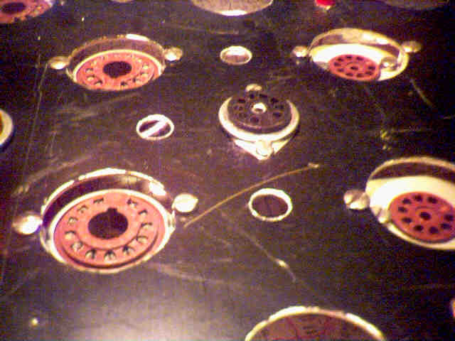

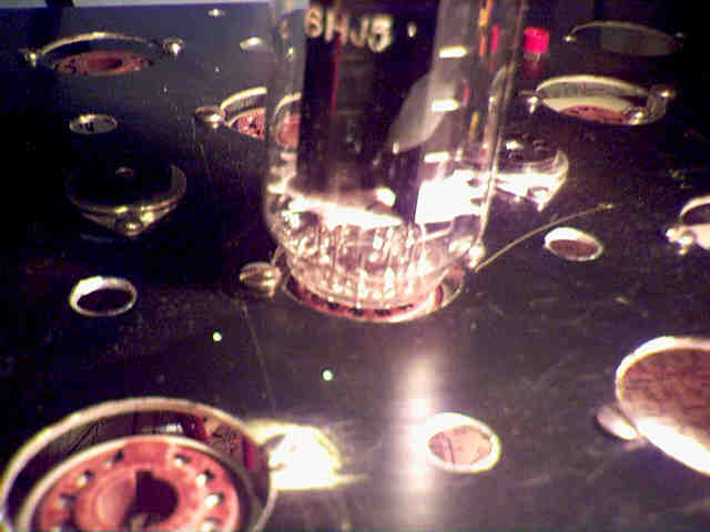

The cooler on my initial picture actually was taken from some surplus military transmitter. Being black, it does not reflect rays; it absorbs them, and as soon as it's temperature is higher than ambient it creates convection the cools it down. It is made of especially formed copper alloy, so it conducts heat well from internal to external surfaces. It can't break the glass because it acts like a spring, absorbing heat from the glass as well.
The military tube "coolers" that I've seen did not have fins. They were a simple metal tube, with a springy insert that pressed against the tube with little leaf spring fingers, keeping it centered. With maybe a 1/4 inch gap from glass to metal tube. The springs only had tiny end edges against the glass tube, clearly NOT intended to convect heat from the glass. The tube acted as a chimney for air passing thru chassis holes around the base of the tube. The bottom chassis was pressurized by a fan. The conformal air flow would provide uniform cooling of the glass evelope. This was clearly a very well thought out "cooler" approach and should be easy to emulate now if one puts a fan in the base to pressurize it.
The "cooler" tube needs to extend down to the base to entrap the air flow from holes around the tube socket. I just mount the tube socket with some 3/16 inch spacers below the chassis and the air flow cools the socket and pins too on the way up around the tube. No need to drill extra air holes then. Especially with Compactron sockets (Sweep tubes) which have a big hole in the center. Could probably even get away with a "cooler" tube that only comes half way up the glass tube side, then you can still see the glow. I don't use any thing more than just the recessed sockets with the chassis fan. But then I haven't tried doing a "Tubelab" glow test on my tubes either.
The earlier example of a 4X150 type tube is off base here for glass tubes. There the plate is heat conducive metal and the fins are silver soldered to the plate. Pressurized air passed thru the fins. Clearly designed for convection from the get go.
Here is a pic of some recessed sockets for use with pressurized chassis air flow. I checked the socket spacers and they are actually 1/4 inch. You will also note that the experimenter chassis uses interchangeable socket assemblies for any type socket. Ie, 7 or 9 pin or octal or compactron fit the same chassis holes by means of mounting plate adapters.
