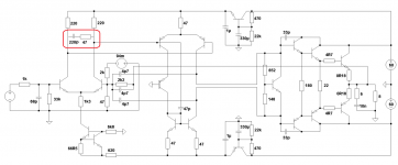

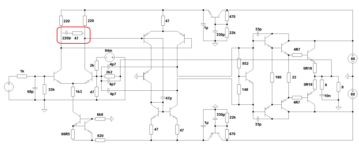

Oh, please !BTW, these 2 cases are not identical in open loop bandwidth
"...while emitter resistances of the VFA are adjusted in order to get an open loop gain equal to the one of the CFA..."
Take five seconds to verify (or try to understand) instead of arguing with false assumptions.
And all the rest of your comments are about the same. (Both input stage and VAS are in class A).
It is really boring, while you have spend a lot of time with a lot of care to publish a page in order to explain a topology, trying to help people to understand-it, to read comments like the previous one of jxdking.
No, the symmetry of an LTP is not compensating the distortions of the input stage. They are additive. The feedback signal have to pass across the inverting side of the LTP BEFORE to be subtracted to the original signal. Both the distortion and phases shifts of this transistor will modify the feedback signal, making-it less accurate. And we will find its distortions (phase inverted) in the final signal.
The non linear parasitic capacitance of the base junction of this transistor will have an influence on the bandwidth and phase at HF.
Not to mention that we want the two sides of the LTP to be at equal impedance, while we need a high enough input impedance. This lead to a relatively high impedance feedback path in a VFA witch will make a low pass filter with the base parasitic impedance.
In a CFA, we can set the feedback impedance as low as we want, in order to avoid this. And the feedback is working in a common base configuration, witch have always been the preferred at HF.
Reason why a CFA have a better phase margin, and, once both will be compensated for a maximum flat bandwidth, a wider open and closed loop bandwidth, and a better slew rate. It is all about.
CFAs are as old as electronic. (I designed my first commercial amp around 1970, build at thousands of units, very successful at its time, and it was a CFA.)
I don't know why the LTP had became a standard, and this CFA topology neglected until video bandwidths obliged the IC manufacturers to discover again the advantages of this interesting topology.
Both configurations have their advantages and inconveniences, of course. That i tried to enlighten in my article. I believe we have to know them both before to make a choice. As OS did 🙂
And not to be a VFA sectarian for some obscure and non objective reasons: prejudices are never good in audio electronics.

Open loop bandwidth of both amps are different in your chart you plotted.
OK, I just spent 5 minutes to calculate the open loop bandwidth of them by my own.
Both input stages of them have almost same amount of gm(Transconductance). It is 0.0169A/V in CFA, and it is 0.0170A/V in VFA. I only count for one side (up / down). if combined, the number will be doubled. They are fair enough.
However, look at the miller caps (C6 & C7) in the chart. The one in CFA is 17.6p, and the one in VFA is 28.8p. That's the reason why you will have different open loop bandwidth. Based on my calculation. The unit loop gain frequency in CFA is 6.8MHz, and 4.2MHz in VFA.
When you have miller compensation. the amount feedback you will get does not depend on the OPEN LOOP GAIN any more. The total feedback you will have depends on the outline of 1st-order slope which depends on the OPEN LOOP BANDWIDTH. You don't have to keep OPEN LOOP GAIN equal.
... As they are, as explained, the minimal miller values you can set in the both configurations to have the maximum possible flat bandwidth with no peak at HF in closed loop.However, look at the miller caps (C6 & C7) in the chart. The one in CFA is 17.6p, and the one in VFA is 28.8p. That's the reason you will have different open loop bandwidth.
Both amps are equally optimized with the exact same good practice rules.
Sorry that you don't understand this, the reasons of this ... and persist to do not understand !
What do you think ? That i am selling anything, own the CFA patent and cheat to increase some benefits ?
On the contrary, I used a 1K/47 Ohms for the VFA feedback in order to give-it all its chances in bandwidth. Just try with a 10K/470 Okms you would use in a correct and ordinary VFA to balance the base currents of the two sides of the LTP and ...cry !
More than this. As i expected this kind of controversy, i even published a curve with the same miller for the CFA and the VFA:
http://www.esperado.fr/temp/compare_vssa/samemiller-cap.gif
Ok, now ?

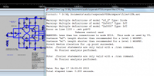

... the example files?
Yes, I had the same errors when I tried to run Esperado's files a while back.
I advised him of the problems but eventually found it easier to fix them myself rather than deal with his reaction.
It would seem they are still not fixed.
I didn't spend much time on it so the results are only tentative but look plausible.
The more accurate (Cordell) models showed that the distortion was worse than claimed.
But only a factor of 2 or so rather than 10 or more, as I initially expected.

... despite you presented yourself as an expert in LTSpice...
I do not claim to be an expert in LTSpice, Bob Cordell is far more experienced.
My own, limited research has only confirmed his statement that the NMOS and PMOS models are inaccurate for power FETs, and better replaced with VDMOS models.
So my recommendation was to replace the MOSFET models on your schematic, where it says "PMOS and NMOS", with Bob's "VDMOS" models.
This recommendation is even more emphatic now because there have been some internal improvements to these models by the LTSpice team and Bob tries to keep his models up to date.
Far better to take them directly from him than use my copies.
One recommendation of my own concerns your use of the Tian probe.
There is no "Set" statement in Spice so your "Set" statement will not be effective, if you include a probe then it will not be turned off.
I am sorry that I haven't replied to your last PM.
Best wishes
David

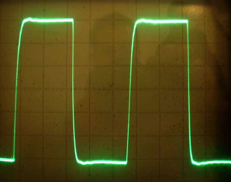

Of course, happy to share! 🙂
The v1.0 is already finished, stable, and sounds nicely and the v2.0 is just in progress.
The IPS is already up and running (see freshly posted pics @ the symasym thread) and I am working on the OPS now.
Everything is fine so far and since I developed the final cicuit on a prototype, hopefully this will be just an assembly work...
And after that I'll start my journey to the CFA world starting with the "DVSSA" layout.
Or do you have any specific question?

With 60 volt supply rails and single output devices, the amplifier is at risk of failure if the output terminals are shorted. I take it you will have some strategy to prevent that from happening.
My question is, how does the circuit look with the latest modifications?
So was my work.To complain about a free service is not very appreciative.
I believe it would had been less time consuming for you(and me) to send-me your files, than to write all those comments.
Anyway, thanks for your advices: i will not make-you lose more time on it. May-be, one of those days, if i am boring myself, with nothing more useful to do, i will update my files, ... when I have understood the proper method.
I dont perpare for shorted terminals, out of scope for me.With 60 volt supply rails and single output devices, the amplifier is at risk of failure if the output terminals are shorted. I take it you will have some strategy to prevent that from happening.
Latest schametic: I'll post it as soon as my v2.0 is finished+

The best waveform of those you posted is that in message #69 i.e. 10kHz sq @25 volts pk-pk into 4R. It appears the circuit for that is largely as shown in #70 without the parts circled in red and some changes in the compensation? - whatever. However there is an anomaly in your sequence of the bias transistor and the stopper resistors. It seems might have had a better basis with which to work than you have now.

The new oscillation I mentioned compared to my prototype seems to be solved now with the new red-frame-marked section.
The scope image shows 200kHz without any load yet.
