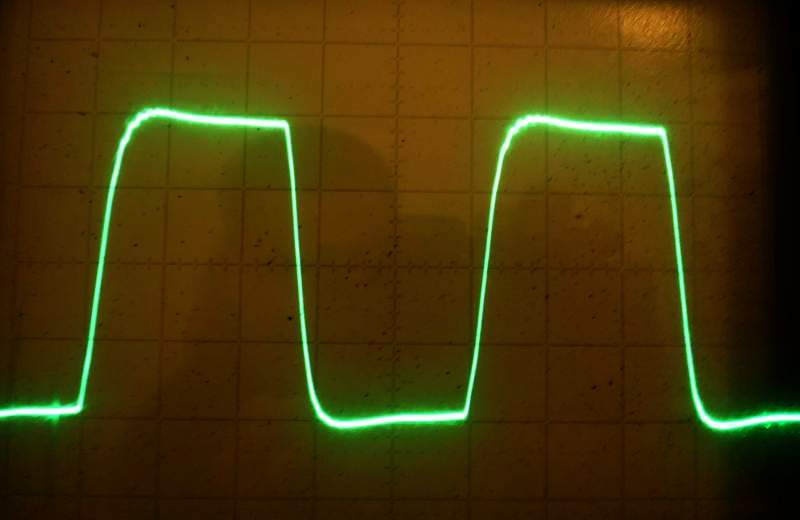

I didnt wanted to ruin my prototype so there were some protection resistors series with the main DC rails.
This is 10kHz 2V/DIV. The load was 1uF without R.
With higher output levels the amp collapses... 😱
(1k - 22pF @ IP, no coil @ OP...)
Just wondering from the reference to Symasym whether the prototype still has an EF3 stage as projected or have you changed it to an EF2.
A 1uF capacitor on its own is not representative of a loudspeaker load. If you are concerned about avoiding damage to the prototype you could look at the wave-form on an 8R load and start with a small value parallel capacitor - say 100n.
A tentative approach would be to have a selection of capacitors available and have a momentary push switch in the test capacitor circuit and gradually increase the output signal strength. You can flick or hold down the switch depending on what you observe on the screen of your scope.
With regard to the absence of an output coil, the negative feedback line is also an amplifier input and it's purpose is to mitigate against load induced signals causing problems. Another approach is to fit a 0R22 resistor between the amplifier output and the load.
I am not suggesting this as a cure all, as there were no stability problems with your prototype as an EF2. An EF3 version would have introduced an additional phase shift in the forward signal path which would have reduced the stability margin as compared to the original.

The prototype has EF3 and decoupling and base stoppers as well.
And it is now stable. BTW: I played with these base stoppers and found that
(in may case) they are only needed @ the power transistors (4R7). Without
them I saw some small, local oscillations on the waveforms under heavy load.
So I dont have any at the predriver and driver stages now.
And the paralell caps (on Vbe and predrivers emitter resistor) looked also unnecessary to me.

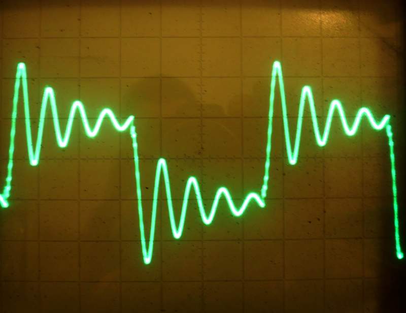

BTW: what can be read from a wave form like above?
Thr squarewave is 10kHz and the ringing is about 100kHz.
Thats would be the final bandwith..?

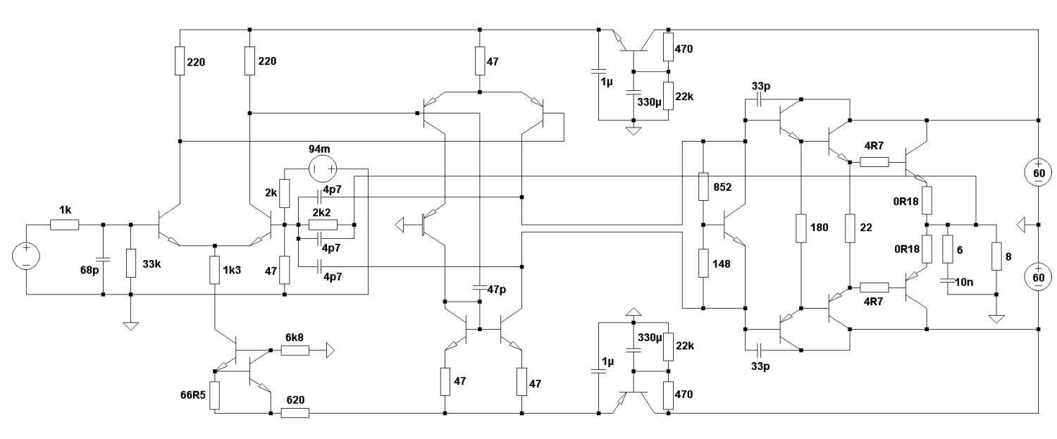

The wave forms you have posted in earlier stages of development are more the shape of what you would want to see. Unfortunately comparisons cannot be drawn if the test load used is subject to being changed and it is difficult to tell if we are moving in a forward or backward direction or one step forward and another step back. If you want to pick the differences you need 10 kHz as a test frequency;
It would be helpful to be able to see the latest update of the circuit diagram. Having looked at the versions posted I noted this circuit will amplify down to d.c. which I see as looking for trouble. Also in the image that accompanied post#70 on page 7, the bias transistor network has 300 ohm stopper resistors in series with the positive and negative voltage feeds, whereas they should remained connected to the voltage amplifier halves as per the image in post#33 on page 4. This change was unhelpful.
The stopper resistors should have been taken from the bias transistor collector and emitter connections to the bases of the first driver stage transistors. I would have suggested lower value resistors - 100 ohms perhaps.
You have shown an 8 ohm resistor in parallel with the output zobel network it is not clear whether this represents the speaker load or an added component - presumably the first.
To convert from a d.c. amplifier you would need a capacitor in series with the 1k resistor that decouples the lower arm, of the negative feedback dividing network, to the earth line. You could try 100 uF polarized according to the voltage at the junction seen at the top of the 1k resistor.
Here it is...!
(The C multiplier its just for later versions, not tried yet...)
What's not shown on this schematic is the PS for OPS and the output coil.
PS has decoupling C-s with RC for pre/driver stage and the
outpout coil is 13 turns 12mm with dia || 10R 5W wirewound.

Before addressing this in too great detail what is the voltage reading on the speaker output terminal and what is the voltage drop across any of the power device emitter resistors?
Direct current amplifiers are known to drift with temperature so it will be worth monitoring the variation according to ambient conditions over a day or so.
I note the absence of any trim pots to make any adjustment for this and output stage quiescent current.
