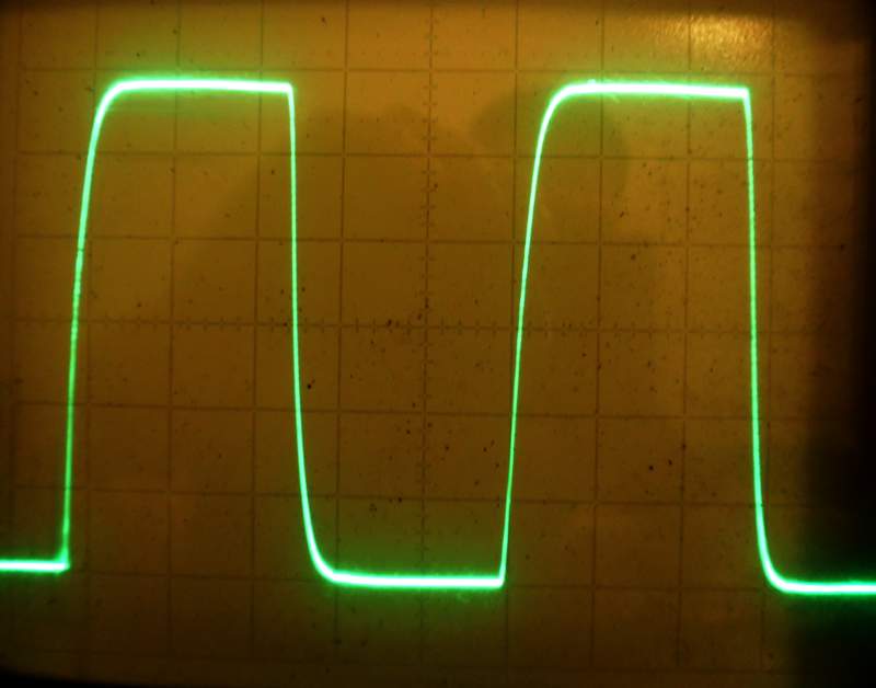

Just reporting some mods and results maybe it will be useful for others:
- decoupling caps + base stoppers @ OPS (copying the SlewMaster OPS)
result: stable OPS of course...
extra experiments: on my prototype I started to take out the parts one by one to see which one is maybe
unnessecary and for me the base stopper seems to be but I'll do some further tests around this topic... - HF compensation: the final and best results now are with: 2 x 10pF from VAS both output to INV input + 33pF
(in place where the 100pF is @ the MikeB symasym)
result: nice slewrate and square waves up to 2-300kHz and together with the OPS mods now the input is less sensitive so with a
22pF input cap even with my extreme noisy PC source its now stable (earlier this caused an oscillation at higher pot levels...) - emitter degeneration (recommended by OS) with a 100R trimmer
result: in my case no improvement - output coil (13 turns || 10R 5W wirewound)
result: before the output was instable with pure and low C (1-47nF) load with this its now stable
but with capacitive load when watching the point after the coil (at the cap legs) the voltage swing
at the ringing is higher then without the coil... is this normal..?
side effect: the coil is (hum) sensitive to the EMI so I had to shield it around with a piece of trafo base material tape

In the meantime I tried these paralell caps @ Vbe bias, and paralell on the emitter
resistors for the 1st 2 stages in the EF3 but without them the results are still great...
I used 100kHz 40Vpp test signal (without load) and watched the form of the square wave and the current at the emitter resistors...
