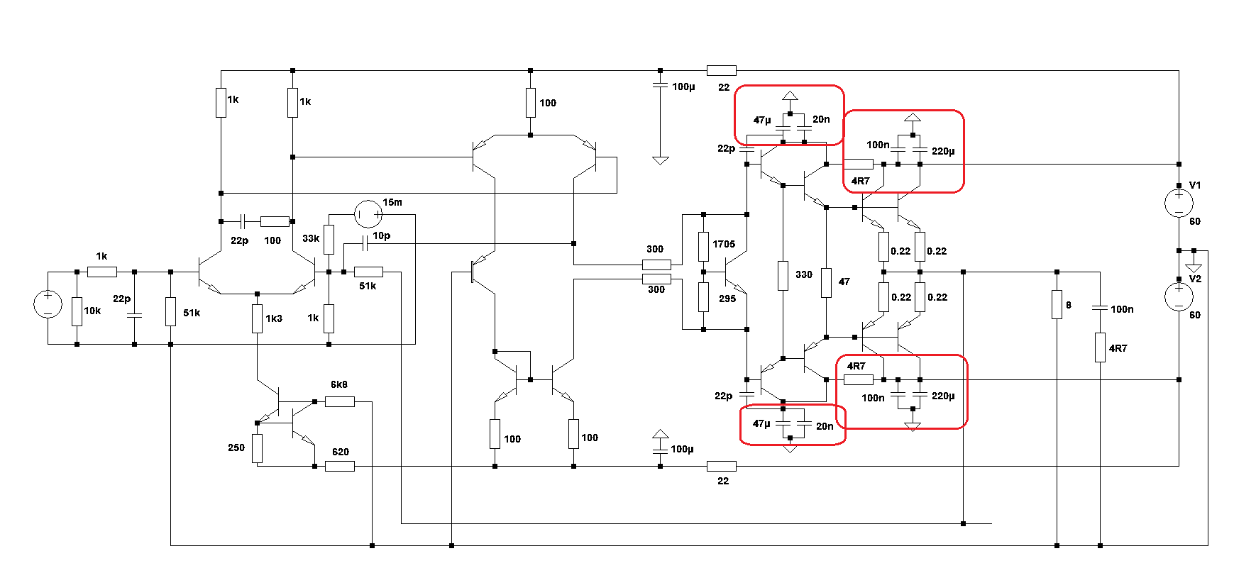

1. Decouple the OPS rails right at the collectors (220uF in // with 0.1 film
2. Isolate your pre driver from driver stage with an RC network in the rail and a c 10 ohm in the collector of each driver. Also your driver damper network values need work. A more conventional network would be 27 ohms and 470 of from the driver base to the V+ Rail.
3. Your input filter fo is too high. It should be at 500 kHz or lower
4. Add a Zobel. Without it you are going to get problems
5 . You need an output L on a design like this OR a very low ULGF otherwise you will get problems
As OS has remarked, you need to work on above issues and only after that can you address hum problems
I agree on all that I gave not edited out.
I don't know enough about item 6 to comment.
Separate MF & HF decoupling for the output devices. The traces must allow this.
Separate MF & HF decoupling between the drivers and predrivers. Again the traces must allow this.
RC isolation works very well with low values of R combined with high values of MF decoupling.
And use the full Thiele Network:
C+R from Output to Power Ground.
L||R from Output to speaker terminals.
Optional R+C across the speaker terminals, to add a Pi filter for further RF attenuation.
For bench testing the very low value of RF capacitor will allow fast signals to prompt and display output effects. Then revert to a normal RF attenuation capacitor value. I use ~700ns as RF attenuation, but change this to ~70ns for testing. You have 22ns of RF filtering in the sch.

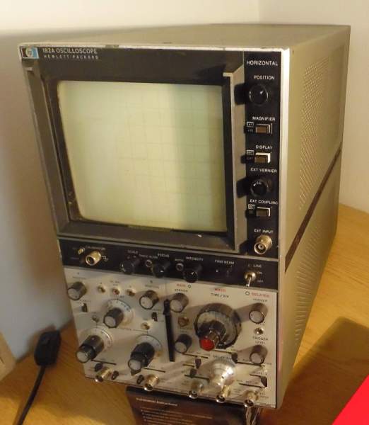

  • I just bought my new (2nd hand HP 182A) scope so now I can measure whatever you just say! :)
  • Could somebody please post an ideal scope output with a 0 hum and not oscilalting amp to see a normal noise level and spectrum as a reference?
    (I'll show my current state as soon as I learnt use this new device... :))

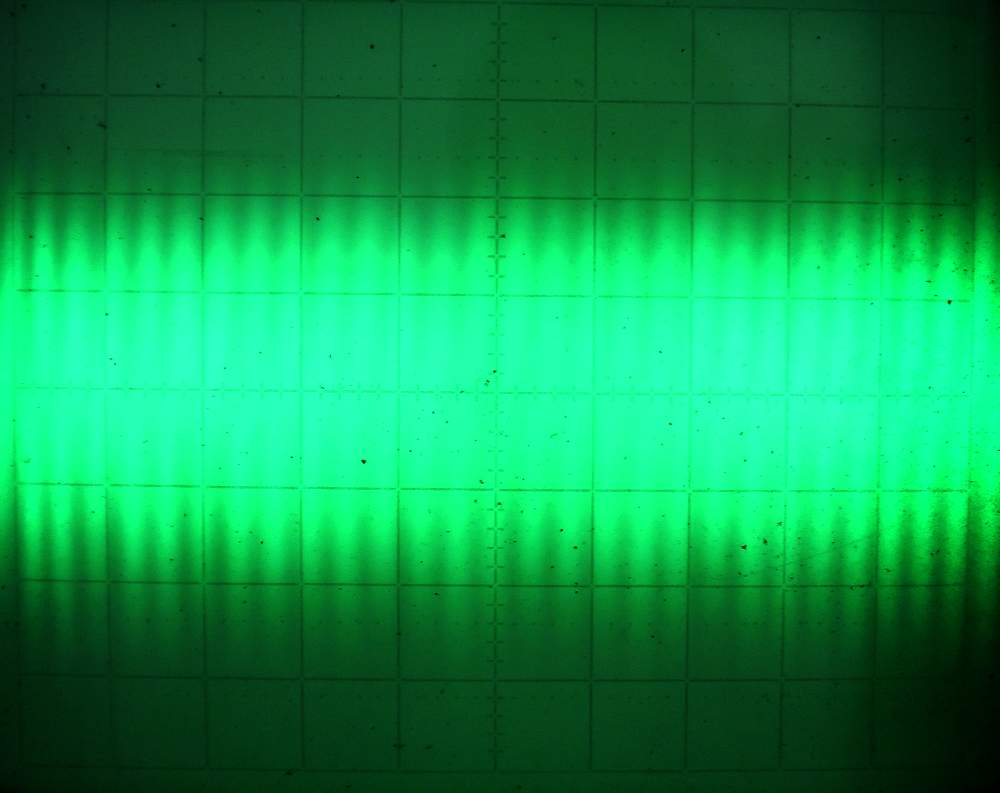

  • I tried a DC blocker (2nd picture) just for curiousity but it didnt change anything.

    1. OPS PS decoupling: ok!
    2. Pre-driver PS RC: 10R + 100uF?
    3. Input filter: I tuned it to produce a nice 100kHz squarewave @ output.
      If there is no extra HF garbage should I increase the 22pF anyway..?
    4. Zobel: there is a zobel at the schematic as well at end: 100nF + 4R7 or did you mean somewhere else..?
    5. Sorry: I left it out: I use a 0R3 wirewound 5W resistor (not a low inductance one of course... :)) series with the output
    6. ULGF: well I dont know, how it should be measured..? :rolleyes:

Keep your core design , but consider the decoupling. With a typical EF3 ,
you have about 5K current gain with pre and driver. Some only decouple
the pre-driver. (not enough)
The outputs multiply this by 30-70X for 100-300K total gain.
Better to have the bulk of this gain behind the R/C. PSRR goes
up >15db as a side benefit.
Most importantly , with that local FB loop eliminated - NO oscillation. :)

You can hear-it. You can see-it, i told-you it was-it, so why to ask the question ?
I heard just a hum and some normal level white noise.
What I see doesnt look like a classic oscillation just some extra HF ripple.
So I am asking because I am not sure it is an oscillation.
And no one confirmed it right now.

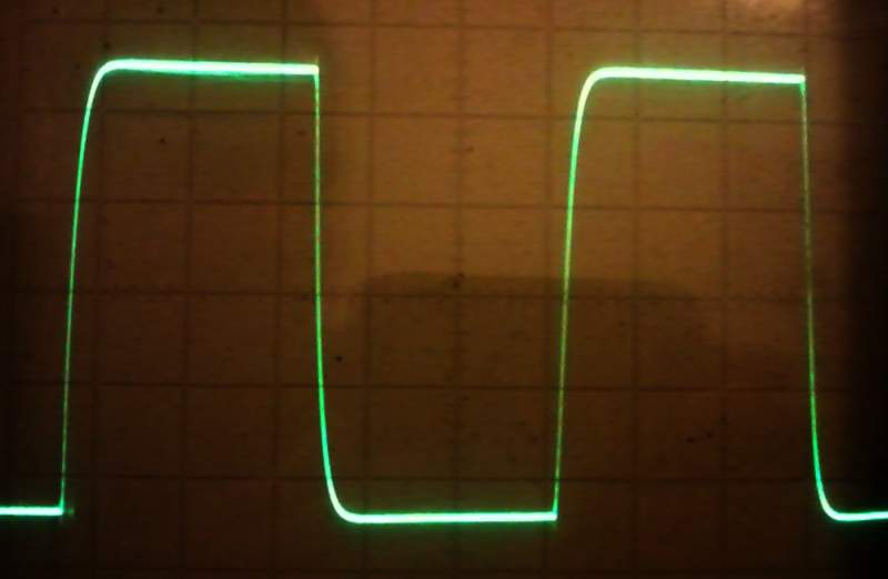

See my attach: 10kHz square wave 25Vpp @ 4R dummy load. Looks like oscillating?!
Could somebody show me a quiet amp output noise please as a reference?
(5mV/DIV 0.2ms/DIV and 0.2us/DIV)
Thanks!
Ok, thanks OS! Tomorrow I will buy the parts and try them on my OPS.
Should I "copy" the R & C values from your OPS as a start for my EF3 as well?

This should be enough? Or the 22uF/device should be used as well?
And also the driver/output base stoppers have to be used for safety?
Caps on the pre-driver & driver emitter resistors?
(About the 300R resistors: I draw them on the wrong place on the prev picture, here they are now...)

Cortez, had-ou removed the input filter to make your square waves measurements ?
Look both at them with high and little signals.
No, the 22pF was still there @ input.
Ok I'll look them, thanks!

two sets of RC decoupling after feeding the main output devices
You mean using a 2 step RC on the rails like this:
  • main OP devices: 470uF+100nF + 22uF/device
  • drivers: 4R7 + 47u+20nF
  • pre-drivers: 4R7 + 47u+20nF
I think the fast current changes at the fast driver devices should be separated from influencing the Pre-Drivers.
Either two stages of RC, or one stage between Drivers and Pre-Drivers.
At the moment the relatively slower current changes of the Outputs are separated from the Drivers+Pre-Drivers.

That is still a very fast rise time for your input.
You were told a long time back and I also gave some guidance to sizing the input filter.
Removing-it during measurements allow to be sure you can excite any instability if your generator is fast enough. You can be sure there is no peak in the response curve at HF that it can hide.
Then, you can ensure the input filter kill any overshoot for low square signals, and, if you are at the limit everywhere (including comp), you have the fastest amp you can have in the circumstance ;-)
