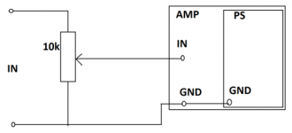

Certainly I am not expecting a concrete value that replaces me. :)
Maybe just magnitudes... (I guess am not < 100 ohms, not > 1uF, not > 1mH etc....)
And to where "my other end" should go then? To protecting earth..?
Everyone is different. We all carry a static charge. Some are positive. Some are negative. It can change with diet. It's pretty much impossible to model.

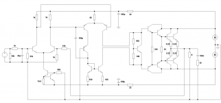

Here it is, I guess it is the pretty standard way to do it.
And the input resistors after that are: 1k series and then 47k paralell to GND.
Paralell with the 47k the HF filter cap can be changed but now it is 100pF.

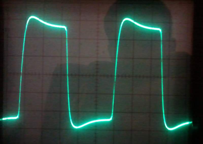

News:

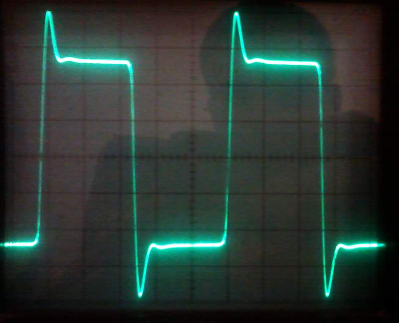

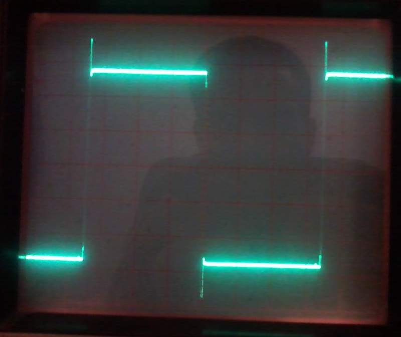

Input: 100(!) kHz square 2Vpp
Output: 2Vpp
1st picture: basic state
2nd picture: ringing eliminated ~95% just with my touch
The amp has 2 PCB: one for the PS, the input and VAS stage
and one just for the OS. At signal level (VAS output -> OS input)
the 2 are connected via a short twisted pair wires.
The 2nd picture shows what is hapening when I touch this wire.
(Both of this pair of waires has a solder in the middle so I can create a galvanic contact with my fingers...)
Does maybe someone have an idea how can I replace myself in this layout with RLC elements..?
Or based on this experiment do you have any idea what the problem can be?
Does my touch change the speed of the amp or just grounds this HF component somehow..?

I made another try: its enough to touch the VAS output point at the first PCB as well.
It is still a mistery for me what could be here the replacment instead of me...
First of all where does my other end goes to? 2nd: my RLC replacement... :)

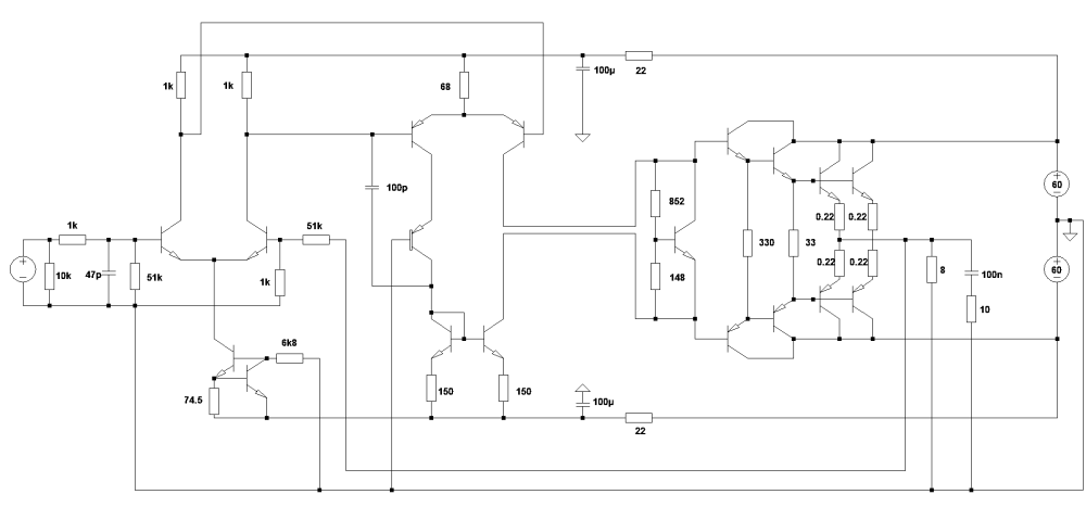

Its basically a symasym but with some mods: 60V triple darlington and 2 pairs of tr-s.
HF comp: input cap: 100pF and at VAS: 100pF nothing else yet.
I dont have the final version with all the changes but I'll draw it soon...

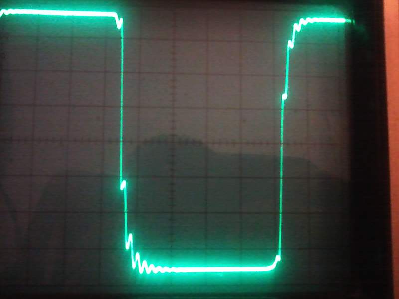

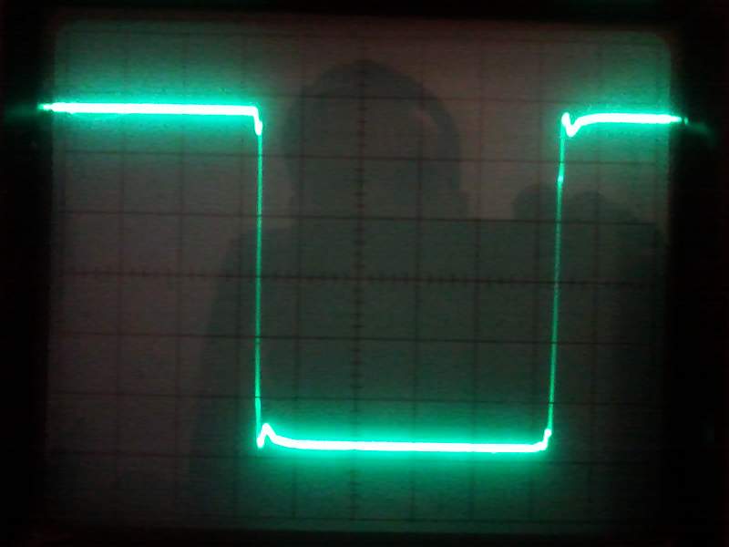

Bye the way I have some improvements: slowing down the VAS helped.
Now I have an overshoot (1st picture) but I dont know why...
I played around the Zobel as well (it was the conventional 10R + 100nF)
and I figured out that 10nF is enough and using 4R7 increases the overshoot
but loading the output with 8R dummy resistive load decreases the overshoot (2nd picture).
What this means..?

Add a Ccb across the other VAS.
I found the real Symasym responds to this.
I also added Ccb to both drivers, 22pF
I also changed the input filter from 2k2+100pF to 300r+2n2F
and I used 4 off 220nF instead of 4 off 100nF HF decoupling
& 4off 1mF + 2off 2m2F instead of 4off 100uF +2off 220uF MF decoupling.
The 10k loading the input can't be right.
Surely it should be >=100k. I use 2M2 here.
The DC coupling leaves the input pair unbalanced.
Have you calculated the VAS bias? I reckon you have ~26mA !

In order:
I tried the original VAS to GND Cs and Rs but they doesnt change the results as attached.
1st: 100pF + 47k from both VAS output to GND.
2nd: the same with the magic touch... :)
(Input: 100 kHz square)
I try the base stoppers next.
Andrew: CCb mod: doesnt help.
Ccb @ drivers: ok I'll try this as well thanks!
10k: it is just there for sim-s as the pot at max level.
I use DC servo instead cap @ FB.
VAS bias: sorry the values are not suerly the final versions I just made a scetch for the layout... :)
