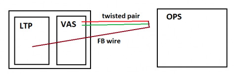

I just started to bring my prototype (attach. #1) back...
And the IPS is already up and running...
(The IPS output is now shorted and the FB goes to this point as well.)
For starting I removed ALL HF part from the cct.
Even now there is an oscillation by default (attach. #2: 200mV/DIV and 20ns/DIV)
AND: already here when I touch the FB cable it vanishes immediately with an output noise level: 5mVpp band at all timebase setting.
I just posted this because it may help before I start the OPS decoupling experiment (which - don't be afraid..! 🙂 - I'll do at all events...)
The input is shorted as well and when I start to open the pot even a slightly the oscillation goes away again. (In this case the noise level is already about 40mVpp.)
Trying the usual HF comp caps dont eliminate it either.

Oh, your amp is a voltage feedback one, right ? So the feedback is high impedance. it is normal to have this behavior, if your feedback path is not shielded well enough.touching the vas-output-FB wire..
BTW: Did-you have a serial inductance before your speakers wires, in order to stop any HF to return trough the feedback ?
Yes VFA (symasym topolgy).
Inductance: just for capacitive load tests I added a 0R3 5W wirewound (non non-inductive... 🙂)
Then I have to use a shielded wire between the IPS & OPS?
What kind of cable do you suggest for this purpose?

Well, the problem with LTP (voltage feedback) is that it is better to equal the impedances of the two branch. For DC offset. So, if you decrease the impedance of the feedback, or you will mismatch the LTP, or you will have a low input impedance.that you recommend to decrease the FB values

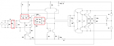

I made a lot of experiments around HF compensation/filtering on my prototype
and it turned out this symmetric kind of soultion works the best..!
The point is: using 2 x 4p7 from both VAS end to FB instead of the original (and conventional) 1 cap (around ~10pF) from VAS+ to FB.
Also the 2 other caps (from VAS out to GND) were neccesary to make it rock stable.
I minimized all the caps untill I could. With this setup it is able to a square wave like I attached:
250kHz @ 2V/DIV @ 6R dummy resistive load.
The ripple on the top is already there on my func.gen.
It is similar @ greater output level but didnt wanted to risk a Zobel R to burn while makeing the picture... 🙂
And with this caps finally my basic (white)noise level (without input) is inside of the 5mV band.
Should it be even less..?
OPS: it is not on the picture but I implemented the exact PS layout what is on the SlewMaster OPS.
Decaps: main: 470uF+100nF (separate 22uF for all power trannys) then 4R7 + 47uF+22nF to the pre-driver/driver rails.
33pF @ predrivers CB and base stoppers: 22R@driver, 4R7 @ power trs.
I made a lot of changes so I could not tell the exact effect but I'll do a de-decap at the and just to test only this parts effect.
To me it looks like it helped with the overdriving stability @ clipping now its nice no ringing or any sign of collapse.
Funny: a bit of moderate hum is there again... 🙂
I hope it is jus due to the spagetti like wireing at the prototype layout.
BTW: it is amazing how much capacitive sensitivity just a little bit of instability adds to the amp...
Even from 20-30cm the human presence makes a difference without any direct contact.
Touching the wires (even the AC main cables at the outlet...) has a great impact on the state of the amp, etc...
It is very instructive...

The 4p7F doubled is quite a lot of Miller input inclusive capacitance (MIC) is maybe a bit high. It may need a zero (resistance in series to control it).
The 10pF doubled is very low compared to the 220pF and 330pF shown in earlier versions of SymaSym. And even more so since the resistors are also not used.
The AC route from VAS to current mirror is missing. I wonder if that is affecting operation. The unusual sensitivity to your hands seems to be a warning. I can generally touch components and only very rarely do I see any effect of a touch.
250kHz sqw is very high, that's signals out to near 2.5MHz. Your RF filter is set to ~2MHz, so it lets most of that through.

When this is finalised, please include in your sch and post......................OPS: it is not on the picture but I implemented the exact PS layout what is on the SlewMaster OPS.
I made a lot of changes so I could not tell the exact effect but I'll do a de-decap at the and just to test only this parts effect................
But that was only before I stabilized my amp! Now it's completely insensitive to these "inputs".The unusual sensitivity to your hands seems to be a warning. I can generally touch components and only very rarely do I see any effect of a touch.
And my default noise level is acceptable? At 5mV/DIV it takes a whole band (5mVpp).
And what about the caps (~100nF) that are usual at the Vbe and on the emitter resitors at the (pre)drivers?
Are they involved in this or they are only for helping at the class B switching?
I tried them a few times in the past but couldnt see/hear any difference on the scope/in my ears...
What should they improve? Is it visible? Or its just a convention without prrof? 🙂
