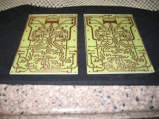

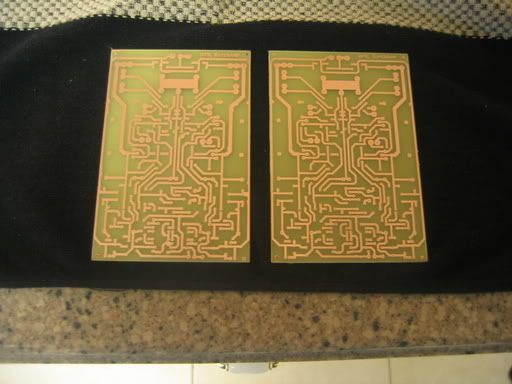

Well I made the PCBs. I used the Press-n-Peel sheets. I made a few mistakes. I'll share for those who are thinking of doing this.
First, I cut the boards to the exact size before I ironed on the sheets. This particualar design has traces running right along the sides. I found it really hard to get the trace to stick to the edge like that. I will trim the board to size after I etch it next time.
Second, I didn't get the iron hot enough the first time and so a lot of traces didn't stick. I had to scrub it off redo it with a new sheet.
On the second go around, most all of the traces stuck but there were a few that didn't. I went to Radio Shack and bought a trace pen and filled in the bare spots. That worke fine. The etchant didn't penetrate it.
Then, I didn't read enough about using the Ferric Chloride. I didn't realize it should be heated and that it needed to be agitated. After about 20 minutes I decided I had better look it up. So, I put a flood lamp over it and began rocking the glass tray I was using and finally began to see results.
Here are some pictures of the finished boards. Well, finished being etched. Obviously I still have a lot to do. 😀

Congrats Terry. They look great. Drilling is the fun part...

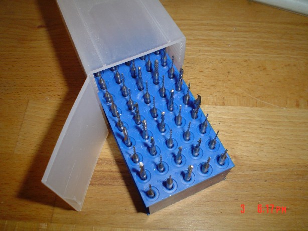

Now I have to find some really small drill bits. Any sources?
Thanks, Terry

About the drill bits... I looked for a while. Grizzly Industrial has sets of "wire gauge bits", but they are 6" long (for aircraft use). Seemed like they would be too long and be hard to keep from flexing. http://www.grizzly.com/products/item.cfm?itemnumber=G9752&
Then I found these at DigiKey:
http://www.digikey.com/scripts/DkSearch/dksus.dll?Criteria?Ref=44853&Site=US&Cat=32244229
Then, I was poking around on a web site that AceNov posted, and found this set, which is probably what I would get (the DS-100 set):
http://www.oselectronics.com/ose_p56.htm
Will be ordering them myself in the next few days.

Another source for drill bits is www.drillbitcity.com. They sell re-sharpened carbide drills in sets that have a useful selection of sizes. The prices are reasonable and the service very good.

Overhere a set of drills like on the picture is sold for around $10 on the web.
I checked each one with a magnifiying glass first time i bought a set, the tips looked as good as new.
I use them on a dremel style drilling machine in a stand on a powersupply with speed control, i am almost enjoying to drill holes.
