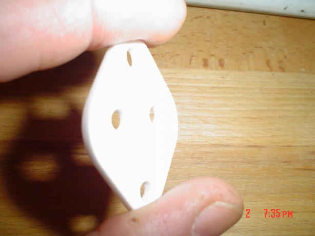

TO3's have two legs, and 1 connection to the casing.
As they are mounted on a heatsink, both legs need to go through the heatsink plus two bolts to tighten the TO3 to the heatsink.
Without a socket you will need to isolate both the bolts and the two legs with isolating washers/nipples with varying diameter.
TO3 is something like 0.160 " for the bolt holes , TO3 legs
are 0.063 " thick.
The socket combines all washers/nipples on one plate and is mounted from the other side of the heatsink.
The sockets come in two models ; with or without soldering extensions.
The first mentioned can be thin, the latter has up to 0.2 " thickness.
If you want the experts and a view on a socket, take a look :
www.fischerelectronics.de
For a story on different cooling material, their merits and downsides, and some info on un-even pressure effects read the man himself : Rod Elliot.
He had a tech article on his ESP site about transistor mounting.
Those that like to see a TO3 AluminiumOxide(Al2O3) isolator have a peak at the pic below.
If anyone desires to know what i used them for, and how much heat you would be looking at, he can always ask me.
