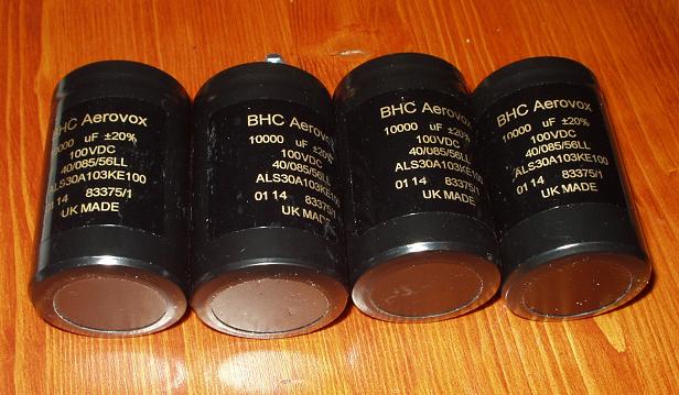

80V caps are just a bit skinny for a 77V PS. Take a look at the surge rating. Can't be too careful. Caps make a loud noise when they blow. You don't get to see the magic smoke, just lots of white stuff all over everything.

Overhere the minimal margin is 15% over Vdc, for 77 Vdc the caps need to be at least 90 Volt types.
The power company in Holland is allowed to have a margin of
+10 % on the nominal 230 Volt.
5 % is added for the increase in voltage of the transformer without a load.
That is the absolute bare minimum, taking in account that simultaneous power surge and zero load is unlikely and caps have a safety margin.
The data of your transformer states 63.5 Vdc at zero load, that is already nearly 90 Vdc.
If the voltage wandwidth of your local power company is 10 % too the minimum you will need for that transformer are 100 Volt capacitors.
Often enough power companies accidentally go beyond the 10 percent margin, so many would go for even higher than 100 Volt types.

still4given said:..Mine should be around 77V if I did the math right. Good thing about it, is that I have a bunch of new 80V 15000uf caps that I would like to use for the PSU......
Capacitors for the Leach Superamp should be rated 100V. In the picture below are the capacitors I'm intending to use for my Superamp project.😎
Milan
